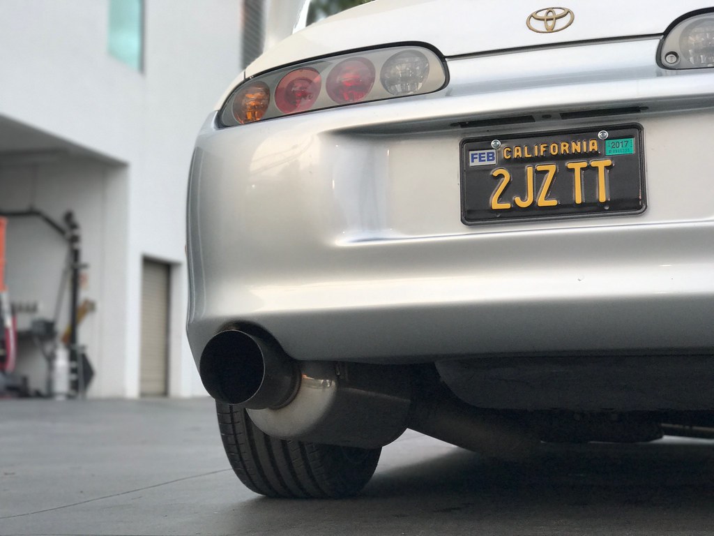

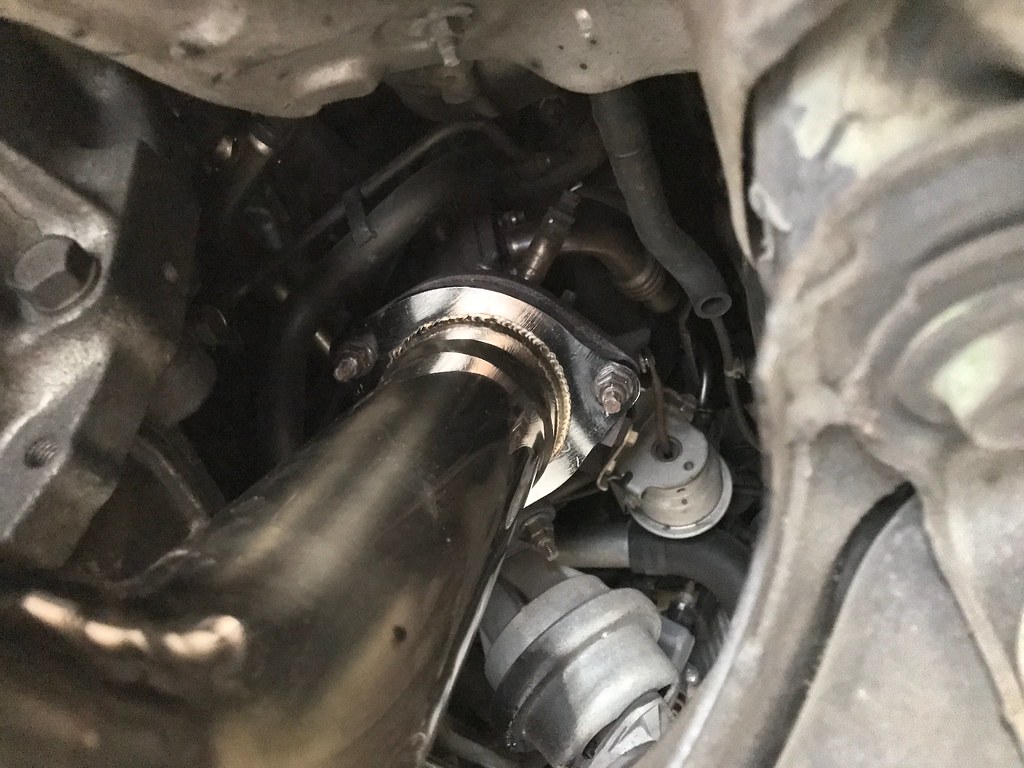

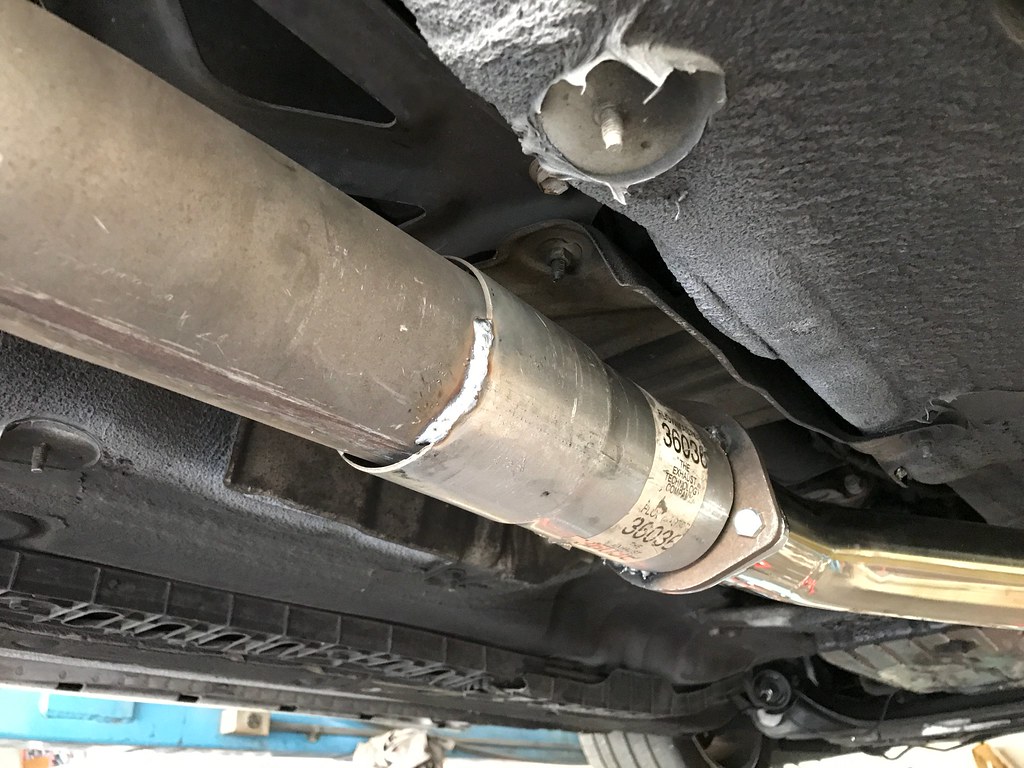

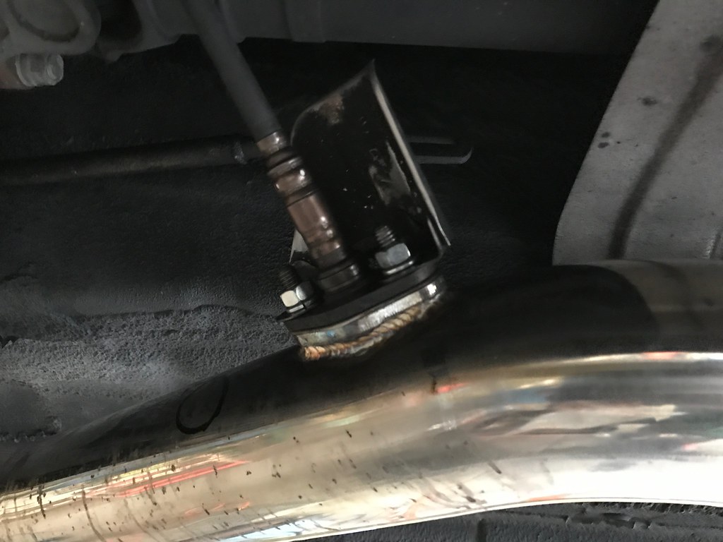

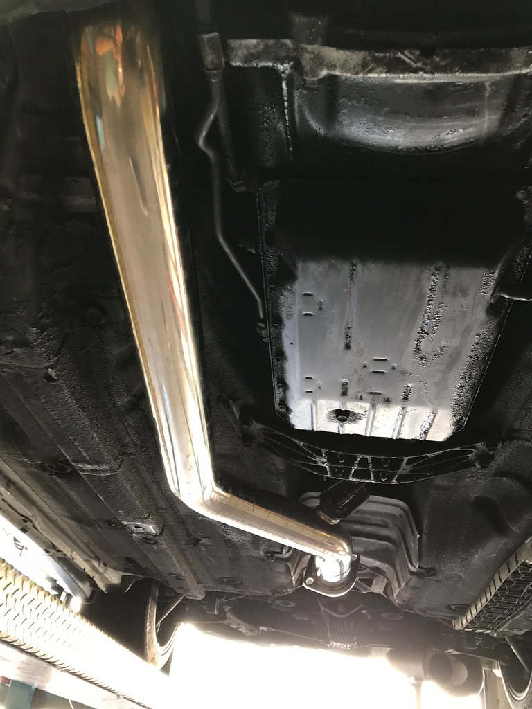

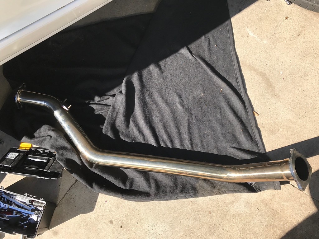

One thing that was getting on my nerves was the downpipe. Every speed bump, every time, it hits. I eyed a Megan downpipe on craigslist for a while until the ad went down.
A couple weeks later, someone else posts the exact same pipe up for sale. The guy had it in his Supra for a couple miles and took it back out.

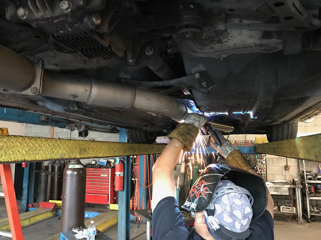

$100 and no more BS sounds good to me. I took it over to an exhaust shop to have them weld a new section plus a flange for the HKS Super Drager catback to bolt right up to the downpipe. They also welded in my O2 sensor bung for the wideband, so that's finally functional now.

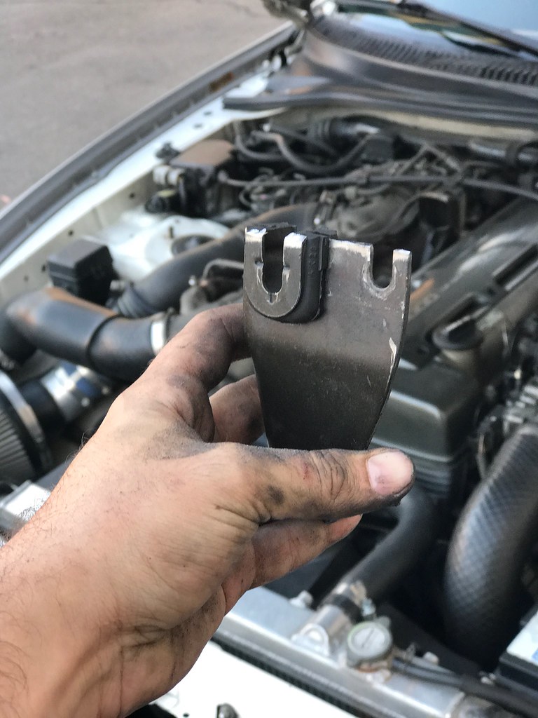

The strut bar was contacting the throttle cable bracket, thus I removed it and trimmed a bit off the top.

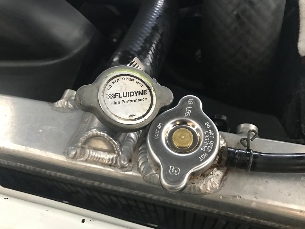

The old Fluidyne cap has seen better days. It's been starting to leak from the rubber seal, so time for a new cap. Stant 10233 16lb caps are recommended by Fluidyne.

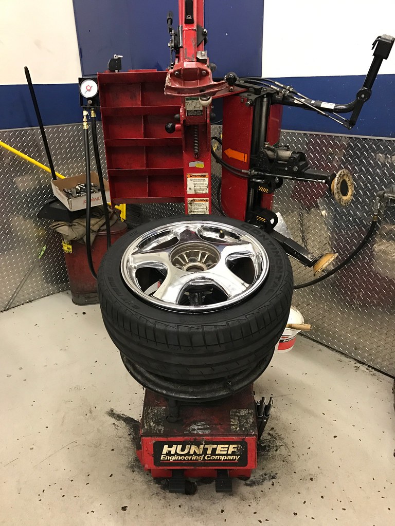

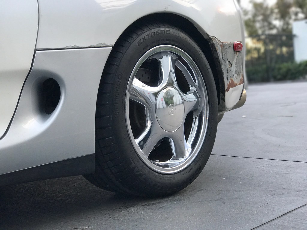

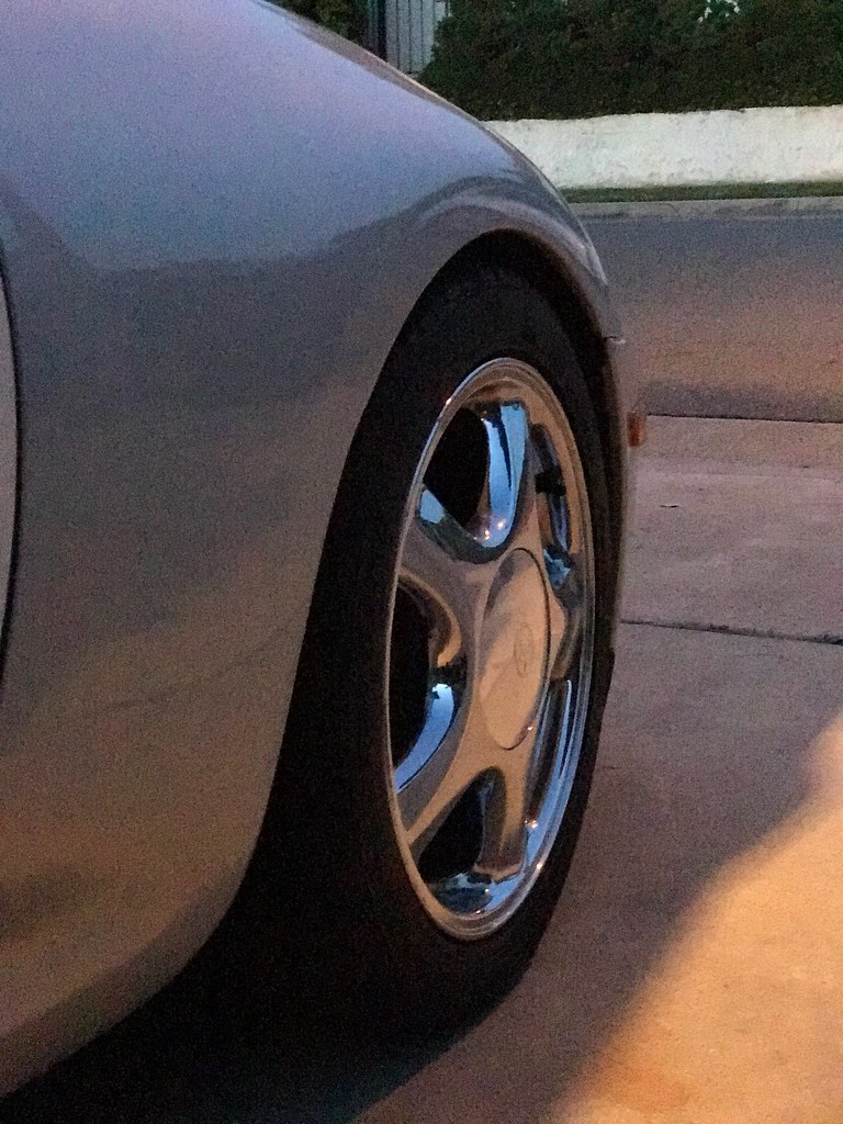

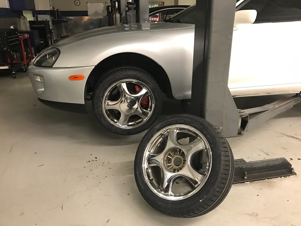

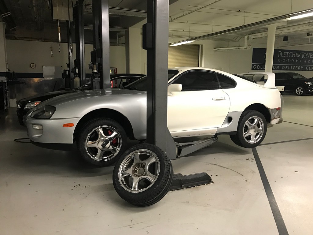

Continental decided to discontinue the tires I have, the ExtremeContact DW, which means all old inventory went on sale. Good time to get some wider tires on the cheap!
Out with the old
and in with the new!
285/40/17

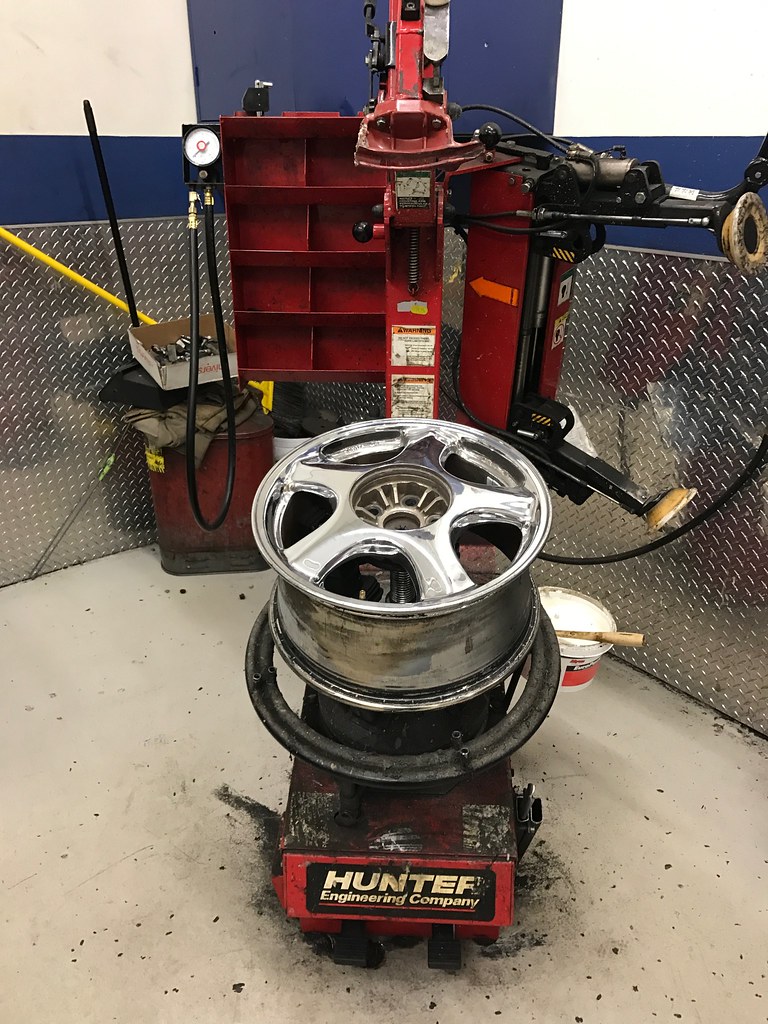

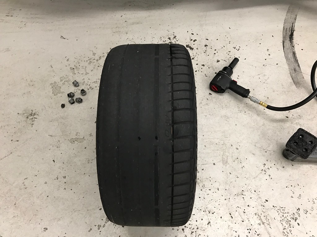

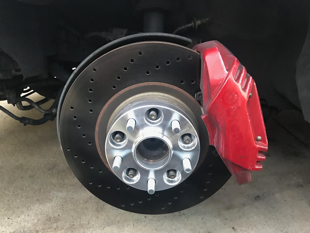

The front tires were good on tread, but considering how cheap the discontinued price is, I figured might as well get some new ones. I used part of the difference to get some 25mm spacers for the front. I went with 235/45/17 because testing 255's resulted in too much rubbing.
I learned how to do mounting and balancing myself using the equipment at work, to avoid having to pay the BS $20 a tire at America's Tire. Afterwards, I got the car aligned at a local shop.
The front looks astronomically better spaced out.

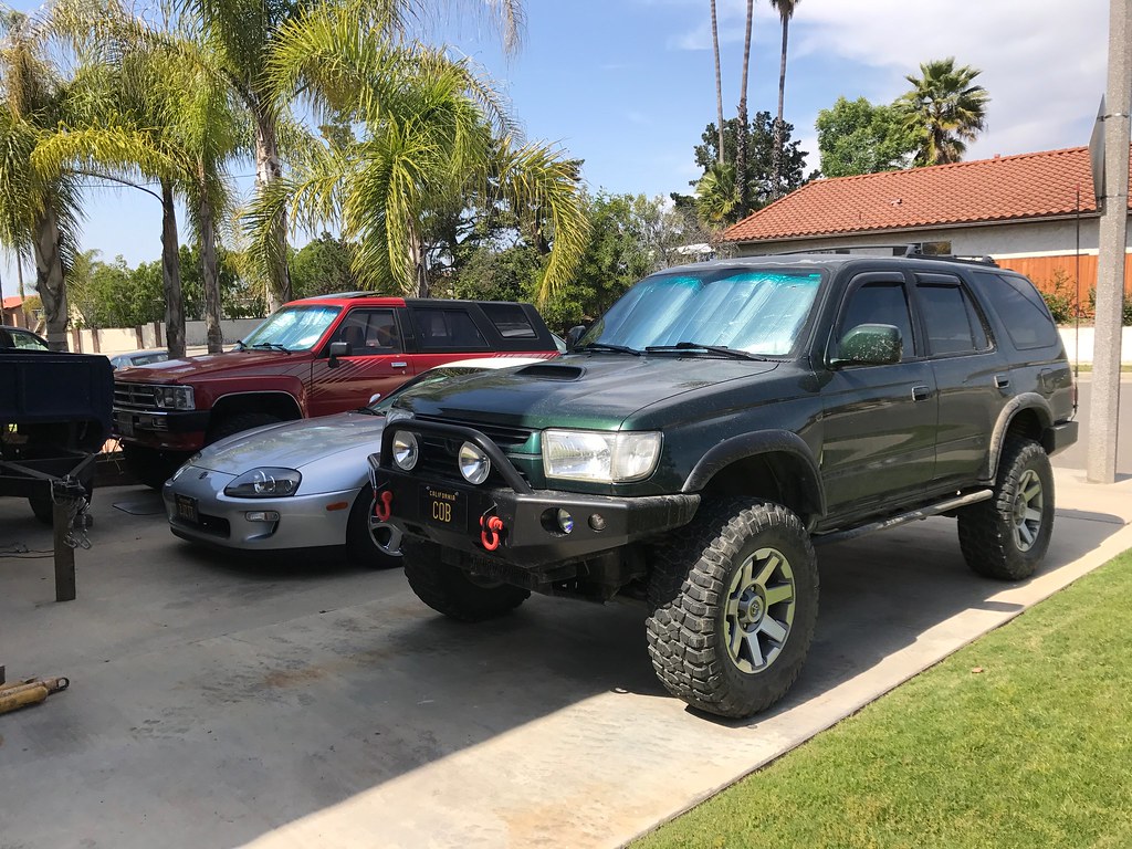

Great pictures! I really love the Supra.... wait, I love the classic 4R.... wait,I love the 3rd gen!! We have lots of RHD's here. Importing isn"t hard. Lots of Skylines and a few Supras... AND Hilux Surfs.
I wish we, in BC, had endless Summer like yourself--- I envy your ability to work in such a dry climate... shoving everything to the corner of the garage to get the vehicles in to work on them sucks, AND having to pre-heat the garage, also sucks!!
Interesting tidbit, I found out a couple of weeks ago, that Rickashay's old 4R is now owned by a co-worker!
poleclimber63-albums-progress...-picture44401-new-office-new-co-worker-nice-truck.jpg

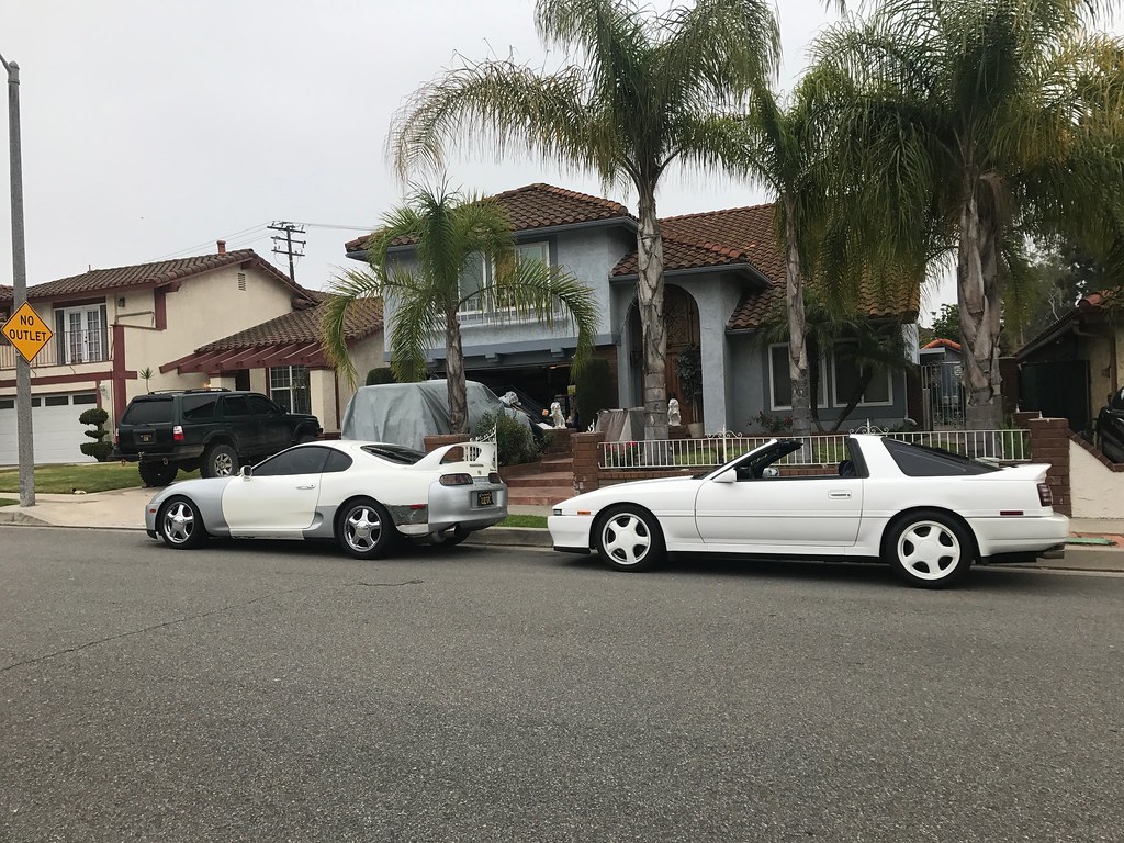

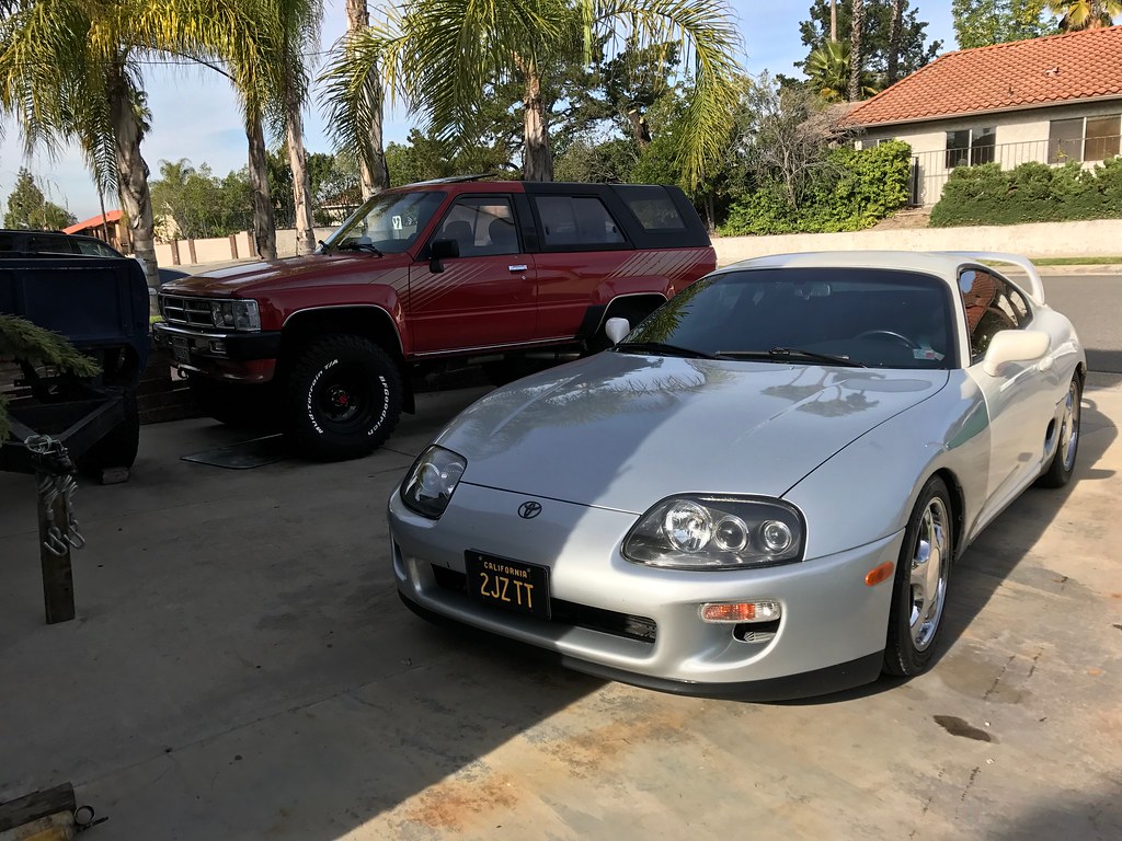

I thought I'd also provide a pic of my 4R from a couple of days ago when the sun came out briefly...

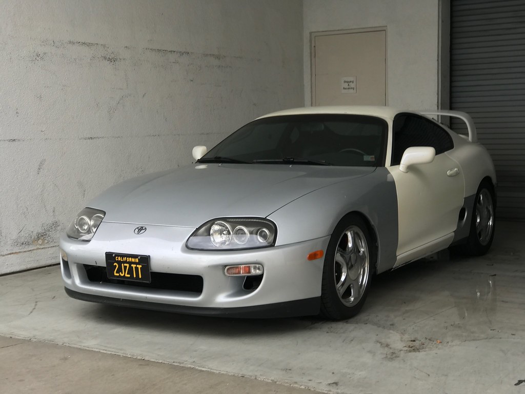

Just came across this thread. Nice find!! I'm surprised you were able to get that plate as well. I'd think in California someone would have already had it by now.

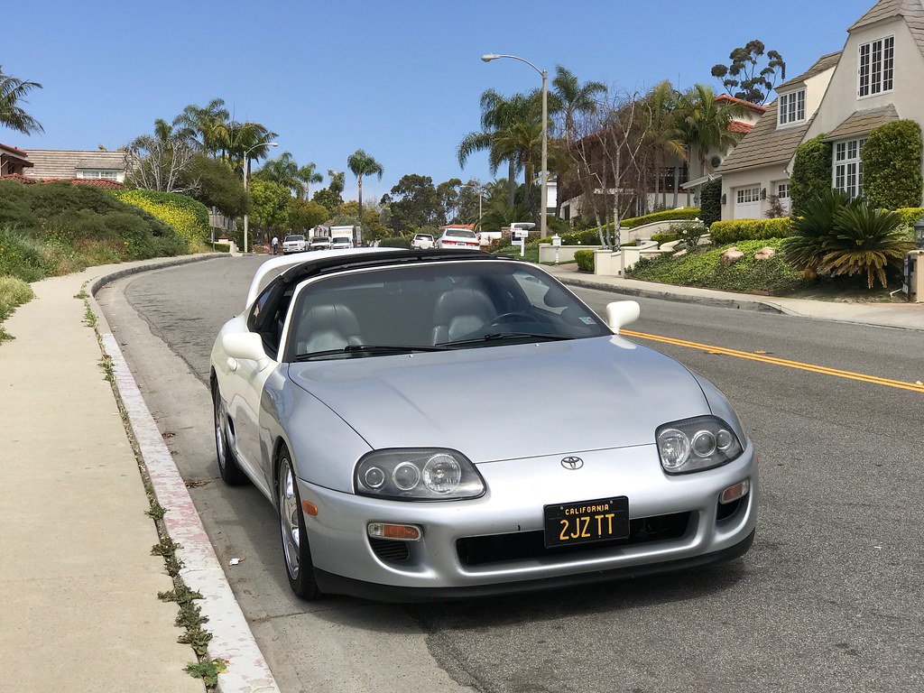

Thanks man, yeah, that was what I thought, too. Probably won't be there in a years time, though, because single turbo swap :)

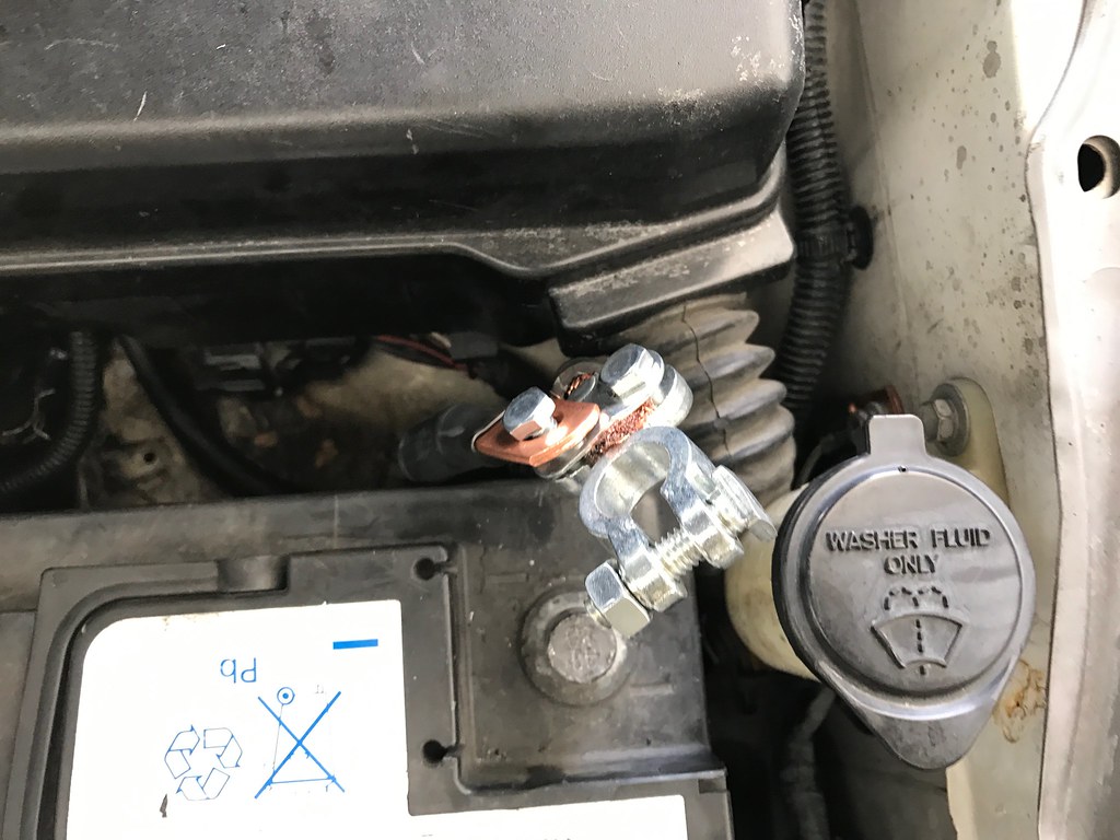

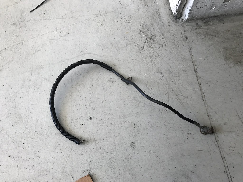

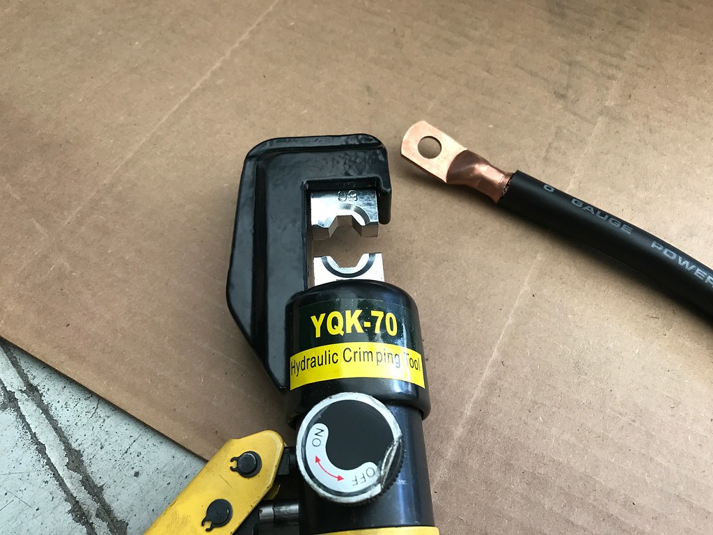

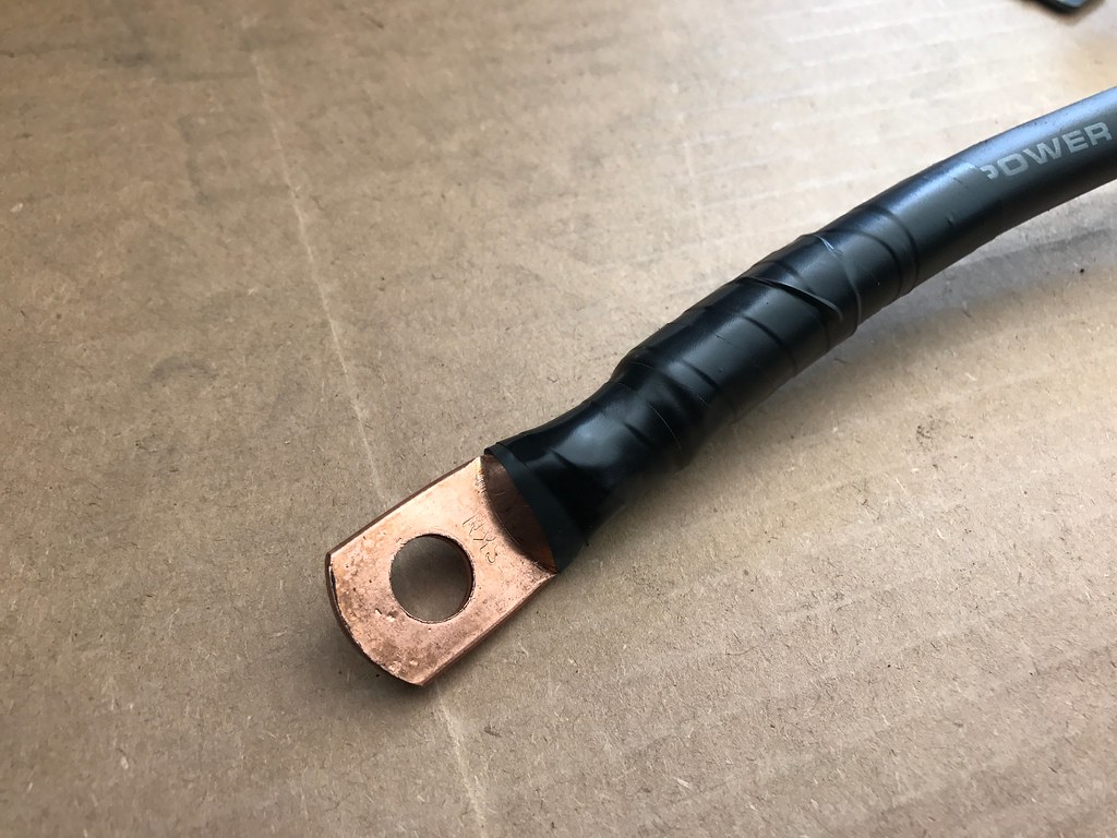

The car has been having some issues with the negative battery terminal. Poke around my garage and you'll find enough to keep you busy for weeks. The solution was 1/0 gauge wire and a new terminal.
Old cable and terminal:
1/0 gauge terminal attached via hydraulic crimper.
1/0 ground strap to chassis added. This isn't a permanent setup and I do eventually plan to relocate the main battery to the trunk alongside the spare wheel. It will be a different size battery (or two). It certainly works great in the meantime though.

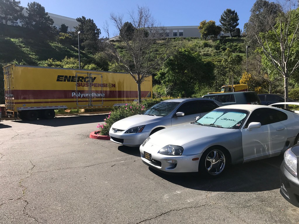

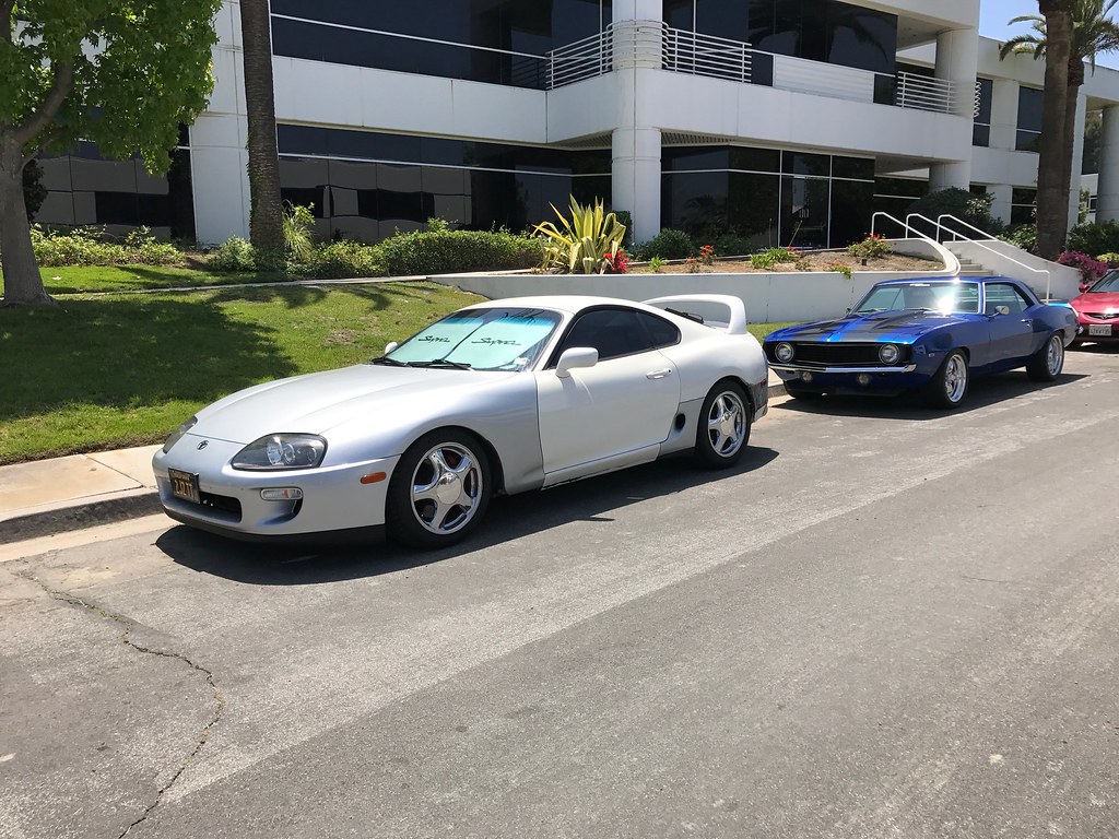

I found myself with a new job opportunity. I'm now Account Manager and tech support at Energy Suspension in San Clemente, CA.
Around San Clemente.

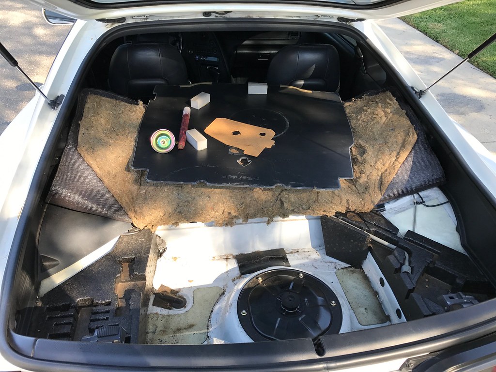

Pulled out the rear carpet to take a look around. Removed a lot of random previous owner trash, found some new spots to fit my mini air compressor, and located a missing part of the targa holder. Pretty stoked about that last part.

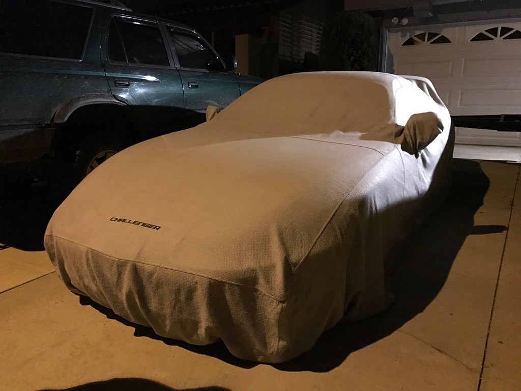

Custom Mishimoto cardboard.
Heh... Challenger. Those things are ****ing behemoths. The cover more than covers mine including the spoiler.

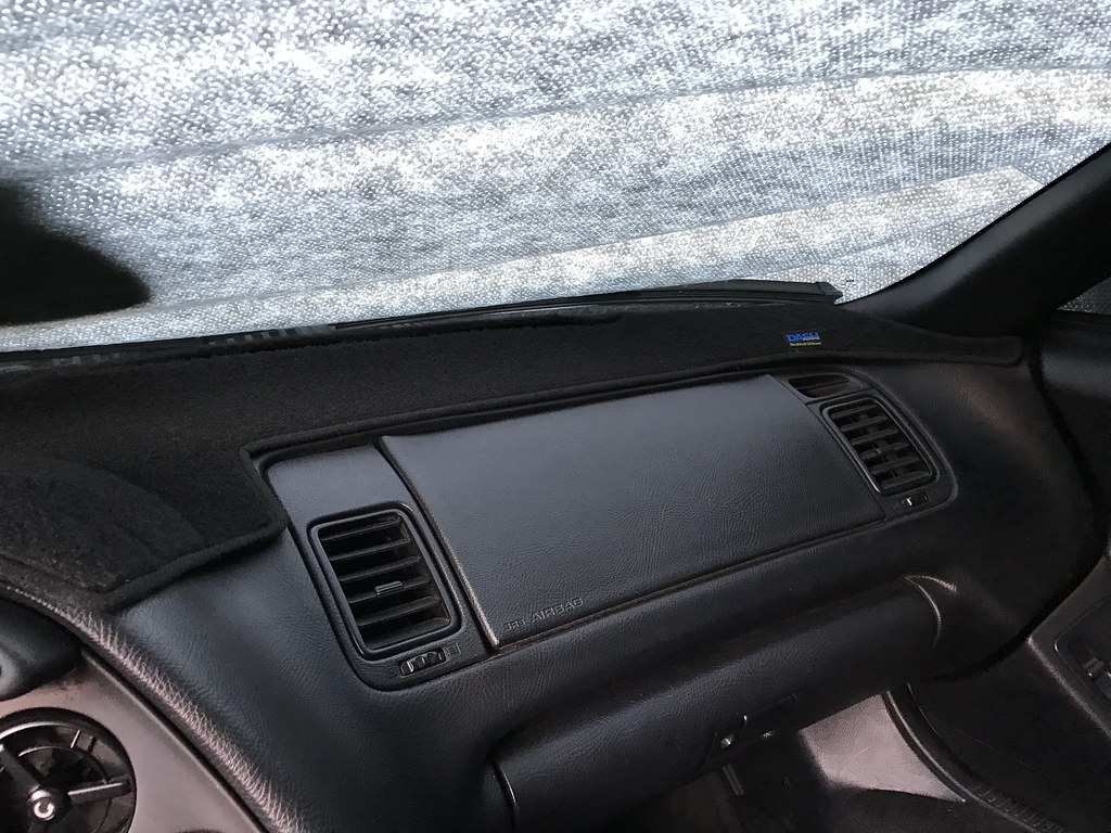

Dash designs dash cover.

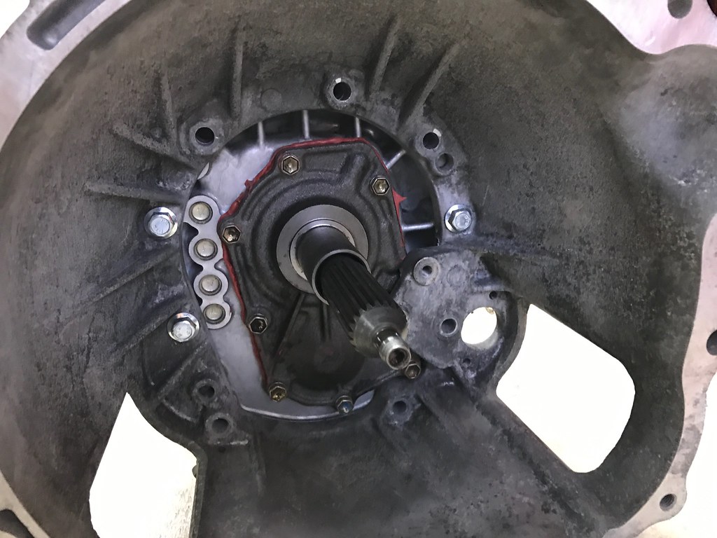

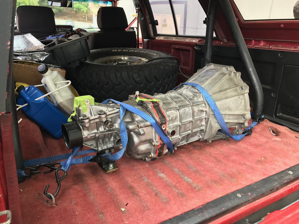

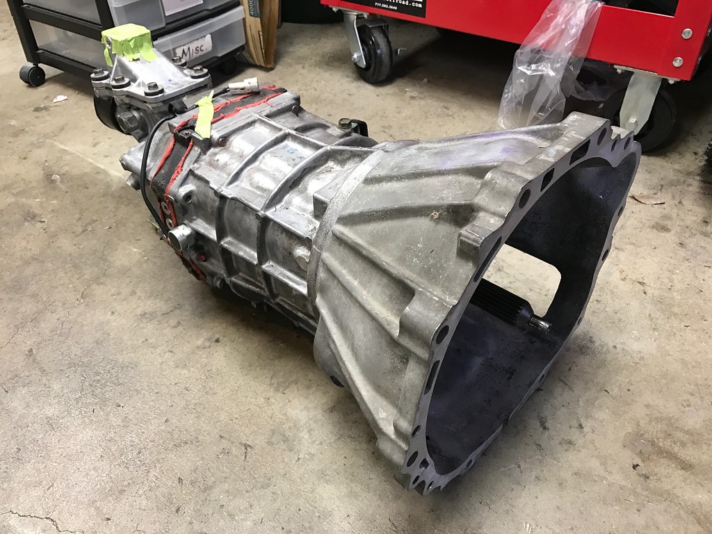

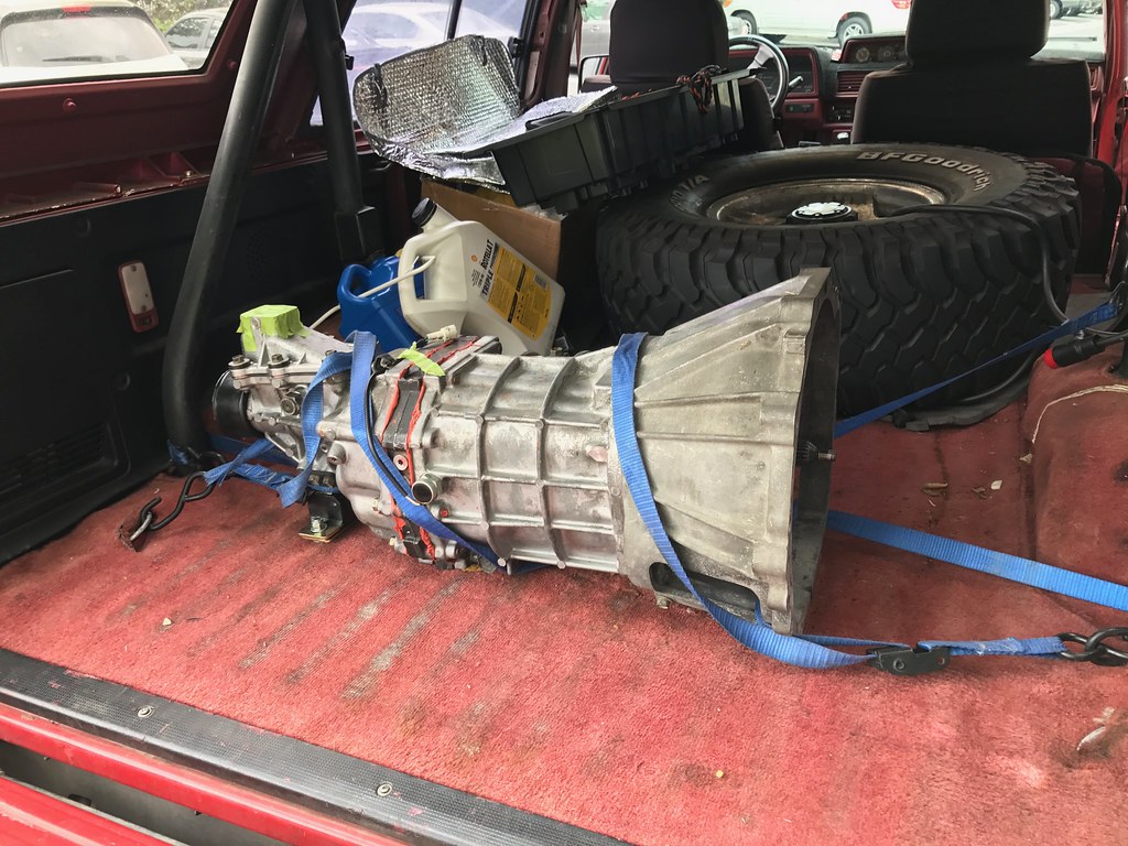

Back to the 5 speed swap. My plans to rebuild my R154 (the one in the garage) have been replaced, with this. I got this thing from a Lexus Tech who went another route with his project. I'll use my 1JZ bell and shifter extension on this one.
0 miles. R154 with marlin crawler upgrades.
Billet shift forks (all 3)
New KOYO bearings
New seals
New bearing retainer
Marlin Chromoly thrust washer
New driftmotion synchros
New shifter retainer housing, grommets, and gasket
New bell housing bolts
Input shaft like new
Energy Suspension polyurethane transmission mount from a Chevelle modified to fit R154

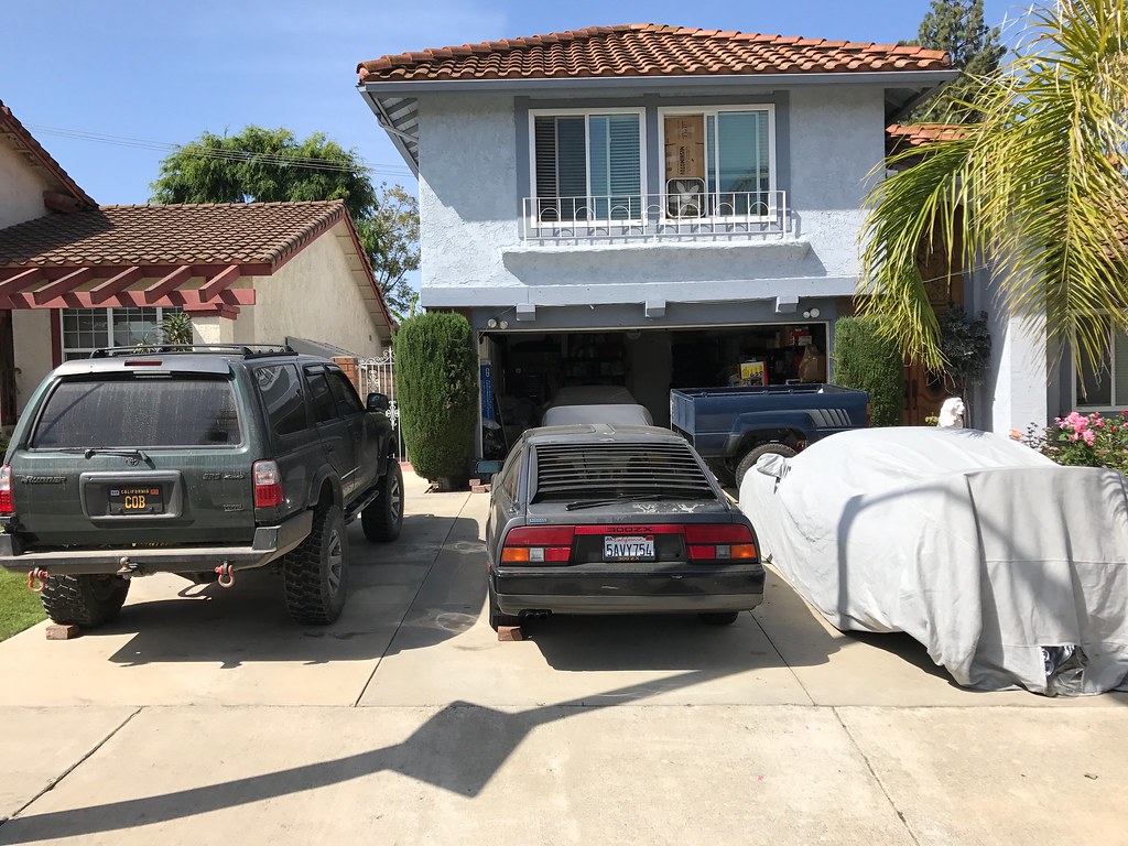

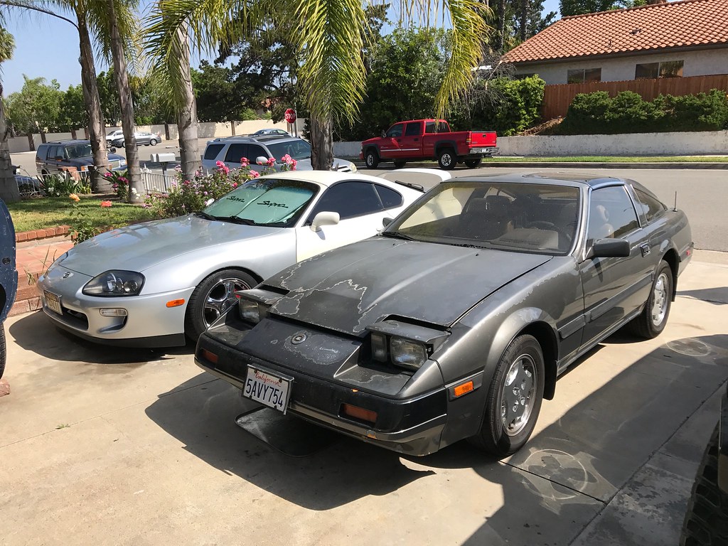

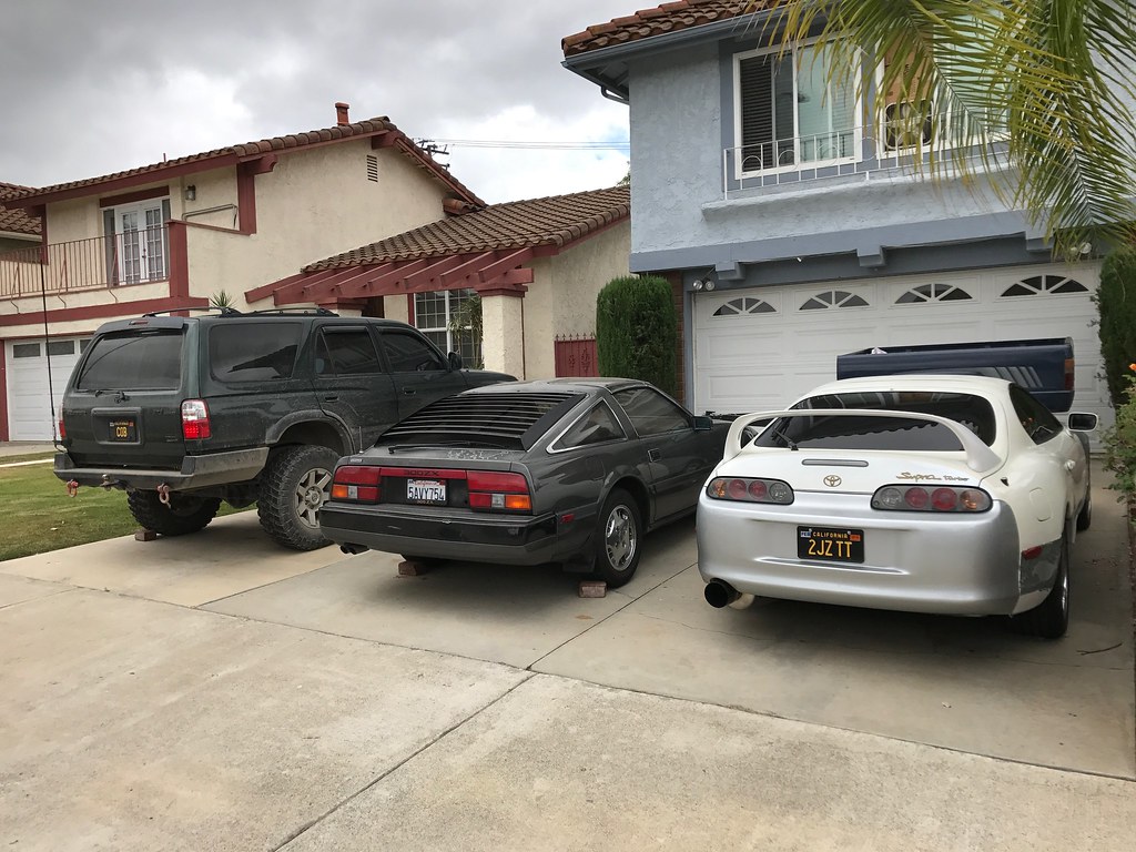

My latest acquisition, 1984 300ZX. It's not sticking around because I hate Nissans. I did get it for a steal, though.

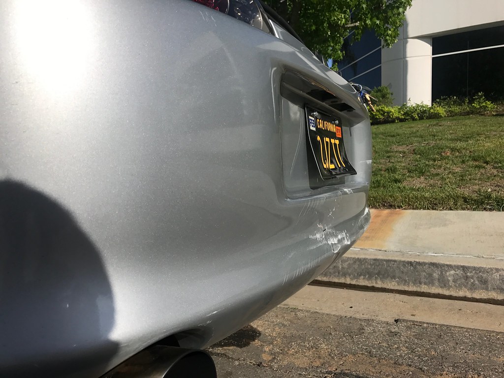

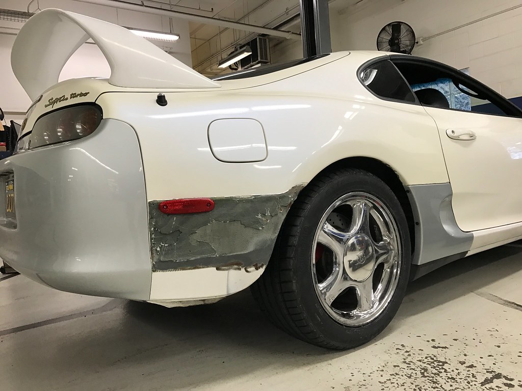

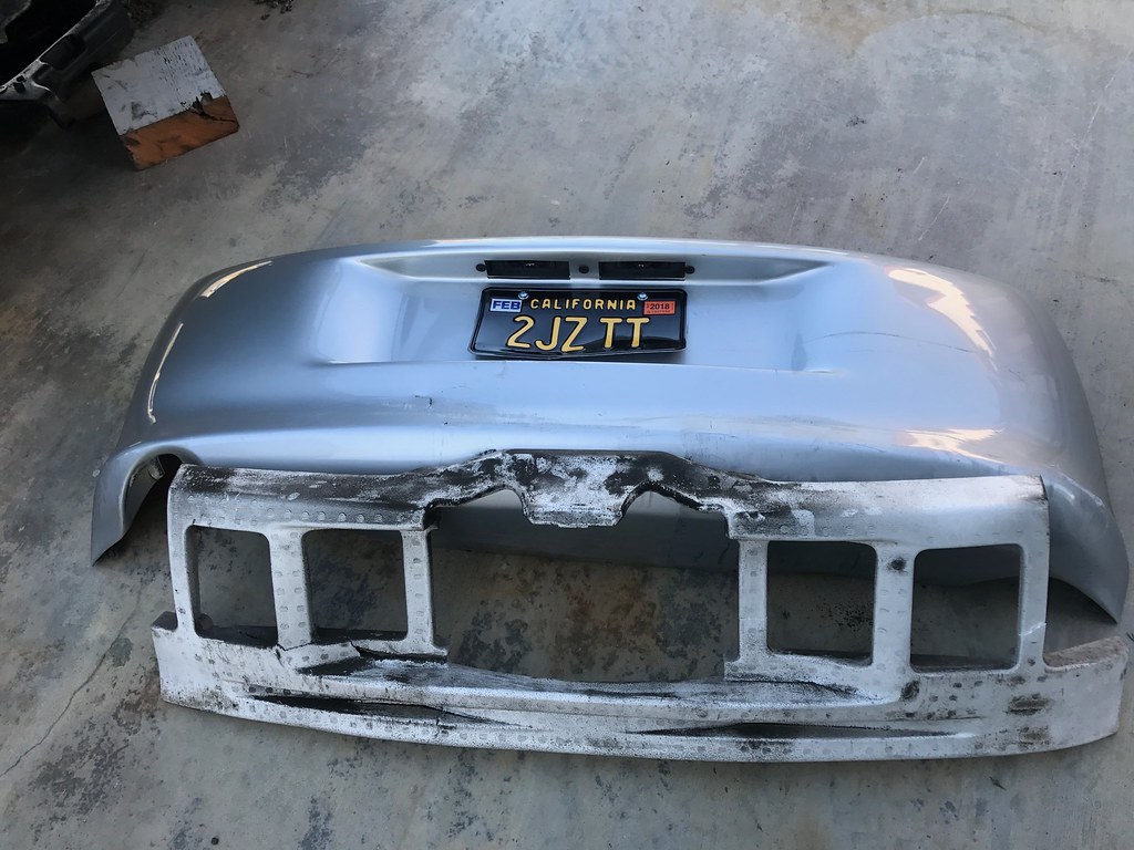

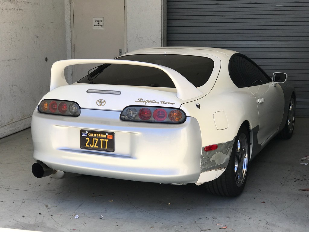

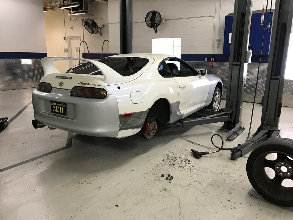

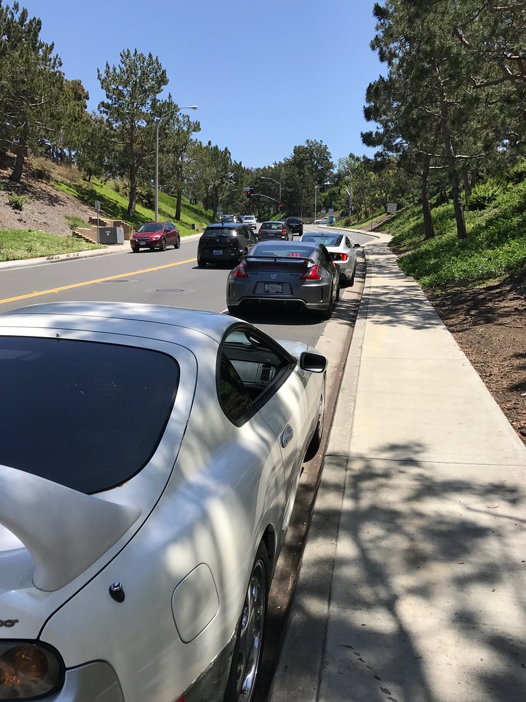

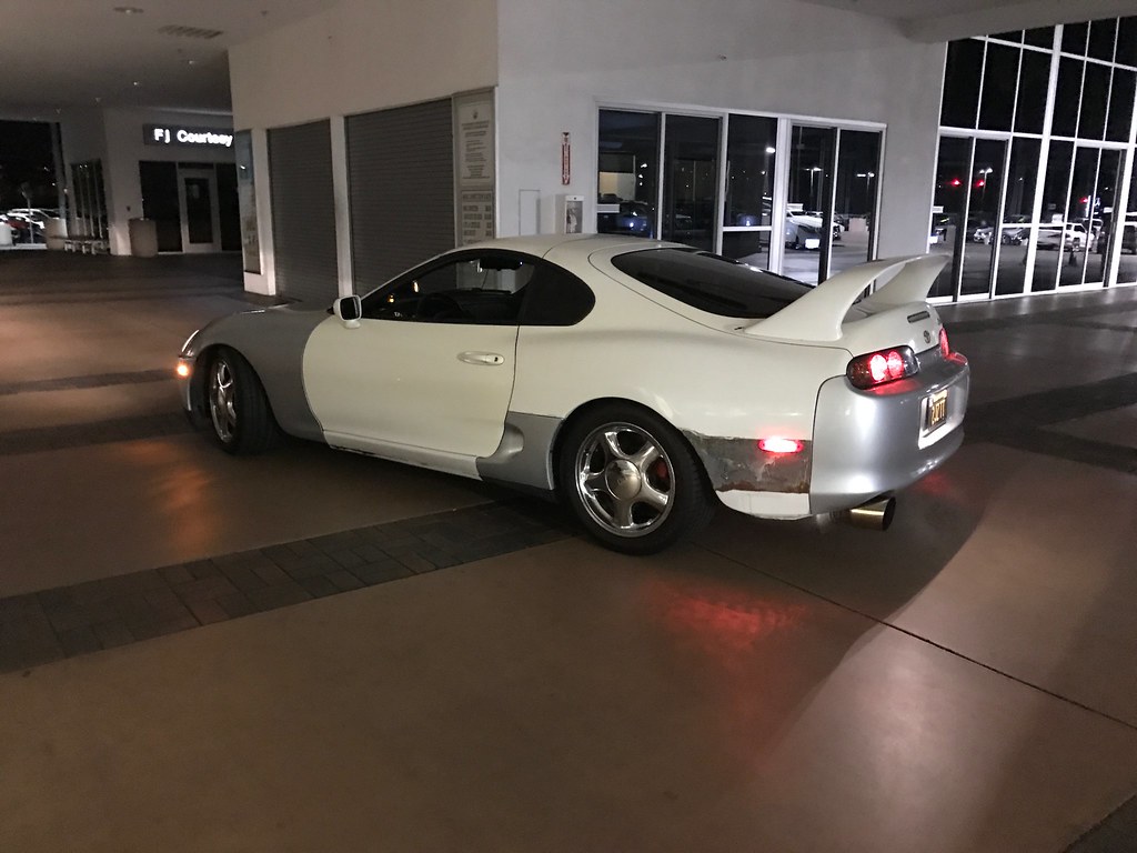

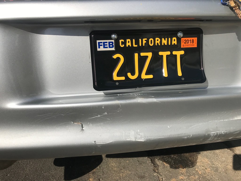

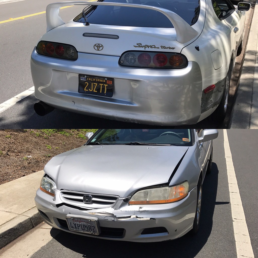

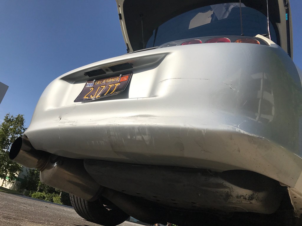

Lunch break! 17 year old girl defiles Supra! Breaks back of man and car!
Witnesses... a guy in a Mustang and another guy in a 370Z.

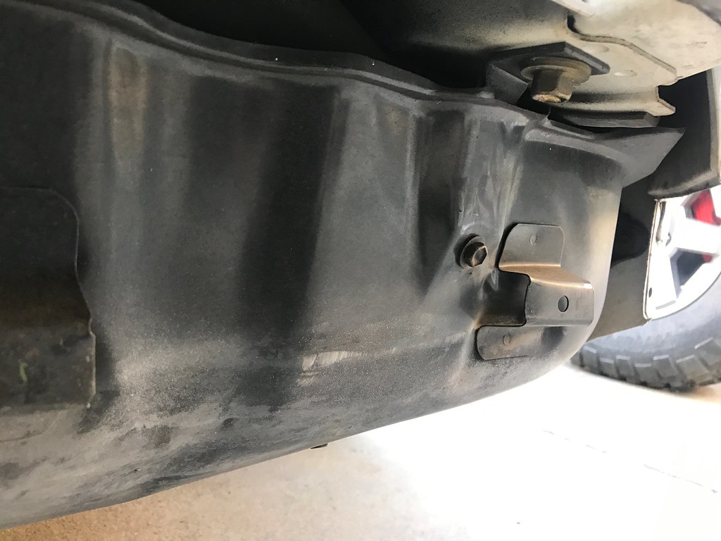

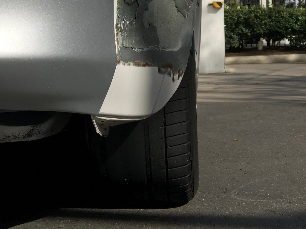

Gotta love that overspray on the tank skid.

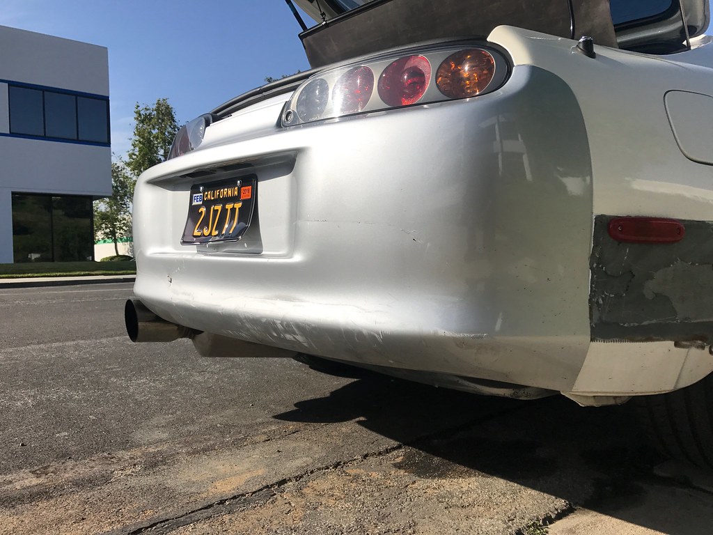

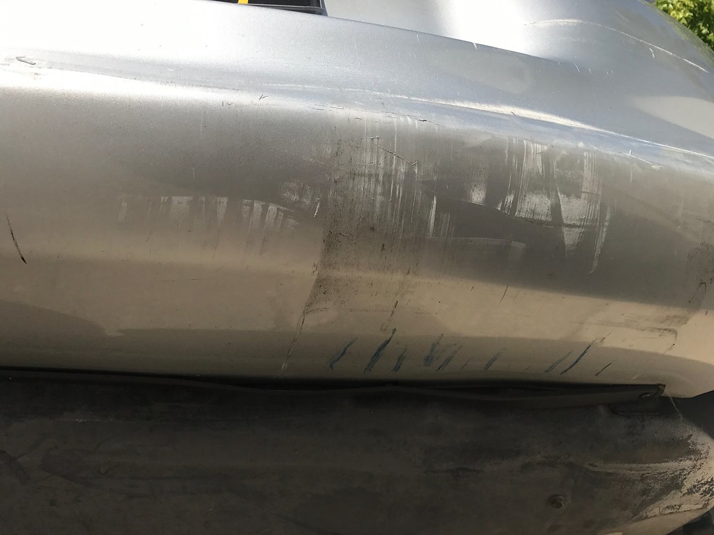

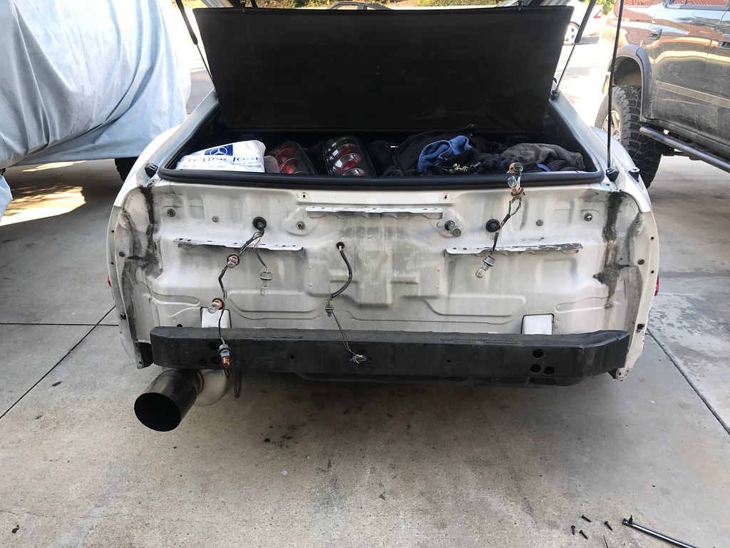

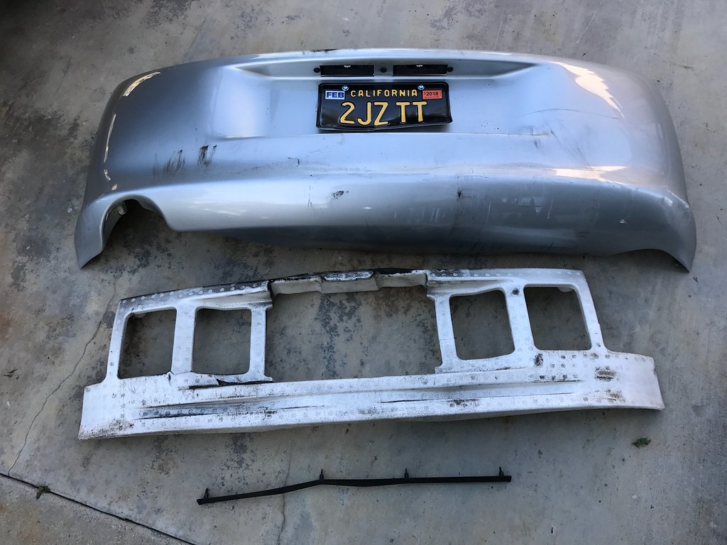

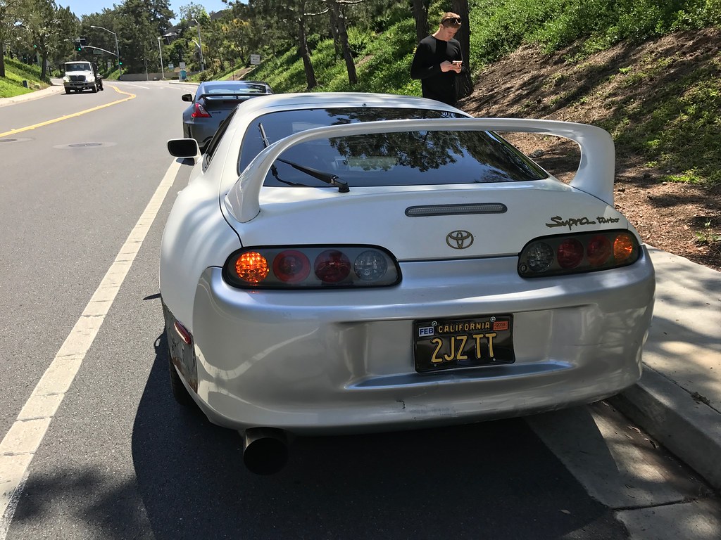

So much for that brand new rear bumper mounting bracket...
The impact even broke two filaments in my bulbs! I WANT COMPENSATION!!

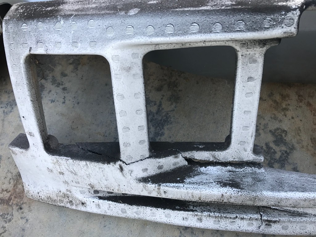

The foam behind the bumper is broken in a few spots.
Bend in the tank skid also.

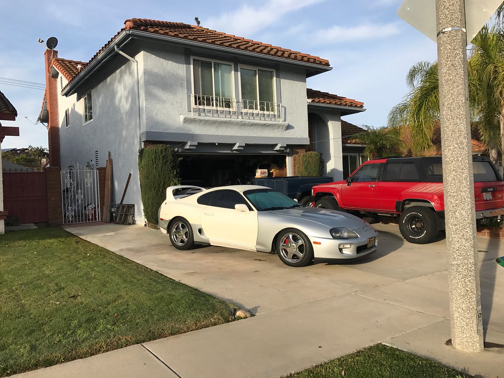

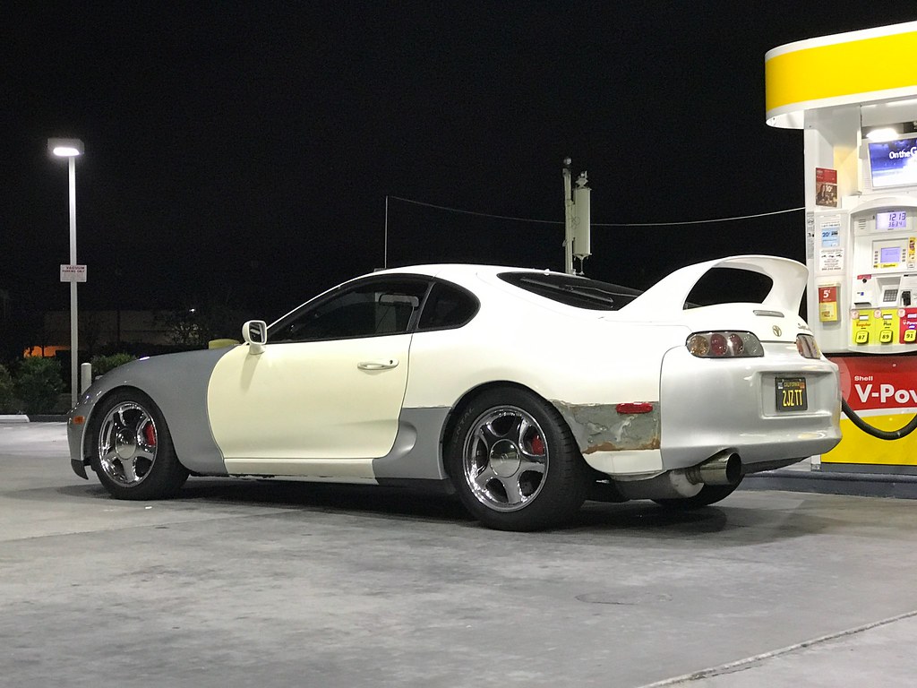

So, after the R154 swap and insurance comes through with a check, seems appropriate that this car gets repainted.
