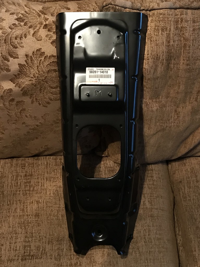

The majority of the R154 swap parts are in. The car is going to need a longer shifter extension than the one I already have, so that's about all that's left. I'm also thinking about ordering the OE shifter tunnel piece, along with a clock spring and a power steering pump.

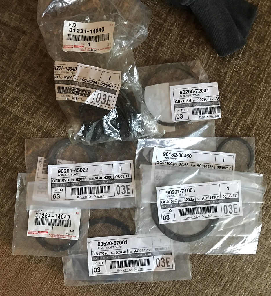

Hub assembly and rings for R154 pressure plate

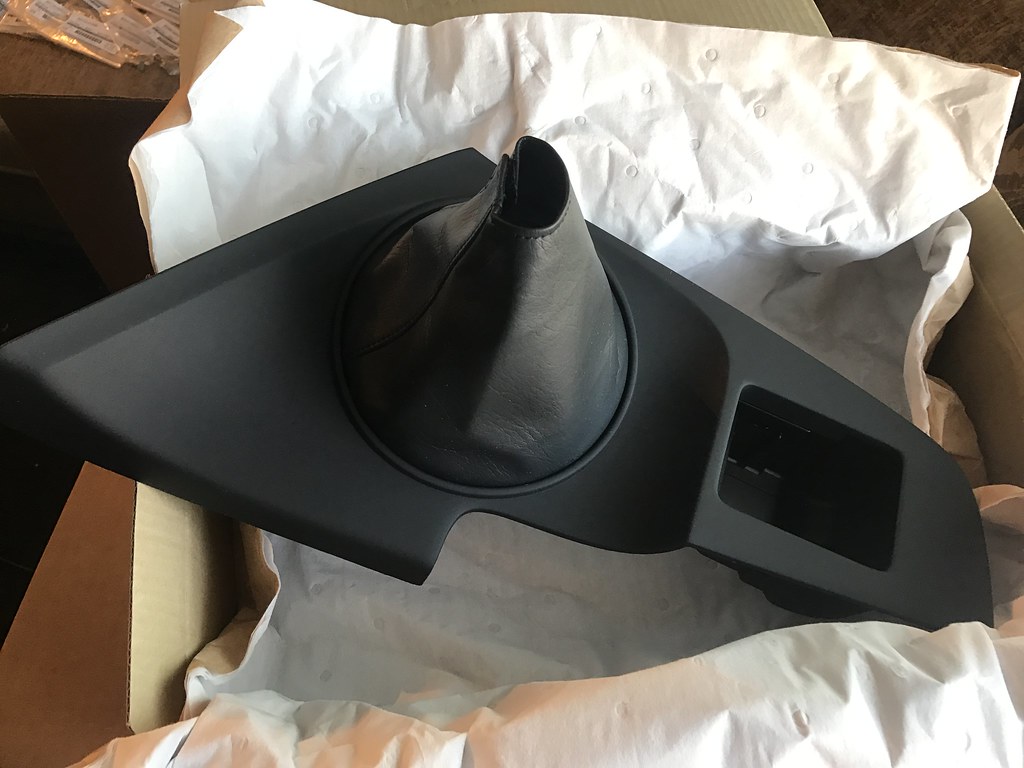

93-96 6spd console with boot

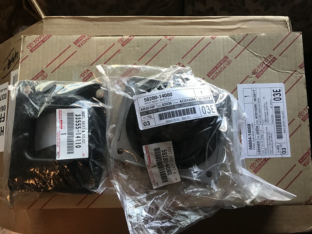

Rubber boots for shifter

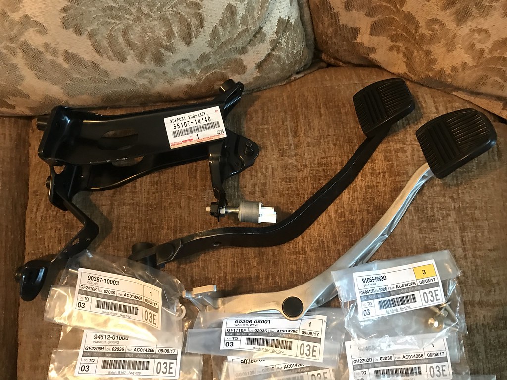

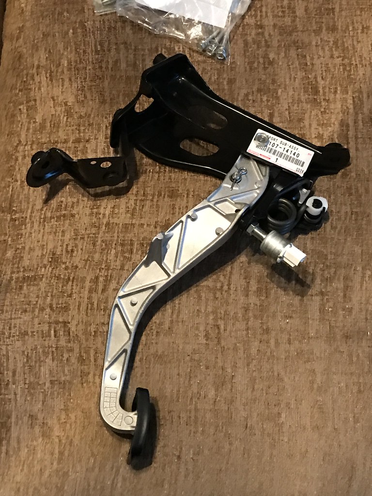

Clutch and brake pedals

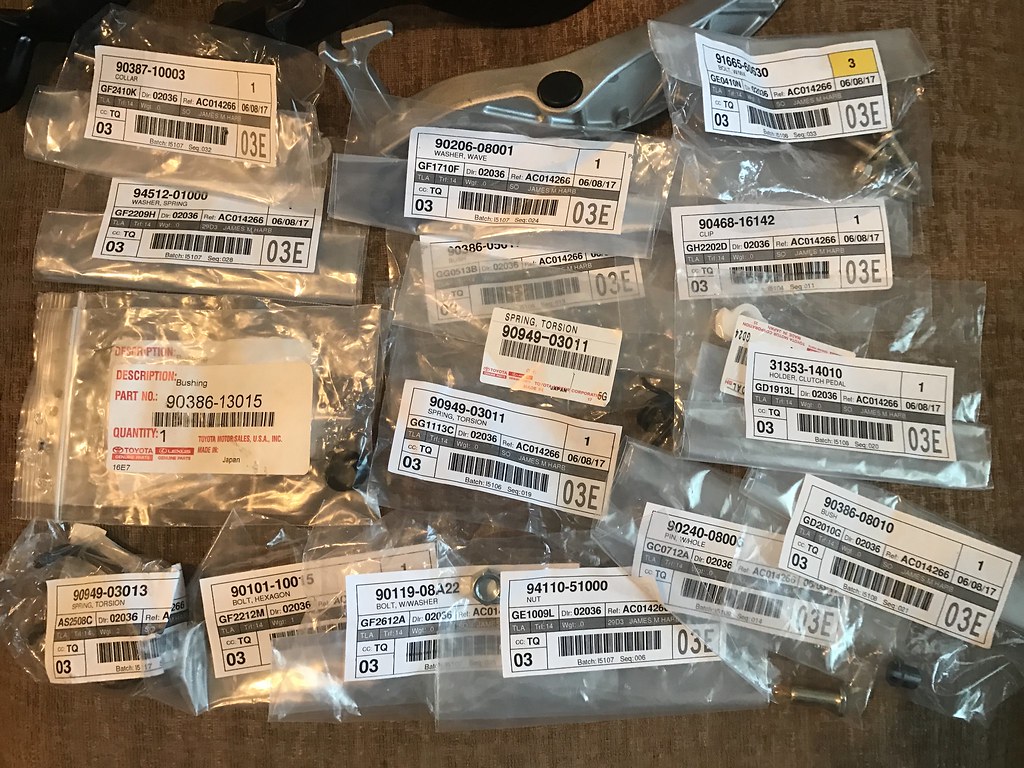

Parts for the clutch pedal assembly, excluding one E-clip, which was discontinued. Instead, I bought a pack of 300 E-clips for $6... :D

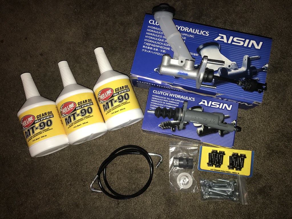

3qts Redline MT-90 gear oil
AISIN Clutch and slave cylinders, brand new
Full length stainless braided clutch line with black jacket

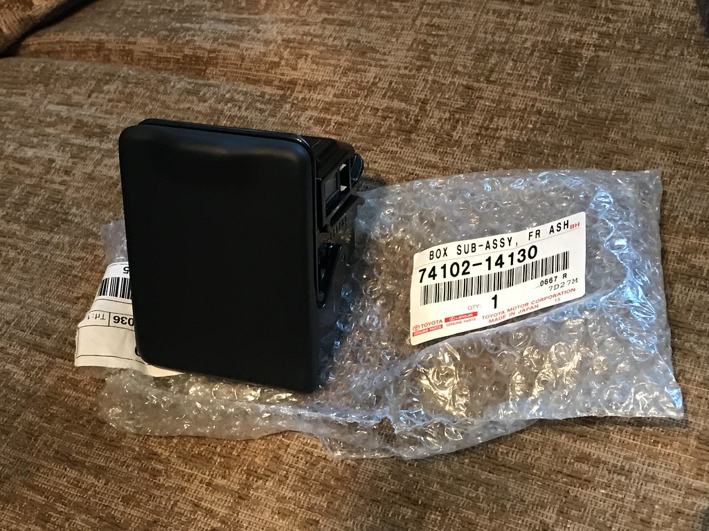

More new parts.

Clutch pedal assembled:

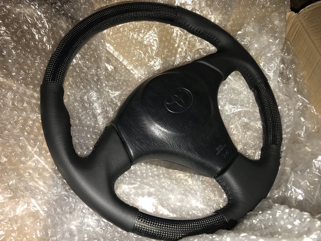

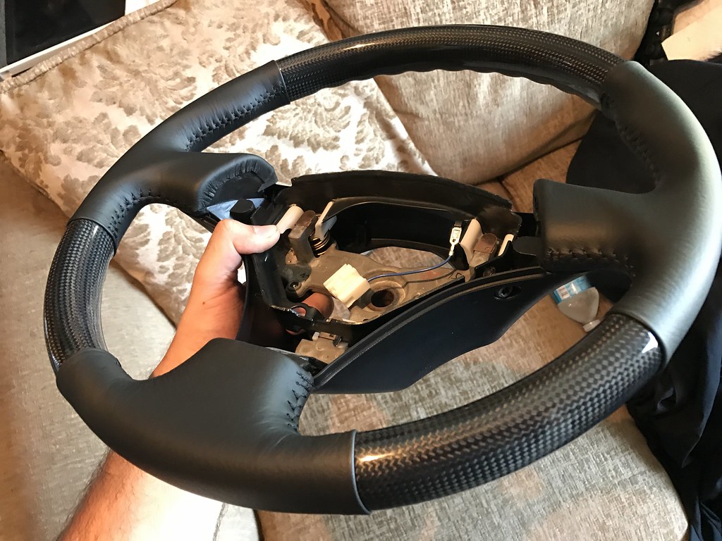

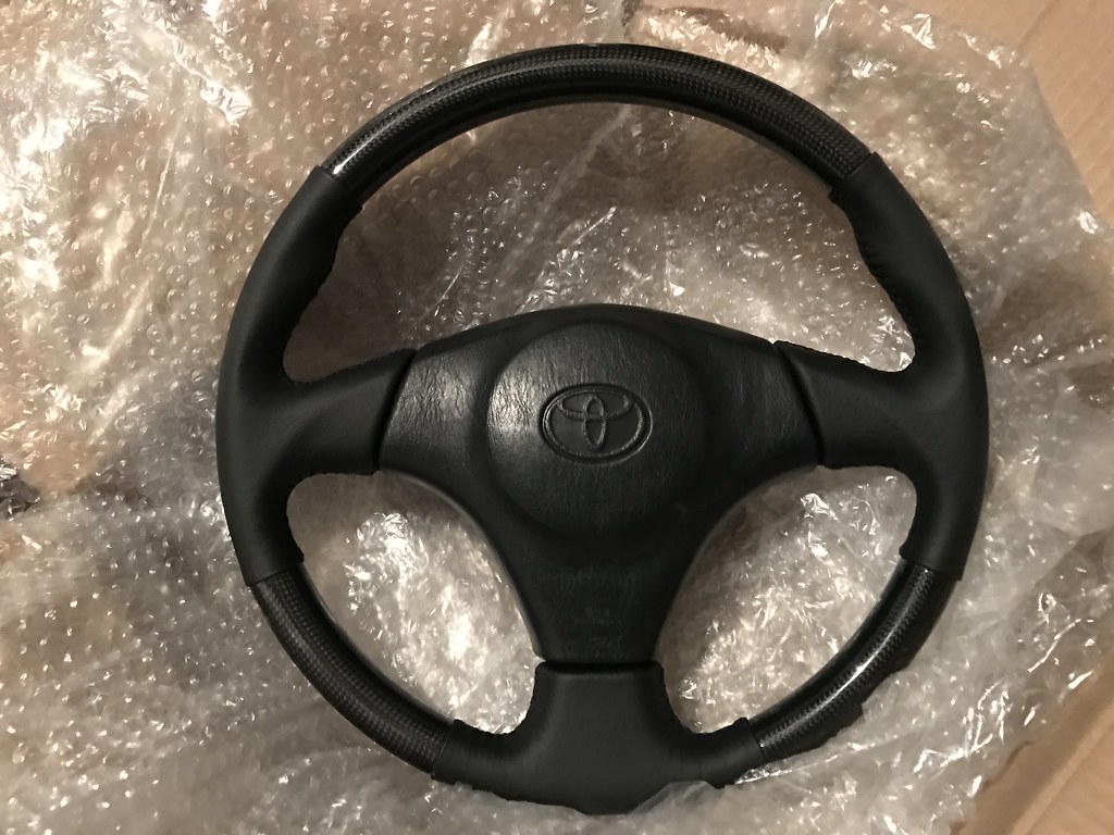

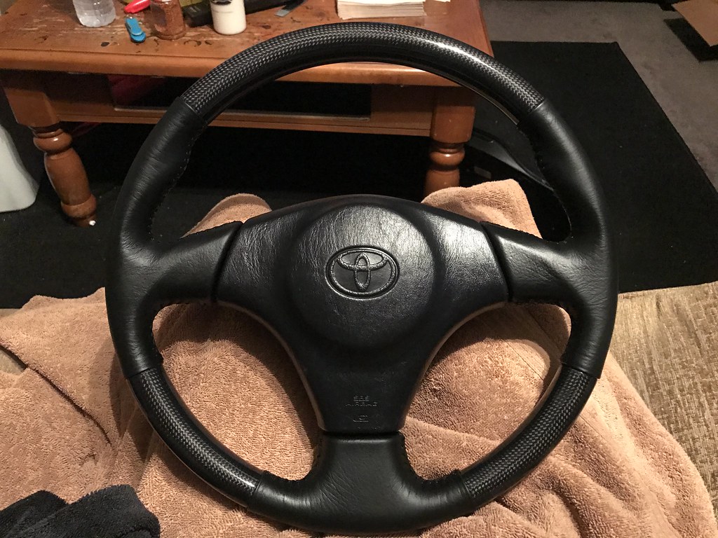

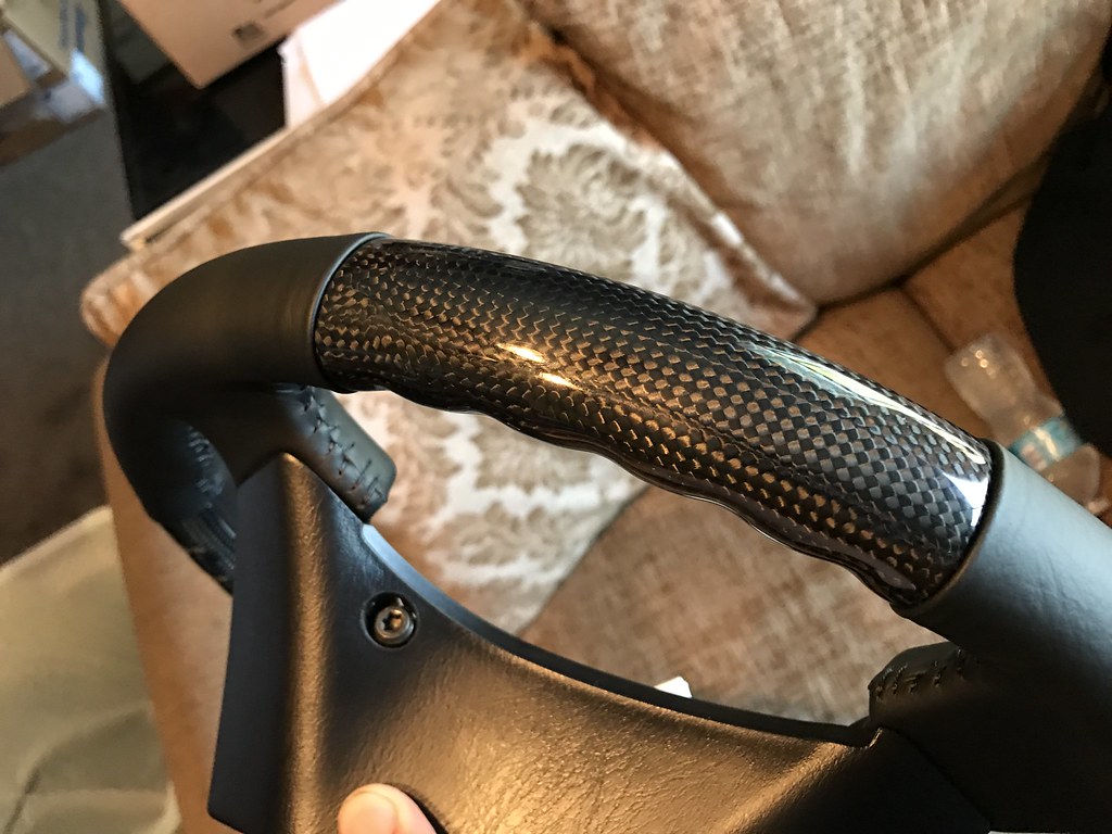

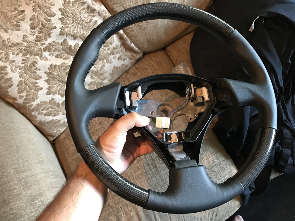

A very special item that will grace in the interior of a one day very nice looking MKIV. Brand new in the box. Also scored a good condition matching airbag. Picked up a regular 3 spoke also just to get the cruise control stalk, should I choose to use it.
Treated with Meguiar’s leather conditioner.

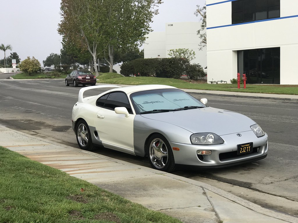

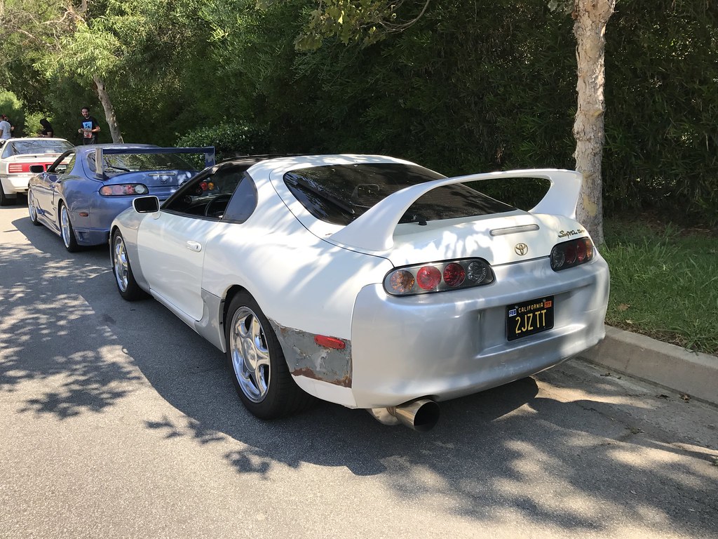

Milestone! She's still so virgin beneath all of the body issues.

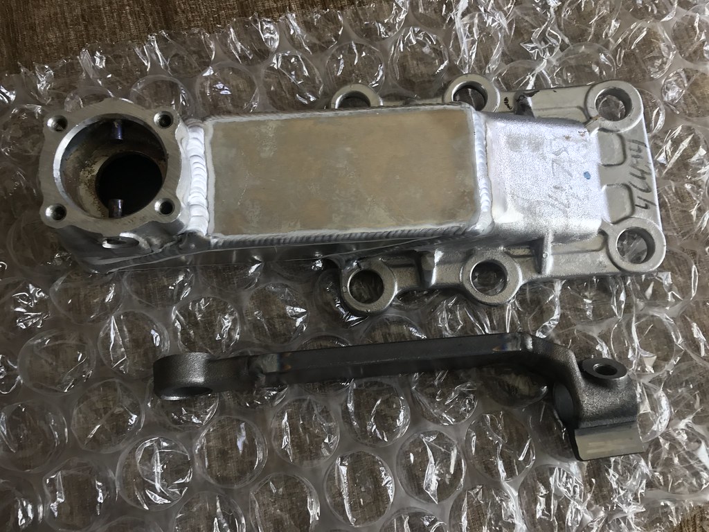

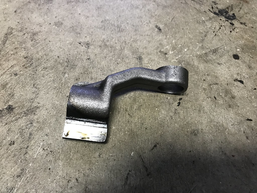

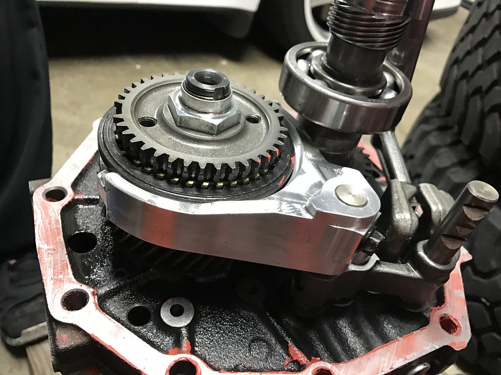

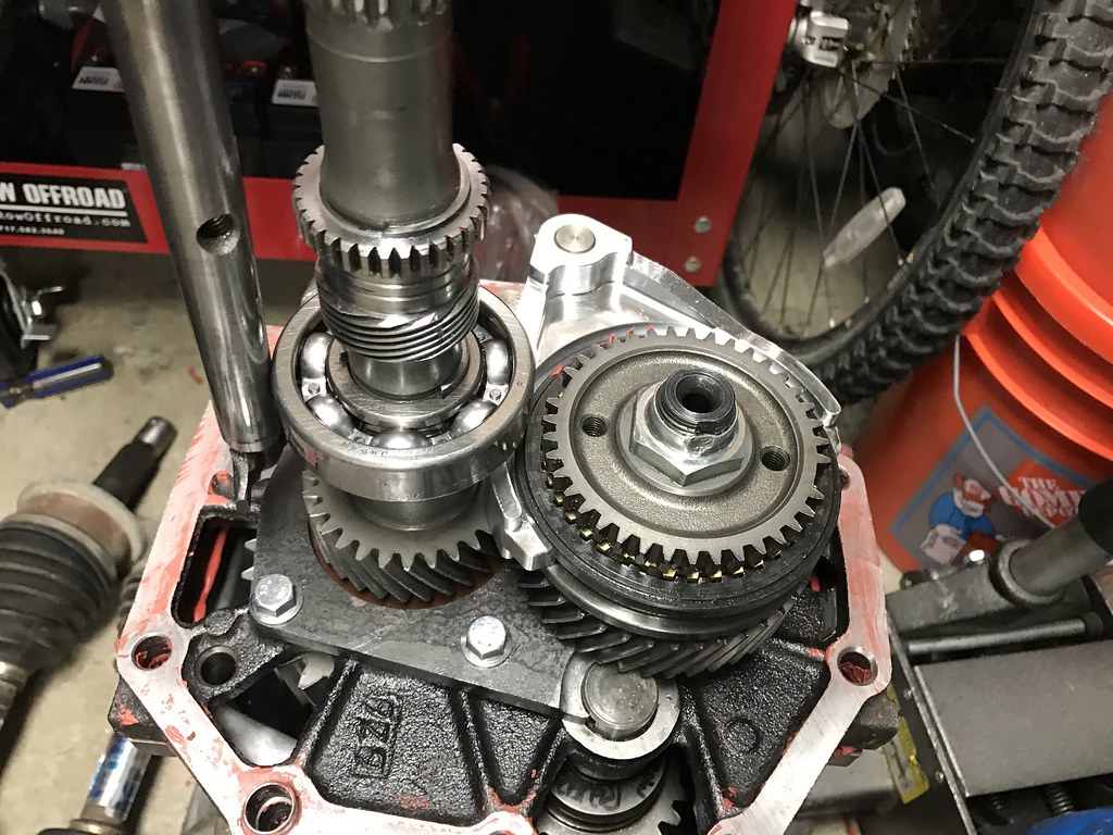

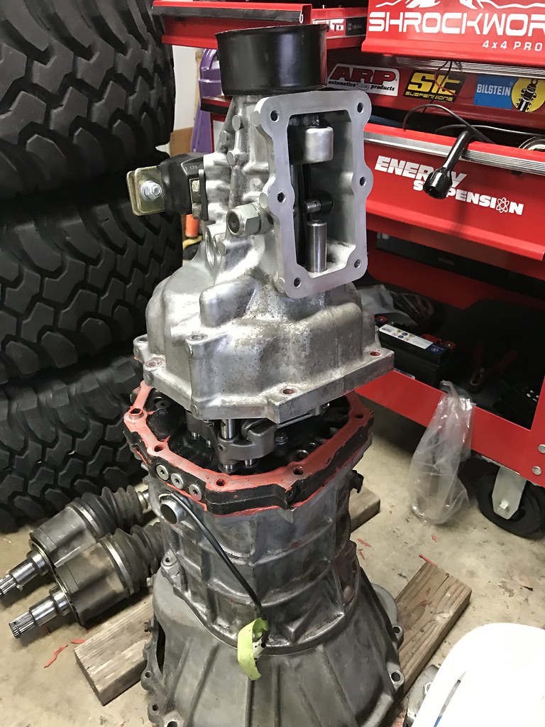

Pulling the tail housing on the R154 to harvest the shifter pieces. Also doing some cleanup of the excessive RTV use. Billet shift forks are sexy
Shifter extension done by driftmotion. 4.75” to match MKIV.

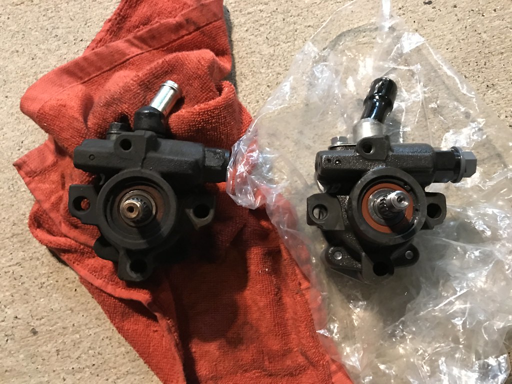

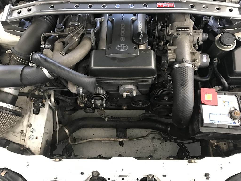

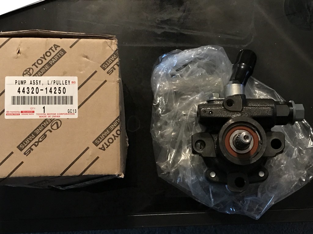

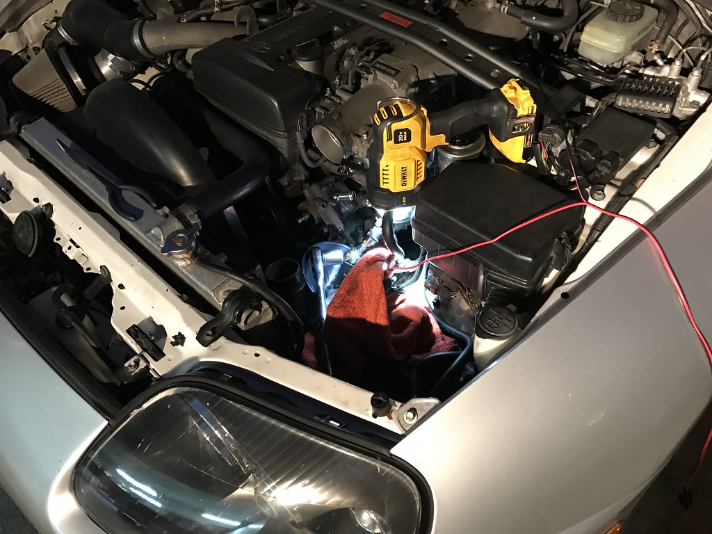

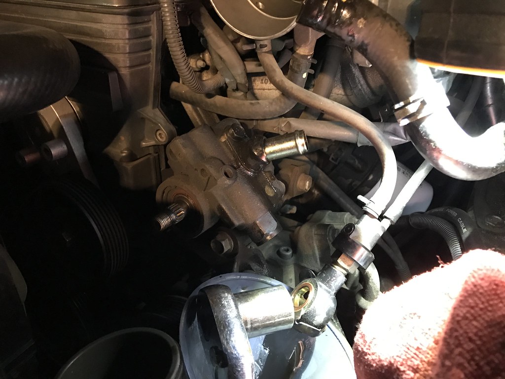

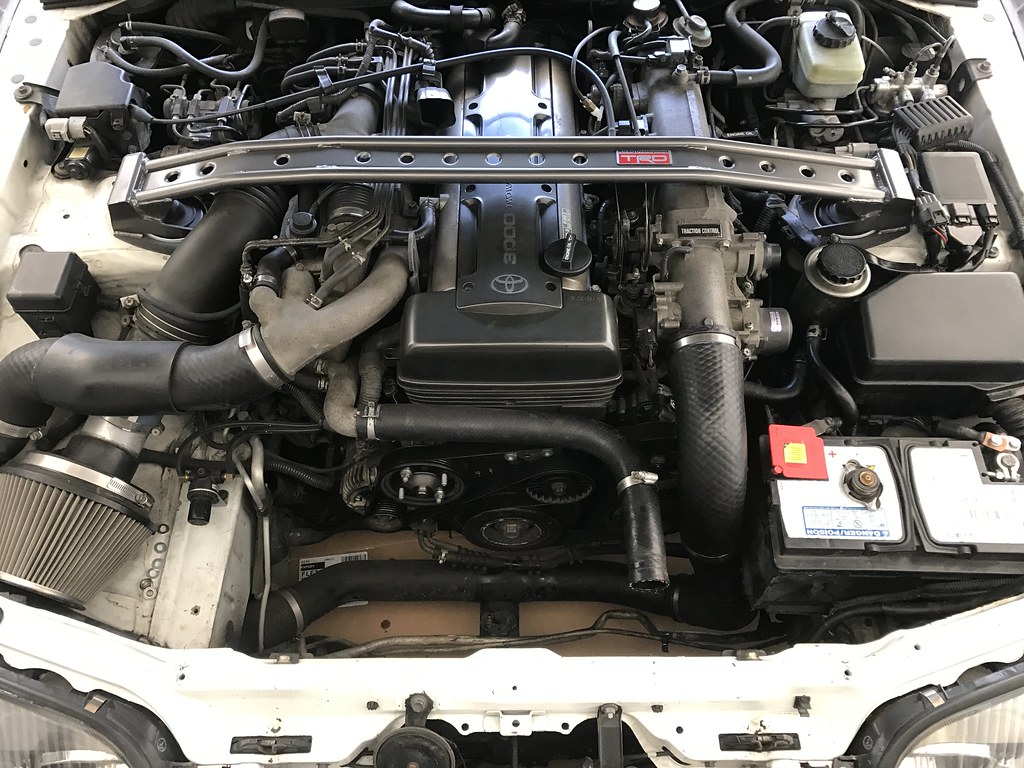

The power steering pump had always had a whine to it. It was also showing other signs of malfunction, thus it was time to get that sorted.

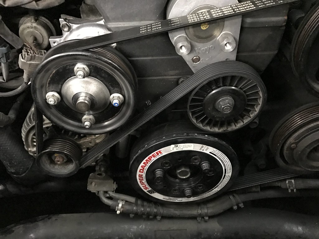

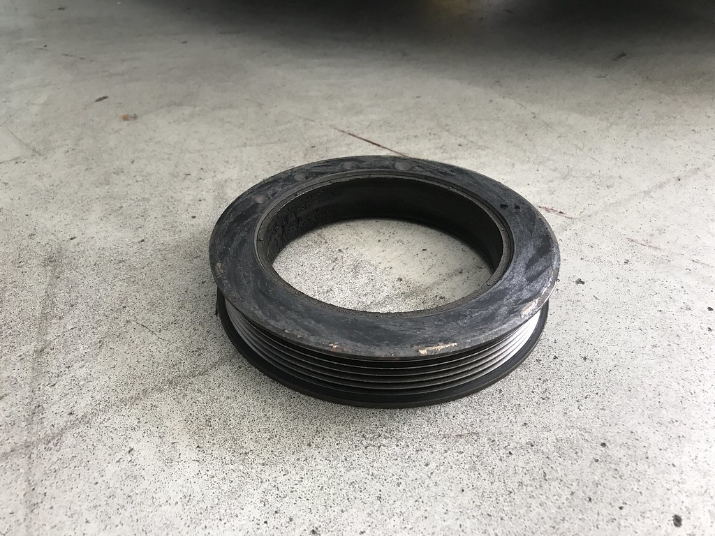

Harmonic balancer failed. 2JZ problems….

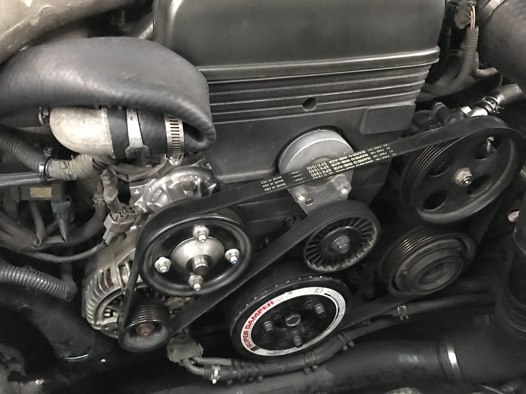

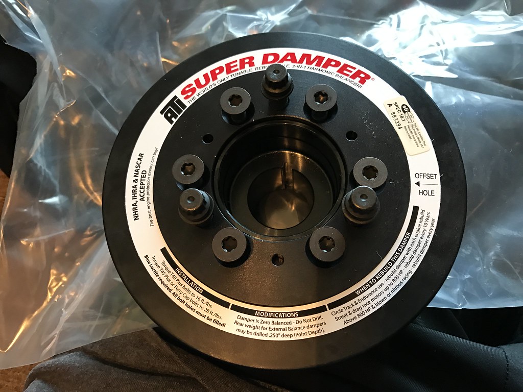

This was a good time to go with something a bit more… heavy duty. ATI Super damper.
Out with the old…
In with the new…

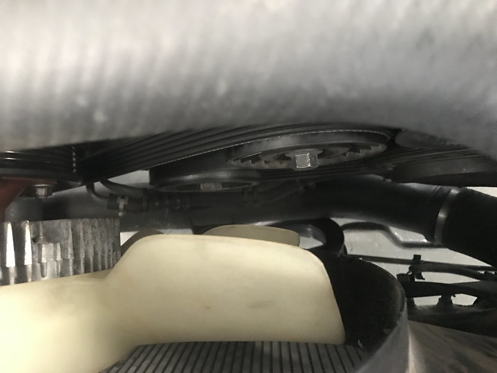

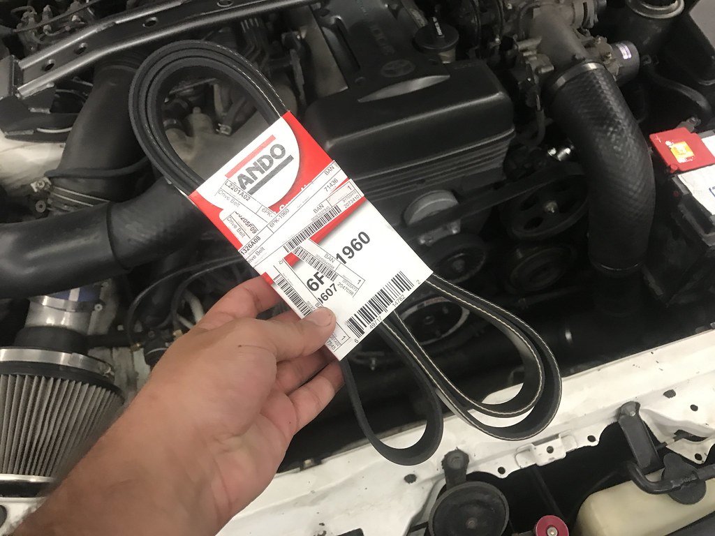

Longer belt since the ATI is an overdrive pulley.

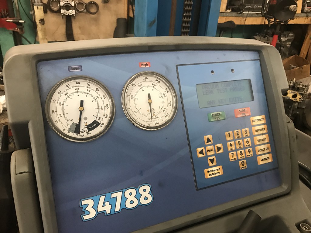

The A/C was begging to be tried out. A vacuum test confirmed the system is capable of holding refrigerant. It’s now charged and working beautifully.
