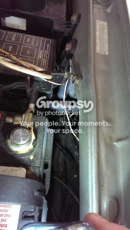

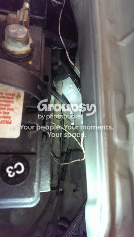

I can't seem to find the E2 ground. by the picture it looks like it should by by the side of the battery. Is it under the fuse box?
Sorry for all the wires, i just got this runner and there is all types of things that previous owners on and I'm going through.
Umm, sorry about that. The labeling is not as straightforward as I thought. What is referred to as E2 in the repair manual appears to be what is labelled as EC in the diagram I posted from the wiring manual--which would be the engine ground by the diagnostic plug.
