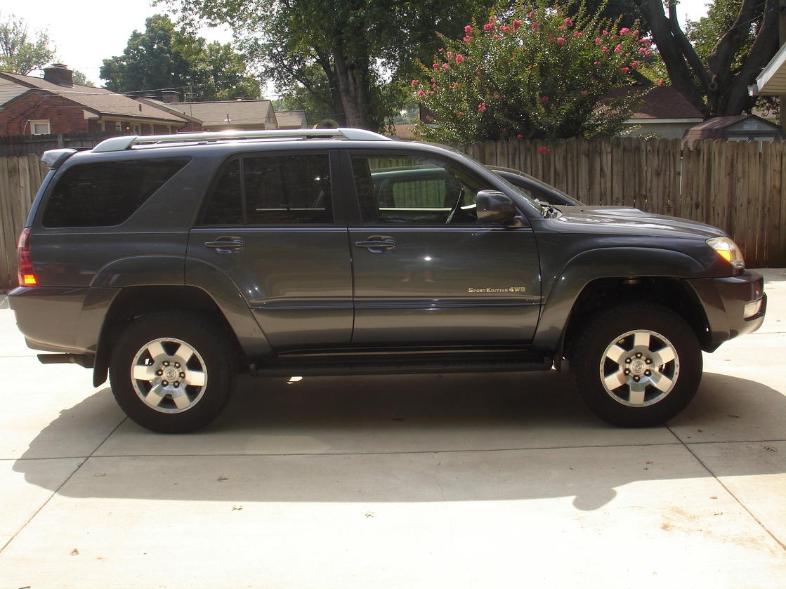

It looks tilted to the driver's side looking from the front.
Maybe the driver's side coil spring was accidentally put at the the passenger side or is it the full tank to blame?
Looks great overall.
That picture is a little deceiving as my driveway slopes down hill left to right. I double checked to make sure they installed the springs on the correct side, and they did.

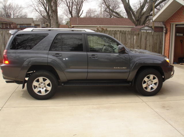

Left is before, right is after. Thanks for this great thread!
After:

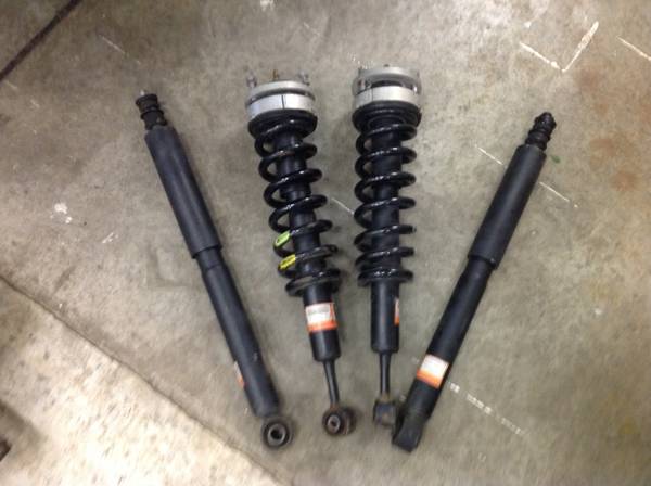

The goodies:

Before:
T4R.ORG modified:

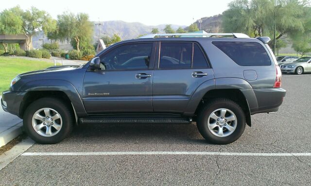

5100's and fj springs are done!!! Wow what a difference!!! The ride quality is ssooo much better. Did not get much of a chance for highway cruising but driving on city streets and over speed bumps there is less bounce and a nicer ride.
Went with the .85 setting (first notch from bottom) on the front struts. On the front went from 33 3/8 to 35. On back from 35 1/4 to 36 3/8. I do notice a difference on the height, which is nice, but we are in it more for the ride. Will post some before and after pics in the next few days. Too dark outside after I got home.
FYI, have your mechanic check all of your front and rear suspension components while they are at it. The bushings on the rear sway bar needed replacing. Also just plugged the xreas system. My mechanic told me to stop back by after 500 miles to make sure everything is still tight and torqued.
For any of you Phoenix, AZ folks I had Sierra Expeditions in Mesa do all of the work. For all of the above and a four wheel alignment they charged me $326.00. Talk to Will, the owner. He is very knowledgeable about our 4runners. He is my new go to guy for any mods!!!
Total cost: $964.00. Coils/Springs from Partznet $328.00. Shocks/Struts from Down South Motorsports $310.00. Install, alignment, sway bar bushings, xreas plugged from Sierra Expeditions $326.00.

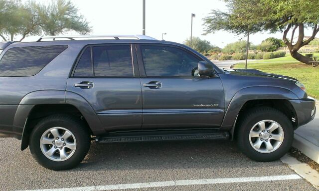

Before and after pics of the 5100's and fj coils.
There is a noticeable difference in lift. The big difference is the ride. Wife really likes how it drives now. It is her daily driver.

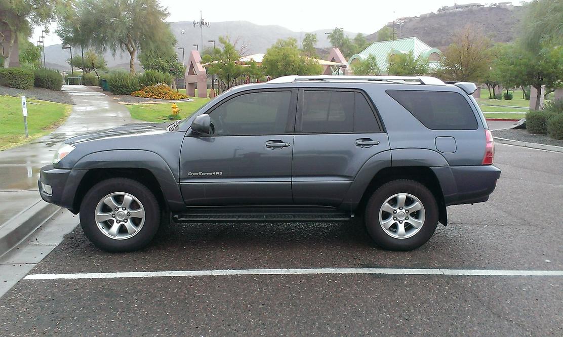

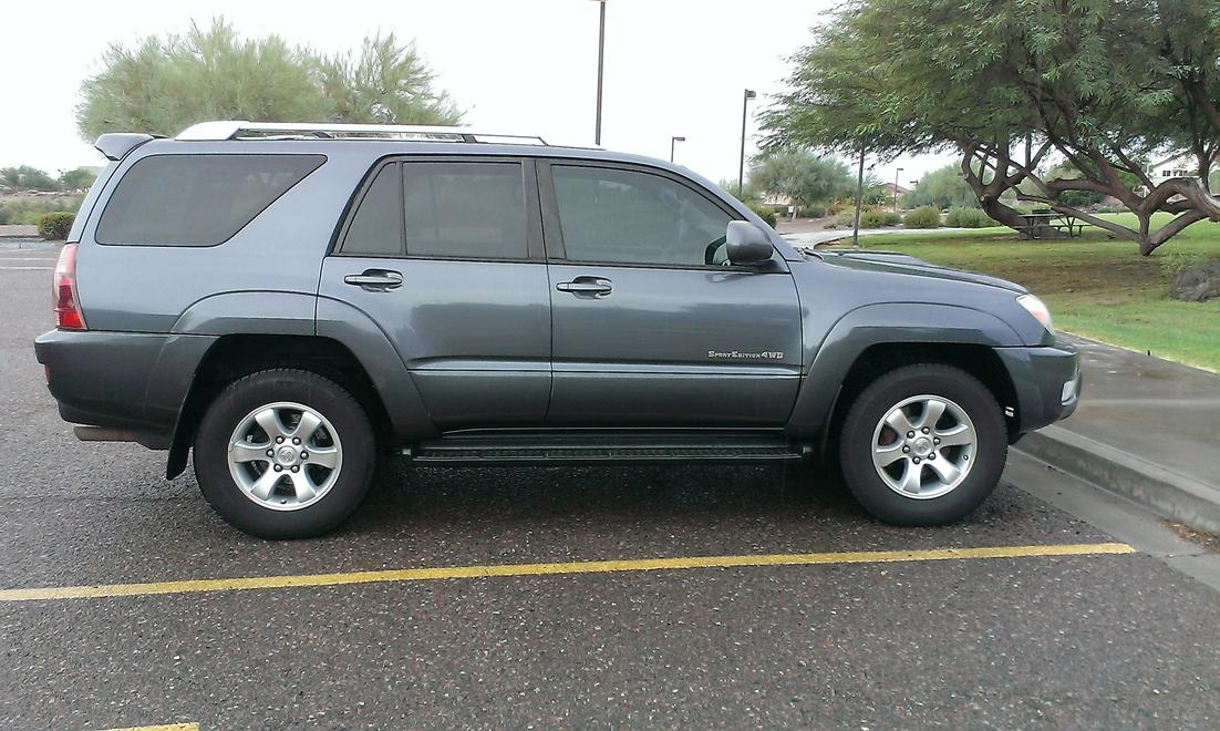

Before, It's tough to see because I didn't take a good profile shot...
So, here are a couple of pictures after the lift & alignment.
A shot of the front end components, including axle angles (no diff drop used).
TT FJ Coils all around, 5100's all around (fronts set at top setting), 1 1/2" Daystars on the rear.
