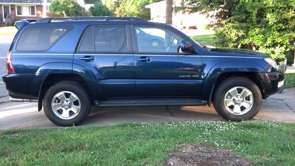

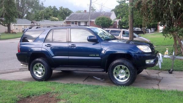

Finally lifted
XREAS Delete, 5100's set max, 2010 FJ TT Springs and Daystar 1.5" rear spacers...before and after
photo2_zpsaabcb17d.jpg~original
photo1_zps442c114a.jpg~original
I'm very pleased with the results and I'm glad I didn't have to grind or drill anything to make it all fit.
