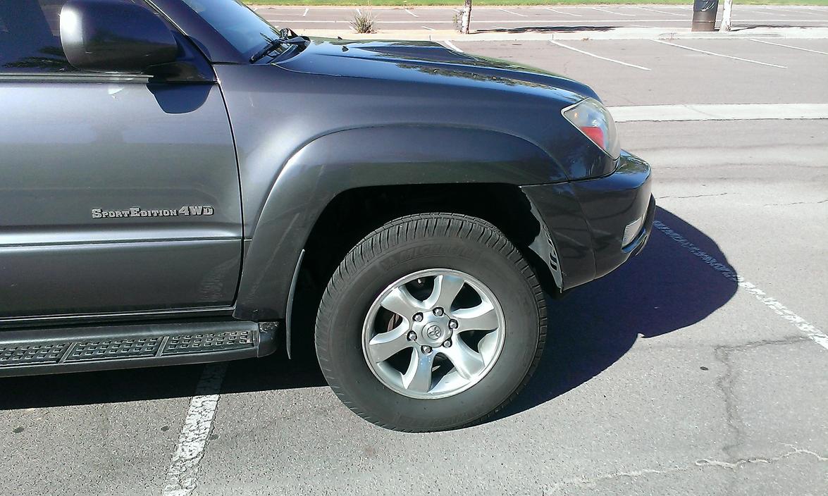

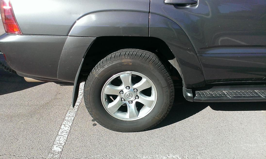

Before, It's tough to see because I didn't take a good profile shot...
So, here are a couple of pictures after the lift & alignment.
A shot of the front end components, including axle angles (no diff drop used).
TT FJ Coils all around, 5100's all around (fronts set at top setting), 1 1/2" Daystars on the rear.

From that profile shot, it looks like there's a slight rake to the truck? Or is it just the way the photo was taken? I wonder how much lower the rear would be if you didn't run the spacer...
Yeah, there is definitely still some rake (1" or so). I am totally fine with that sort of rake. Had I not gone with the spacer I feel like I would have had negative rake (HATE HATE HATE negative rake).
The second most important thing was getting as much lift out of the 5100's as possible. The spacers on the rear were definitely necessary to use the top settings of the front 5100's.
All told, firming up the ride and lift/leveling was the plan. Im more than pleased with it!

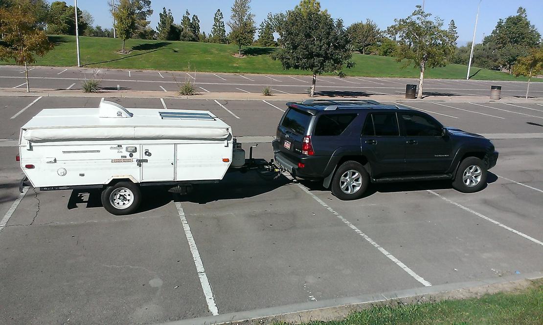

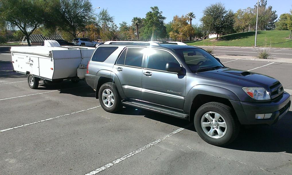

For any of you folks that tow stuff I took some pics and measurements when I had the popup hooked up the other day. Our popup weighs in at approx. 1700 lbs as it sits. It would be close to 2000 lbs if we would be heading out on a trip. Tongue weight is around 300 lbs.
I have the front bilsteins set at .85. No lift in back. On fj springs. Measurements average 34.75 in on front and 36.5 in on back. Bottom of rear hitch is 17 in. With the popup hooked up I measured 35.0 in on front and 35.25 in on back. Bottom of rear hitch is 15 in. So the back dropped 1.25 in and the front rose .25 in.
Seemed like it had a lot nicer ride than before the mod with the popup hooked up. Will be pulling the popup from Phoenix to Corpus Christi and back in a few weeks so I will update about the ride then.
