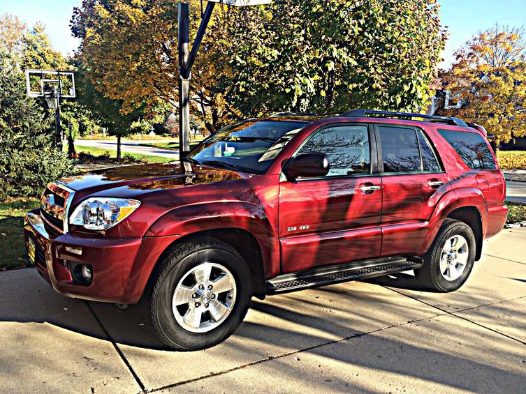

Hello Fellow Runners,
New to the forum but have been lurking the past few weeks after having my old Mercury Mariner totaled in a rear collision and since setting my mind on owning one of these awesome rides! Just purchased myself an '08 V6 SR5 with 4wd and couldn't be happier with my decision! Was able to find a steal here in Wisconsin thanks to my parents as these things tend to sell for RIDICULOUS prices back at home in Colorado.
Anyhow, looking forward to making some major changes to her over the next year, with a lift and suspension change being one of my main projects. I'm admittedly a novice when it comes to mechanical work but it's become pretty clear that many of you are experts and great at sharing your knowledge and skill sets(Derrick Jeter hat tip to "Ark" and several others).
I'd like to start sourcing parts for upgrading the suspension on my new lady as well as lifting her and had a few questions. I think I've settled on the FJ suspension swap and daystar 2.5/1.5 lift option as I don't plan on doing much off-roading and more so am just looking for the improved ride/aesthetics for my runner. Issue is, I can't seem to find many FS adds for the later model FJ suspension that will work with my 4th gen runner. I have found a set from a 2012 FJ but from what I've read, that would need some modification to the runner that I'm not sure I want to do. Any advice or help with sourcing these components at a reasonable price would be TRULY appreciated.
For now, a few pics of my new lady:
