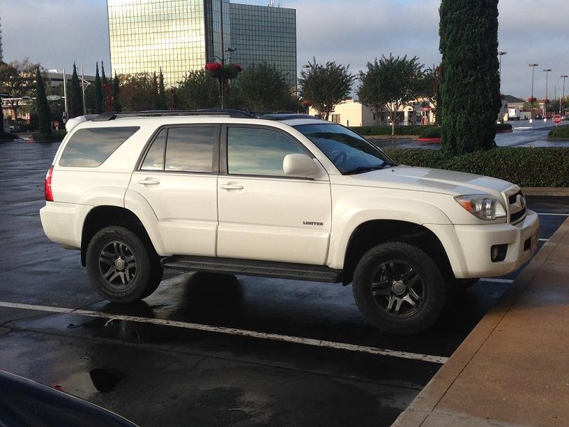

BFGs 255/75 17 mounted

^ Thanks...Bilsteins are maxed out which made it a bit taller up front. I took the chance of the front "bro" rake because I'd rather have that over the negative rake.

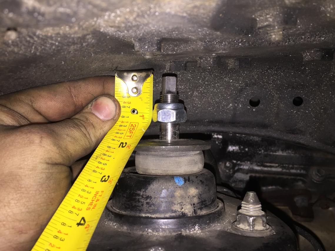

image.jpgSo... I bought and installed my Bilstiens and FJ cruiser springs. The springs are from a 2013 FJ cruiser. I am trying to find out, what is the correct color for the driver and passenger side springs? I installed the grey/purple on drivers side and orange/purple on passenger side.
However, after installing the shock and spring on the drivers side, the bolt on top off the shock is sticking out a lot further than the passengers side. Plus, when I hit small speed bumps I hear a clunk sound coming from the drivers side. This occurs at low speeds( 15-30 mph).

So, I will be the first to admit that I left out the bottom cushion and washer when I installed the problem shock. Went back into the shop and fixed it this morning and now... the 4Runner rides like it should.
Thanks again to everyone that helped me identify what was wrong.

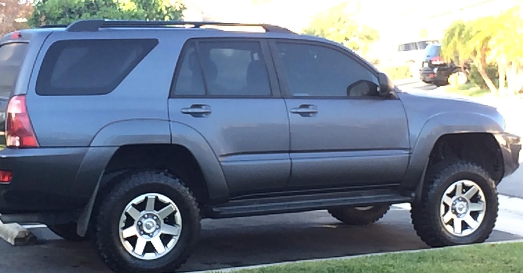

Just wanted to post this up as a reference for anyone considering the FJ swap. I have an '07 Limited 2wd v8, and replaced the stock suspension with 4x4 springs from a 2012 FJ trail team. I have the following set up:
Front - Bilstein 5100 adjustable shocks, clip on bottom setting. 2012 4x4 FJ trail team springs. Daystar 1.25" topout spacer (this one)
1.25" Lift Poly Front Coil Top Spacer Kit
Rear - Bilstein 5100 shocks. 2012 4x4 FJ trail team springs. Daystar 1.5" rear spacer.
Wheels/tires - Tundra split spoke wheels with 265/70/17 Cooper Discoverer AT3 tires. I know they calculate out to 31.65", but they actually measure just under 30" when laid flat on the ground so I know there's no load compressing the tire.
Anyway, here's what it looks like after a couple hundred miles of settling.
