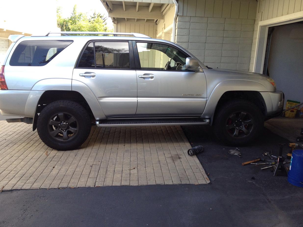

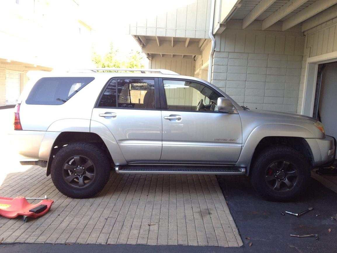

Installed my fj springs with 1" dystar leveling kit. Here are the before and after specs. From center hub to fender and ground to fender.
Front. 19"-21.5
34.25-36.75
Rear 21.5"-22.5
36.5-37.25
I got exactly what i wanted and expect.
Before.
Front. 19"-21.5
34.25-36.75
Rear 21.5"-22.5
36.5-37.25
Before.
