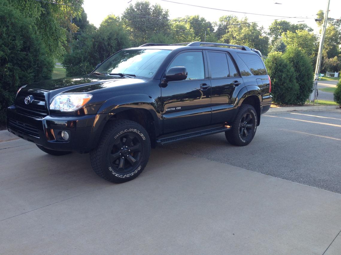

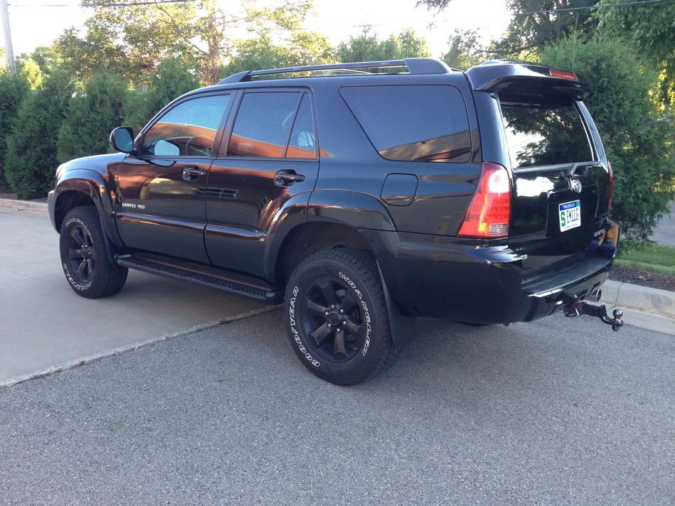

Recently pulled the trigger to level out and lift my 2008 Limited, turned out pretty well. I used FJ springs with 5100's all around, 1" cornfed out back, and installed 265/65/18's on plasti-dipped rims. Just need a day to black-out the emblems, and it should be perfect.

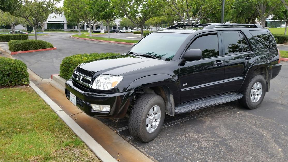

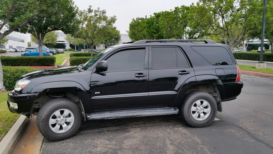

Been meaning to get mine up in this thread. FJ coils, 5100's on 1.75, and daystar 1.5" spacers on the rear springs. 265/70/17 Hercules Terra Trac AT tires. No issues with alignment.
My pics never look as good as it does in person.... :/

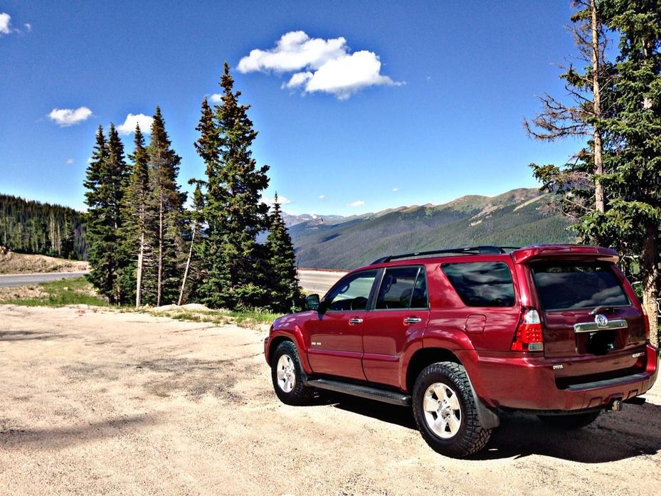

FJ 5100 swap complete
Thanks to all of the great advice and write-ups on this forum, I was able to install the FJ/5100 swap in my garage last weekend. I am SO stoked on it! The thing rides like a brand new vehicle. Mostly, the added travel and better damping ability have proved a god send on highway bumps and off-road use. I ended up getting the 5100's at a decent price online (360?) and found the FJ springs from another user on this forum. Total I was in about $550. Decided to swap out sway bar bushings and top-hats while I was at it. Here are a few quick shots I took this morning. 2007 FJ springs and 5100s on all four corners. Fronts set at 0.85". Ill try to get a few better ones posted later.
Thanks to this forum for all of the help along the way.
What is your front 5100's setting?
