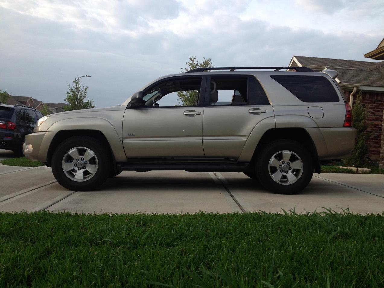

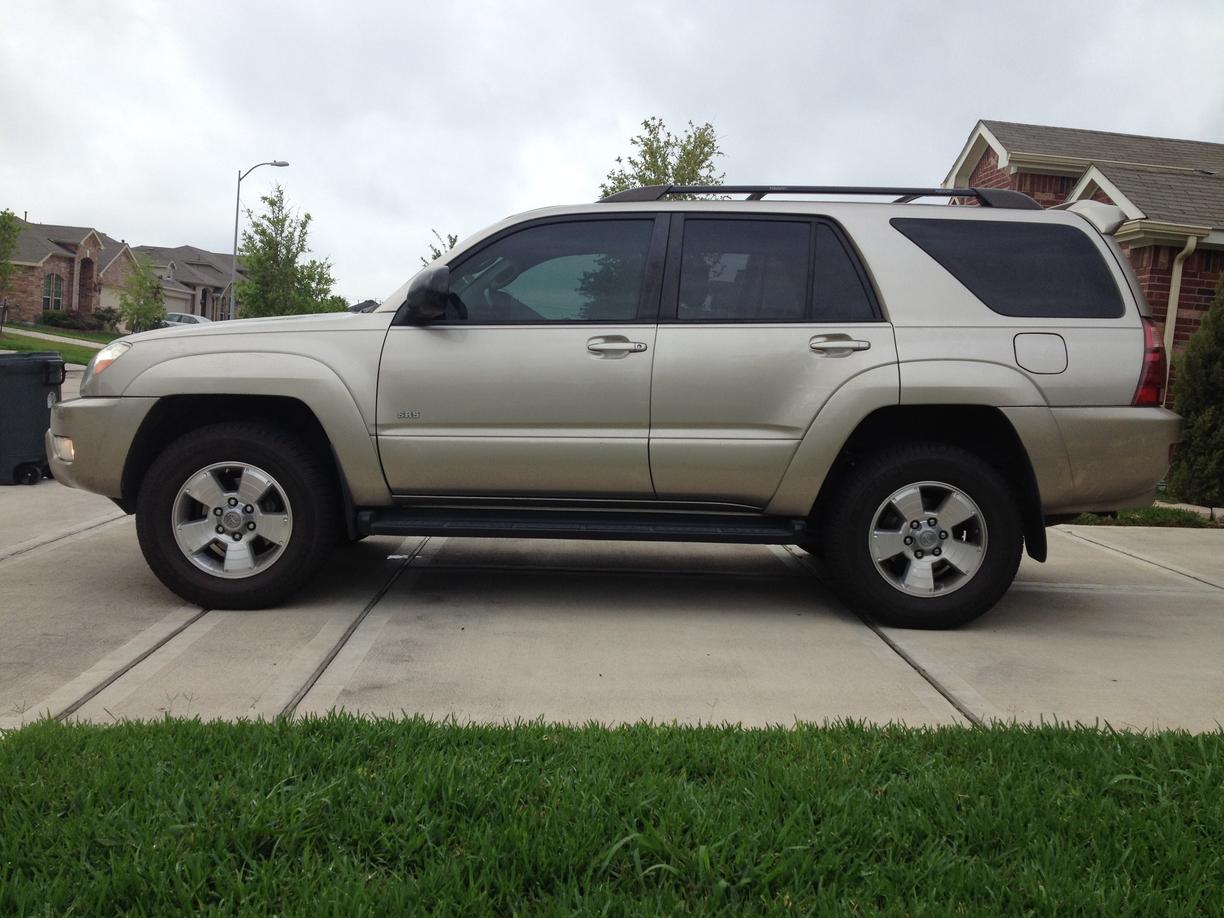

Just did my swap. no spacers installed, just springs here.:toilet:
2005 4runner 2wd v6 (168k mi) with bilstein HD (30k)
springs were from a FJ 4wd with i think around 70k miles or so. trying to find the email with the info.
The bilstein HD all around have ~30k miles front, <10k mi rear, had them on the stock springs and made the ride better on the freeway.
The rear seems to be a very slight lift, the rear springs were very slightly thicker.
the front springs were definitely thicker.
ride quality:
did the rear first and noticed the ride firmer just getting out of the driveway to reverse in. after the front, the ride is a lot firmer yet controlled. i still have to do alignment. most / 1/2 of the truck like bouncing around has gone however the front still feels bouncy, like when braking hard when parking and the nose goes up and down like worn shocks, altho shocks are pretty good. but hey, i come from sporty cars so i think i'm being too picky
handling is a lot better around curves. lean is less. the steering feels firmer and a bit more responsive. but i'll have to see after alignment.
overall great improvement, the ride feels more controlled now. it's not soggy. the suspension feels tighter on bumps. it feels renewed. i didn't measure but about 1.5" lift in the front. mostly did it to get a better ride

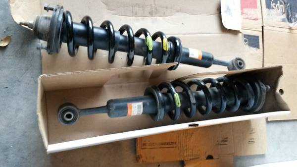

Found these springs on craigslist for $30. Came with the shocks even though I don't need them. Installing this week at the 2.5 setting on the 5100s!

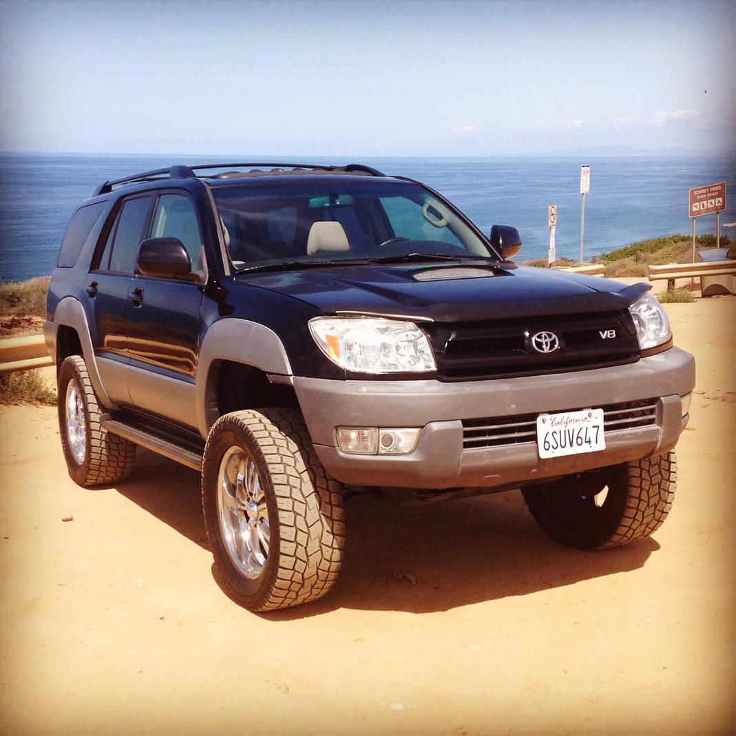

Even with the weight of the vehicle on this corner the UCA was tucking into the coils and ball joint angles were extreme with FJ coils and 5100's on the top notch.
I reminded myself of my original objectives for this build and being the tallest and damaging parts more often weren't on the list. I dropped it down one notch and felt much better about it. Lift height looks perfect at 1.75 setting.
