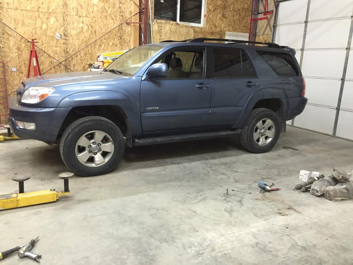

Installed some 2014 FJ springs (17k miles on them) this weekend. Perfect fit.
Bilstein 5100s set to .85 in front and 265/70 KO2s. Total difference 3" front, 1 5/8" rear. The ride is unbelievably smooth compared to stock with 106k.

Final product,10 FJ coils and Bilstien 5100's "85 front.
XREAS Removed, two shocks were done.
RAS Removed, sensors were in error mode with full inflate.
