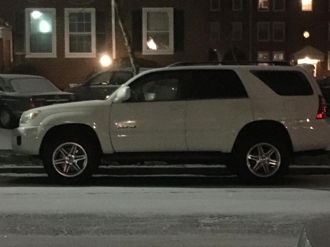

Here's photo and measurements of my rig after the lift.
2008 T4R limited 4x4 V8.
Stock size limited tires (265/60/R18 Michellin Defender LTX M/S about 30")
FJ Cruiser Springs front & rear
Billstein 5100 shocks. Set to 0.85 for the front.
Daystar 1.5" spacer lift on the rear (goes on top of rear coil springs).
Ride-rite airride air bags inside the rear coil springs (levels out rear under load, but doesn't add any additional lift)
Measurements:
Front Driver's side: 35"
Front Passenger's Side: 35"
Rear Driver's Side" 37"
Rear Passenger's Side: 37.5"
(Sorry 'bout the poor photo... it's dark and snowing (!!!) but I wanted to get to this before I forgot!)
(P.S. The 1.5" rear spacer is only $38 on Amazon. "Daystar KT09127BK Comfort Ride 1.5" Rear Coil Spring Spacer Kit"

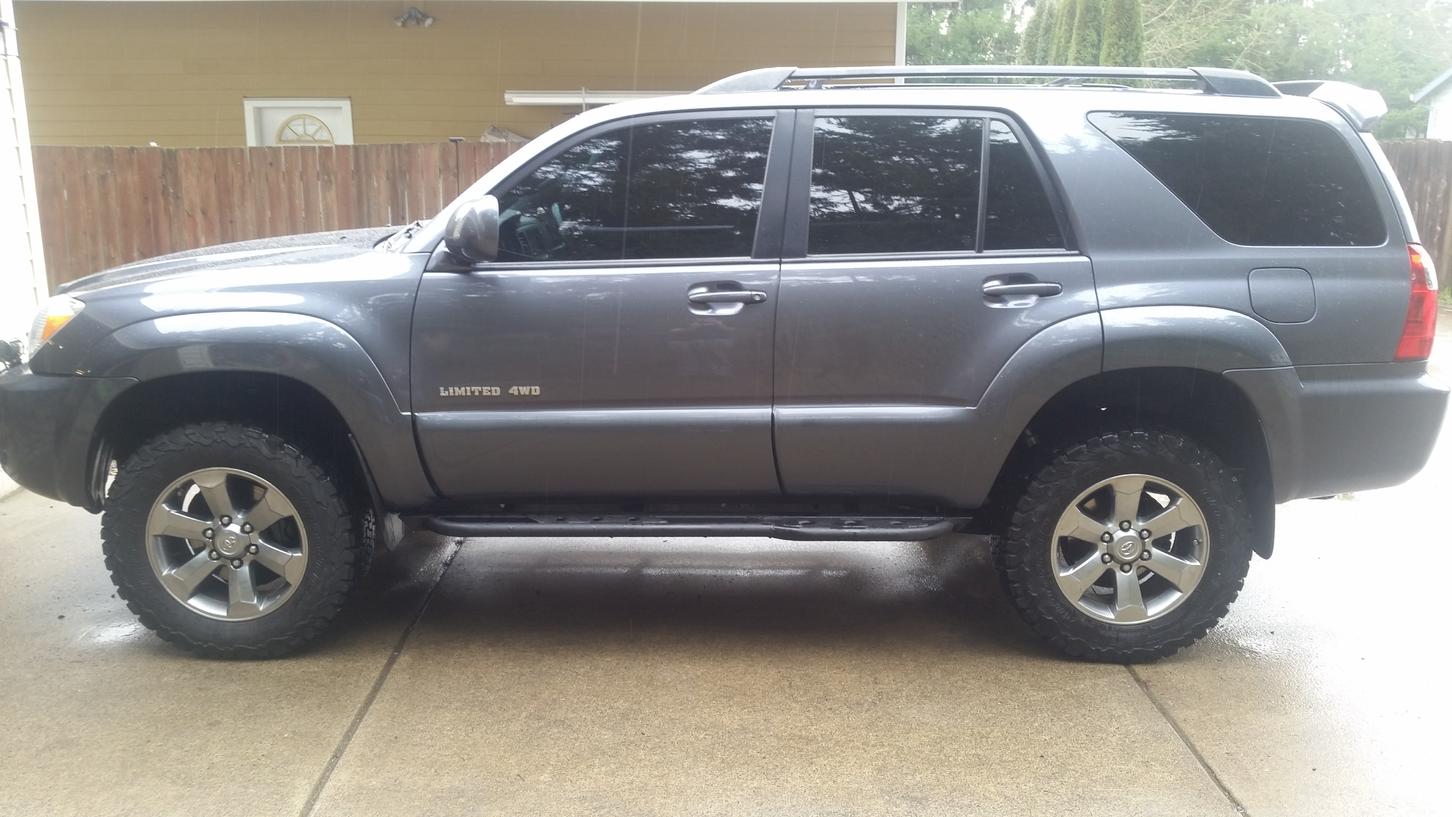

So here is a Tacoma sport lift. With a daystar 1.5" spacer on the rear passenger side and superflex rear springs.
Basically I got 2" of lift on the front with the Tacoma lift so I lost 1/2" of lift on the front.
I'm thinking a toytec 3/4 spacer on the front should help my issues.

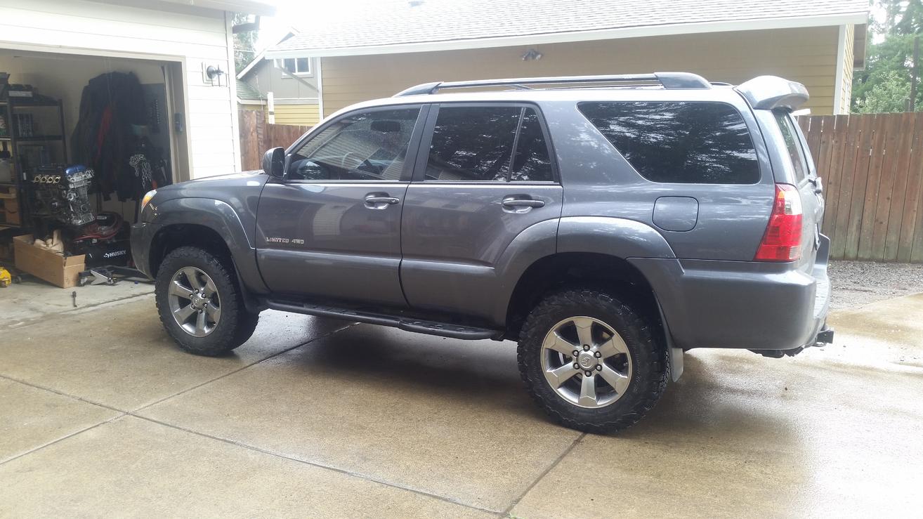

2012 FJ trailteam springs all around, 2012 FJ trailteams front struts, 5100 rear shocks. Daystar 2" front and 1.5" rear spacer.
