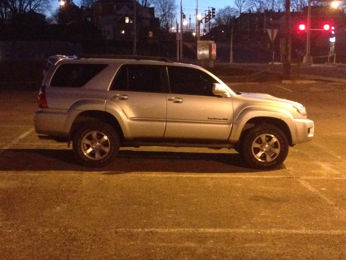

I'm looking to add a little lift and get the back about an 1 inch higher than front and would like a second opinion on my maths. I currently have .85 on bilsteins up front and fjs all around, but my rears only have 3k while the fronts have 80k.
I measured my current setup from ground to top of wheel well through wheel center:
Front: 35
Rear: 36.75
So if I bump up from .85 to 1.75, I'm adding .9 inches, but it will add 1.8 inches of lift with the front trig factor, putting the front around 36.8. So, to get the 1 inch rake, I'd be wanting to add a 1 inch spacer then in the rear? (Or 1.05 to be precise)

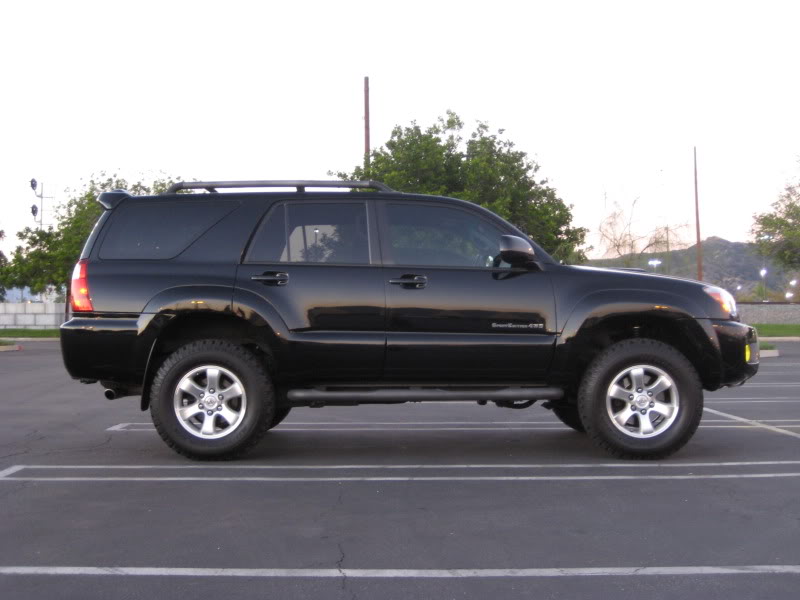

I'm hoping to turn my silver into something like PharmSCRunner's below who has FJs and Cornfed 2-1.

The lift height advertised by Bilstein is the net amount of lift you will gain. They may not be exact, but you will not get 2x their stated height. The actual grooves on the shock are approx 0.5" appart, so each notch up should net approx 1" lift.
That said, once you figure out the front, you can order a custom sized spacer for the rear from Cornfed. I've ordered a few from them in custom sizes for different setups I've ran.
