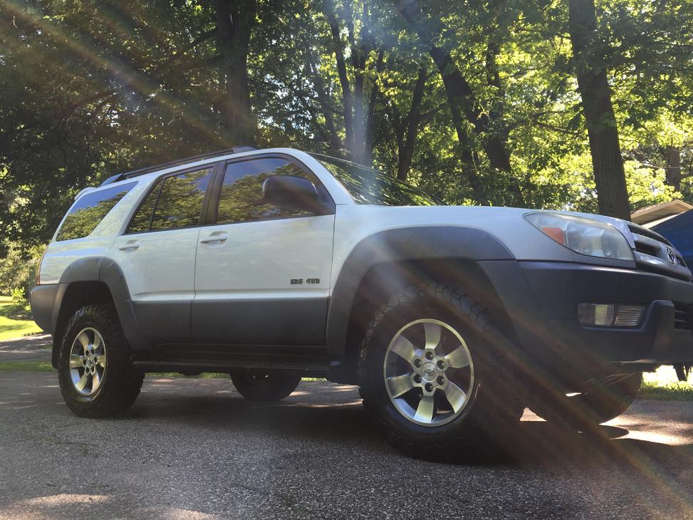

5100's and new 2014 FJ springs from dealer. Slotted Dimpled rotors from Brake performance, 2011 4 Runner wheels, and KO2's. The Brake Performance rotors with the upgraded ceramic pads from them are really nice.
The ride is fine. Freeway speed manners are not so great. I doesn't track as straight as it did. Slam on the brakes at 75mph and you need to be ready to keep the truck on the road. It was not that way before. Not sure if it's the KO2's or what? I did have it aligned after the springs and shocks were installed by the shop that did the install. Think I'm going to have the Toyota dealer do another alignment? Also thinking about moving the fronts to the middle setting on the 5100's. Currently sitting at the 1st setting of .85
