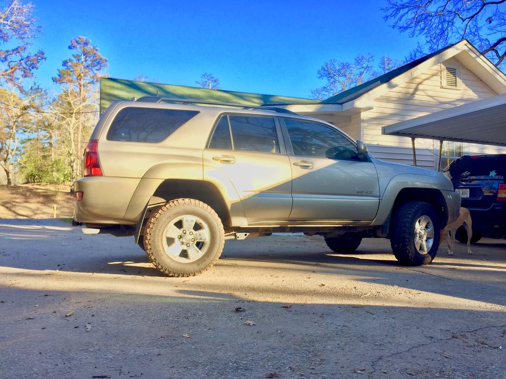

Hey Guys and Gals,
Do you guys think the rear FJ springs would give my truck too much forward rake? Or do you think it would be just right?
Couple pics for your viewing opinions:

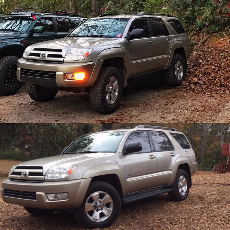

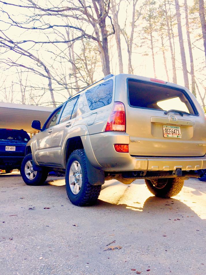

2004 Sr5 V6 4x4 may be different for V8 but might help you.
Just installed FJ springs with 5100s on 3rd notch in the front. 1.5" rear spacer with stock 4runner springs and 5100s in rear.
It has a slight take to the front but looks level to the eye at some angles.
Pics aren't best quality

I just finished a 2006 V8 with 5100's at 0.85 in the front and Moog FJ
front & rear, and the body looks pretty level. Adding another inch to the front
would definitely cause reverse rake although the fender gap might look
closer to even (sitting level the rear gap is always larger).
Side note: It's definitely true that the rear FJ Moogs do not sit
in the lower spring seats properly without modification. We took about
an inch and a half off the end of each coil (bottom end) to get em
to seat right.
