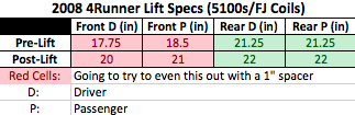

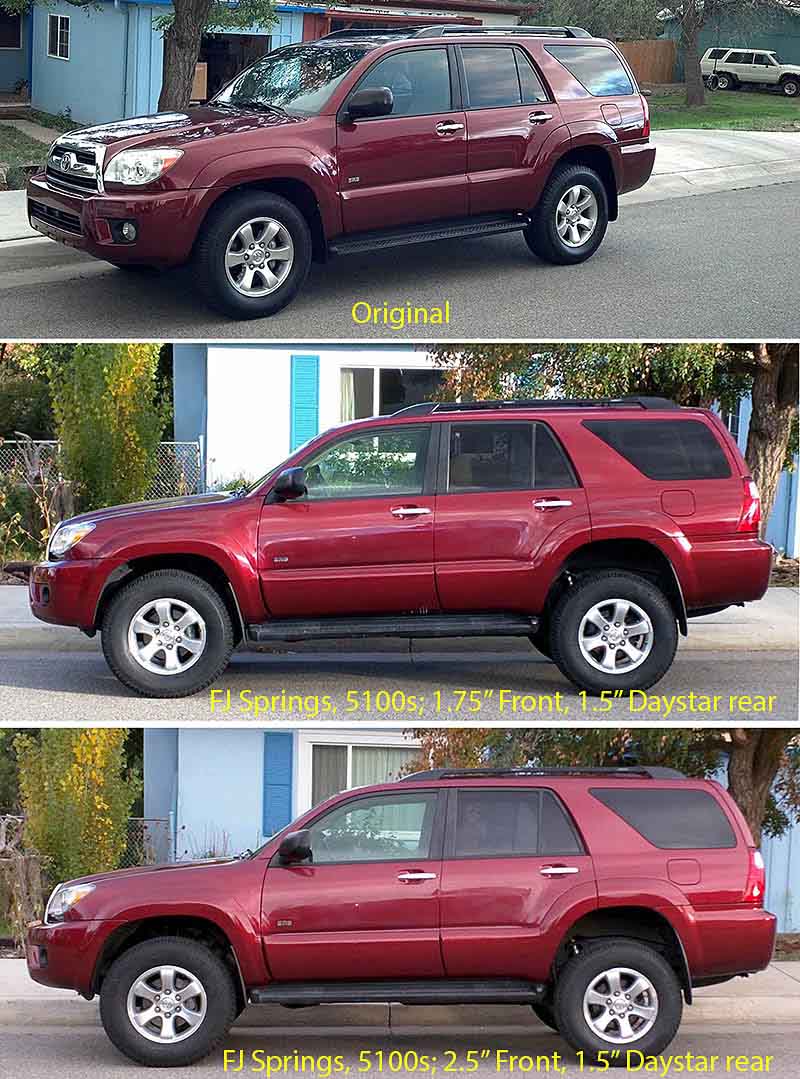

I finished the lift on my T4R this week. It was a work in progress until I was able to get the lift I wanted (and looked good).
Moog FJ springs (F & R)
Bilstein 5100s; front set to 2.5" lift, Daystar 1-1/2" spacer in the back.
Michelin 265/70/17 LTX AT2 tires
Eventually, I'm going to also add the 1-1/2" Spidertrax wheel spacers.
Daren

As to the leveling, it depends on what part of the 4R you use for your measurements. I used the running boards. Setting the front shocks at 1.75, the difference in the front of the running board to back was 2". After I raised the front shocks to 2.5, the running board difference front/back is 3/4". Removing the 1.5" rear spacer may result in a brah lift.
When I got the steep rear lift, I had the choice of lowering the back 1.5" (removing the spacer) or raising the front 3/4" (to 2.5). I threw the dice and raised the front resulting in the 1.25" front leveling by my measurements. :lever:
This is what I got.
