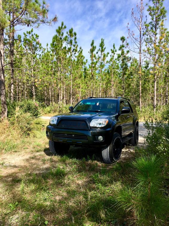

So, I have Moog FJ springs and Bilstien 5100's on my '09. I am on a 4 week road trip around the country, I have a lot of weight inside, a tepui tent on top, and a hitch mount bike rack with 2 mountain bikes. It handles and drives great even with all the weight, but its definitely riding a little low in the back. I've done some light off roading with it along the way in Colorado and Utah and it seems to be holding up ok so far. Overall a great, inexpensive suspension option.

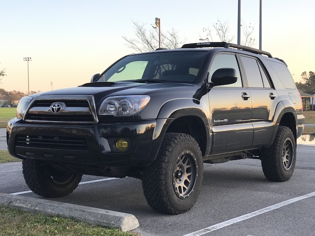

Ended up with kind of a mix of components so I thought I’d post. Love the way it came out.
Front: Moog 81108 with Bilsteins at 1.75, toytec .5” top plate
Rear: factory FJ 4x4 springs, bilsteins, 1.5” daystar spacer
Tires: 255/75r17 firestone destination A/T on procomp
Bought the runner with a 2/1 lift already on it, and it had a 2” rake. The current front lift brought it up 3.5” over the factory springs at first, and that settled to 3” with 2” spacers. Factory front coils had some some serious sag at 135k!

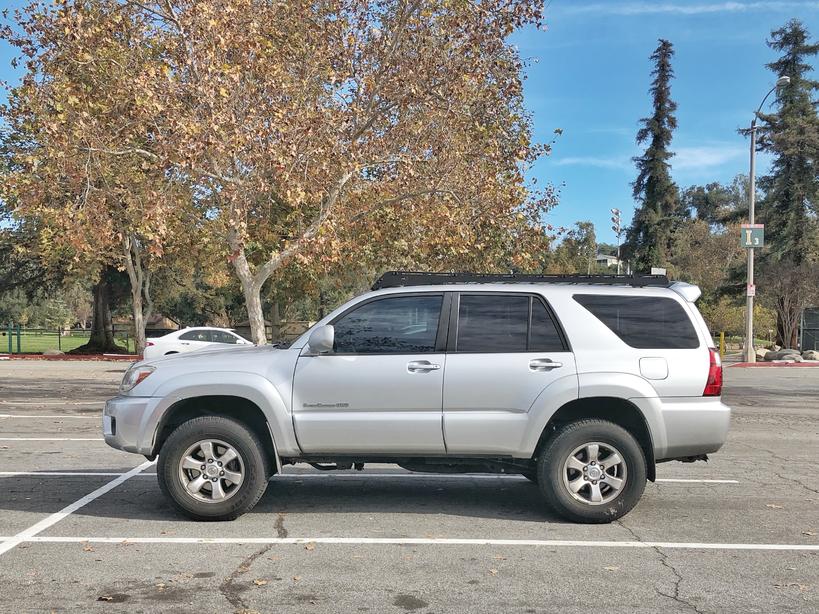

5100s, front at 1.75, FJ Springs, and 1.5 Daystar spacer.
Thanks to this forum, and this thread in particular, I was able to get rid of the mushy XREAS and spacer lift. The ride is much better now and fixed the slight bump steer issue I was having at highway speeds.

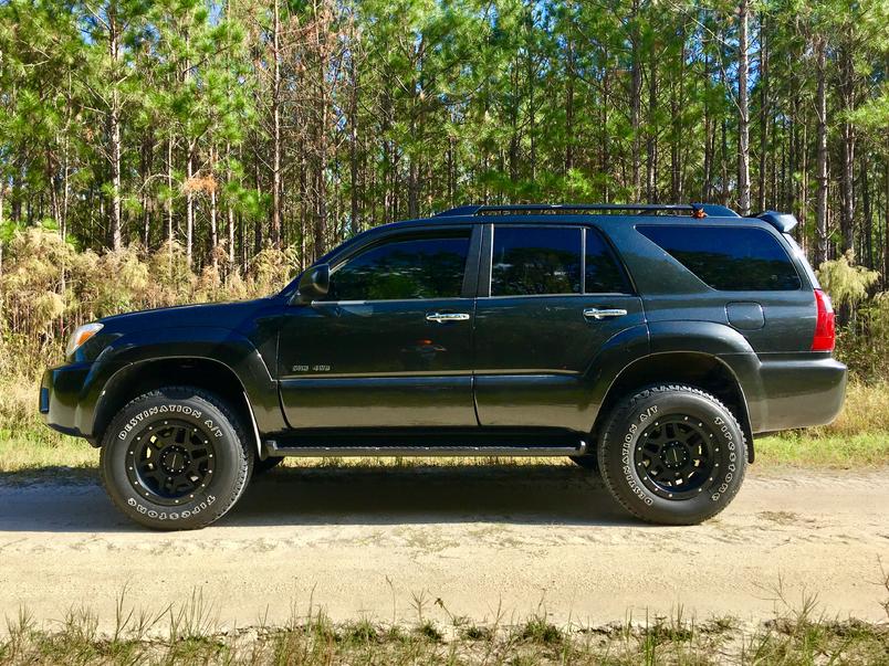

No before pictures but picture a 2006 v8 with dead oem xreas suspension.
This photo is taken 2 days after having Miyaki Motorsports install the 2/1 cornfed spacers, 2013 fj coils, adjustable bilstiens set on the lowest setting. Also had them instal new LCAs, drag links and cv axles.
Love the way it rides now.

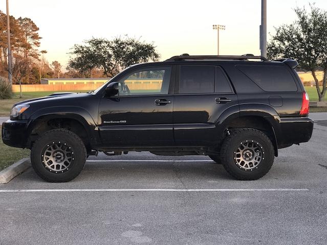

Installed 5100's on all 4 corners and moog FJ springs. The height, ride, etc. are perfect. I am going to revisit the rear driver spring. I grinded down the passenger rear and it seated pretty nicely. The driver's side did not, but I was exhausted so figured I'd get to it later. Lots of rusted together parts made this job take WAY too long.

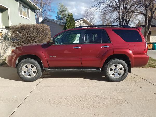

before:
after (sorry, crappy pics)

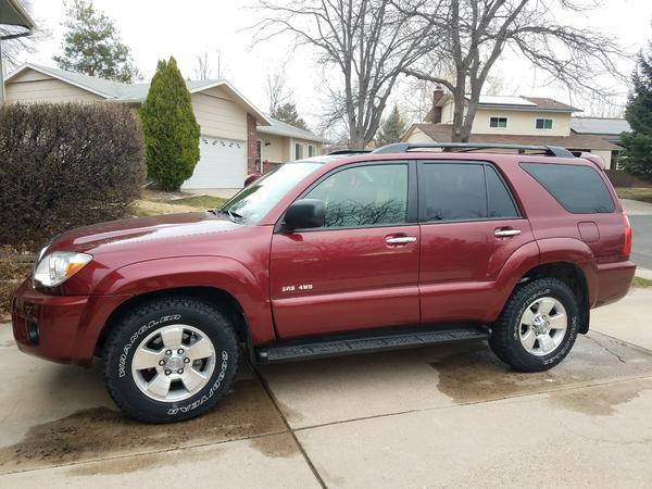

Just swapped in the Bilstein 4600s and front springs from a 2015 Tacoma TRD Offroad ($130 locally off Craigslist) and 2007 OEM FJ rear springs ($70 shipped from an FJ Cruiser forum member).
My 'before' measurements showed the passenger side rear was 3/4" lower than the driver's side. The FJ springs evened that up and now both sides measure out at 35 3/4" from floor to the fender. (I used a Bosch laser device like this so I'm confident in the numbers.)
I got 1.5" up front from the new setup so it's nicely leveled all around, and that was the goal. Rides and handles much better than my worn out X-REAS with 149K on the clock.
