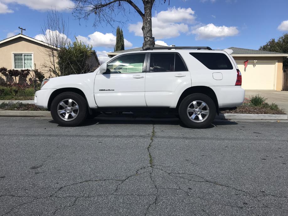

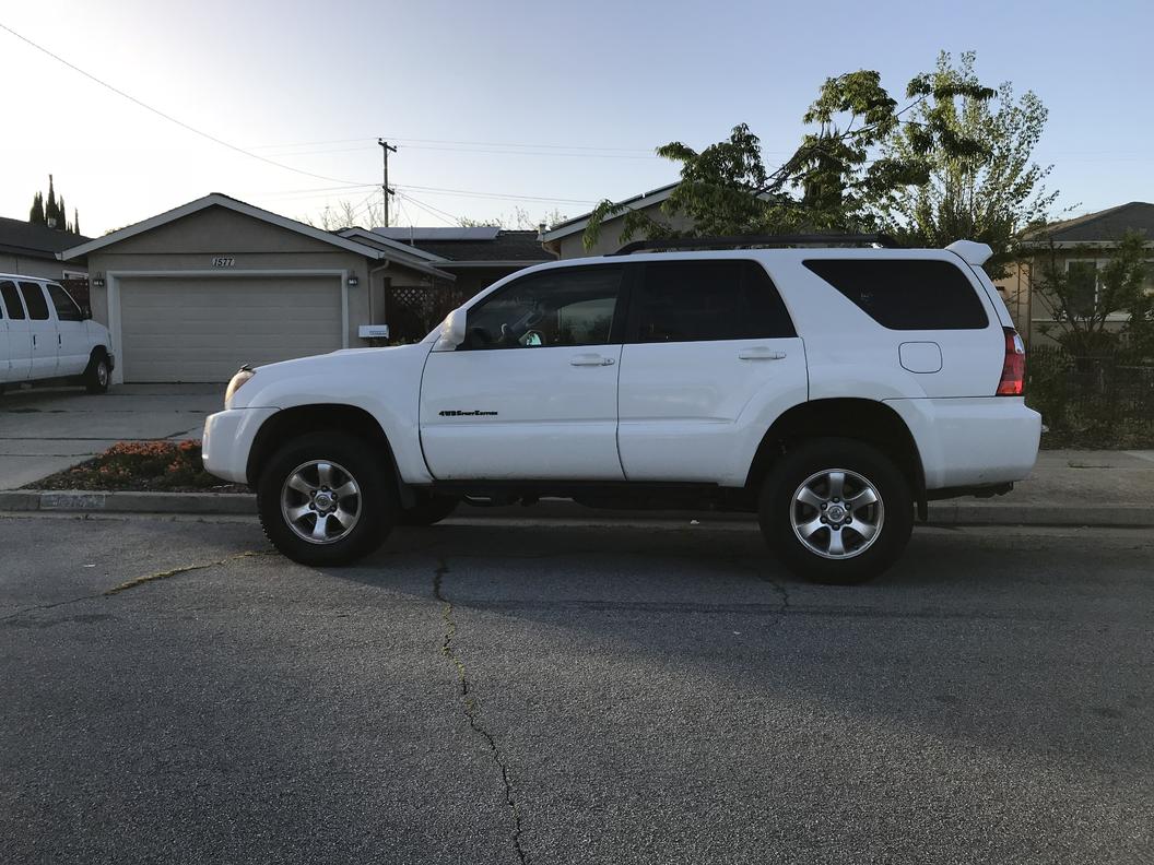

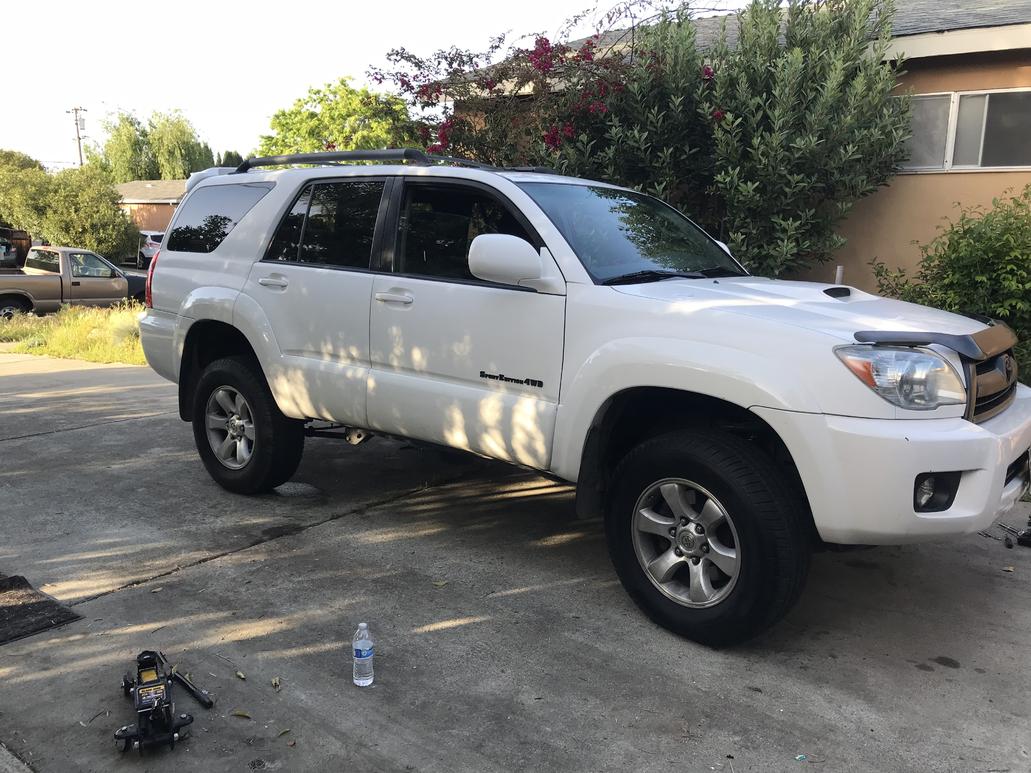

Just installed 5100 Bilstein’s all around at 1.75” along with fj springs
Before and after pics
