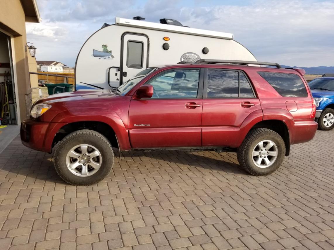

FJ springs all the way around, 5100's set at 1.75 & a 1" daystar spacer in the rear.
Very happy with the ride, firm not harsh & I don't need the air bags to handle the travel trailer anymore.

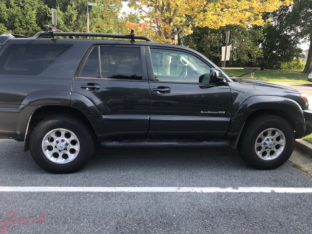

2012 FJ Off Road Package & wheels with skinny tires
FJ Offroad Package, coils and shocks plus 2012 FJ Wheels. Then 255/75/17

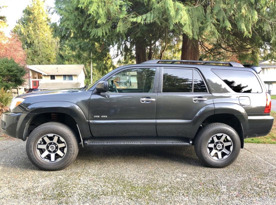

Hey John, your ride looks great! Did you happen to measure your before and after from hub to fender? I'm curious what kind of lift you ended up getting.
I went a different route for my suspension and got way more lift than I was expecting and I'm wondering if it's too much and I'll need to mess with a new UCA. I've already had my CV axle boot split, but that's not surprising on a rig with 160K on it.
People talk about needing new UCAs with a 3" or more lift, but that doesn't tell much when you're comparing to a saggy old suspension. What's the baseline for the 3" to start from? It seems like what I really need to know is, at what hub to fender measurement do I need to worry about new UCAs?

Thanks. I had it aligned and they didn't say anything about any problems, so I assume it's OK. I attached a pic of my rig with the new suspension.

Thanks Derek. I'm nowhere near 3.5. I'm at 1.3 and 1.39. But my steering feels fine. The specs say that 3.97 is the max. I guess we'll see how it settles in. Perhaps over time it'll feel like it's wandering more, but for now it feels great!
My only real concern is the CV axles. I've already replaced one and will probably need to do the other before long.
