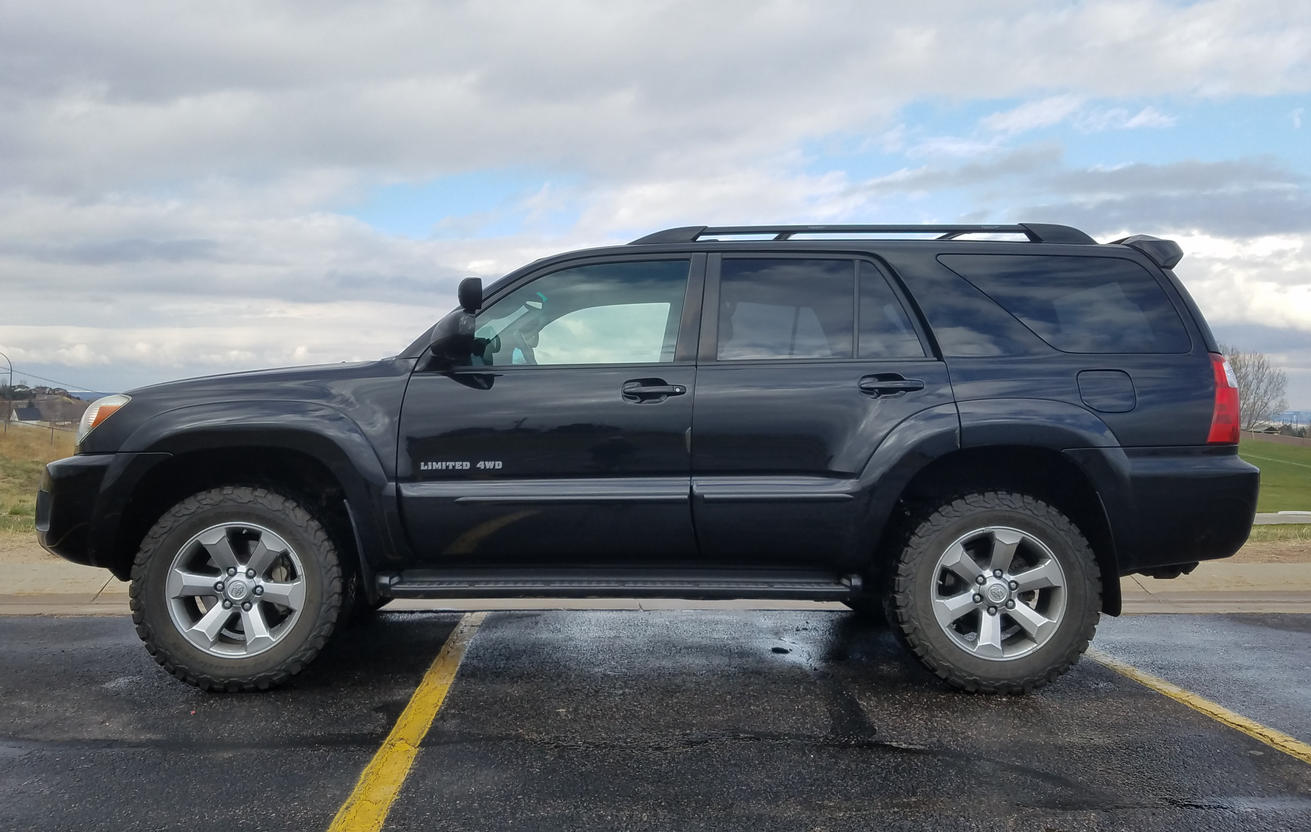

Daemon, sorry for the massive 3 year resurrection, but what tire size are you running in the picture you shared (included in this post) ? Can you post an update on how it's sitting?
I'm asking because I am after a very similar setup on my 2006 V8 Limited, and I can't decide between the 0.85 perch or the 1.75 perch with the Moog FJ springs, which seem like they give more of a lift than the actual Toyota FJ spring take-offs. I'm planning on running 265/70r17 on Level 8 mk 6's...
If anyone has any advice or new images of a similar setup, I'd appreciate it - I've pretty much exhausted all searches and threads.
Daemon's setup in question below:

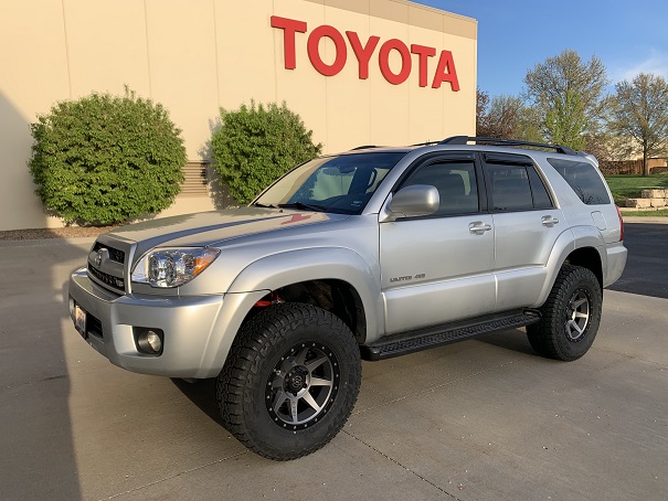

Just finished lifting mine a couple weekends ago. FJ springs and Bilstein 5100's at all 4 corners. JBA upper arms and Daystar 1.5" spacers in the rear. The wheels are Icon Rebounds with 285/70/17 Wildpeak tires. I originally set the front to the 1.75" setting with the 1.5" spacers in the rear. However, when it was done, it looked like the rear was too high and the front too low. Ended up pulling the front apart again and raised the front to the highest 2.5" setting. Looks much better now. As far as being sensitive to bumps, mine seems to be the same way...before and after alignment. Just chalking it up to it being lifted now and will just have to deal with it. It doesn't bother me as much now as it did at first though. Just is what it is I guess.

yeah, mine was the fact that the rear hadn't been done yet. I got the rear 1.5" spacers and the FJ shocks in on Saturday and it made a night/day difference. the front doesn't jounce like it did before. both my rear XREAS shocks were dead (one had rusted off at the mount so it wasn't even working) and that must have been throwing the fronts off.
now it looks proper and rides nice!
