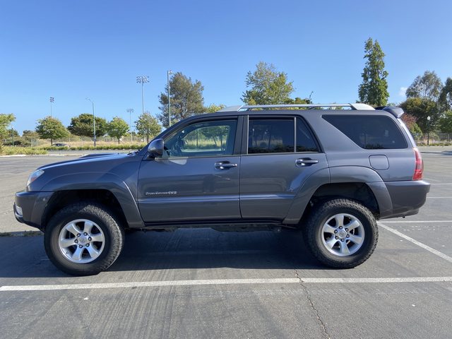

Got it, I’ll see if I can squeeze in somewhere later this week then. Just nervous because I netted a little over 3” (unsettled)in the front, set the strut at 1.75 but it leveled me right out. I think the rear is about 1/4” higher technically, I’d have to double check what I got for measurements. Here’s a crappy phone pick though IMG_4627.jpg

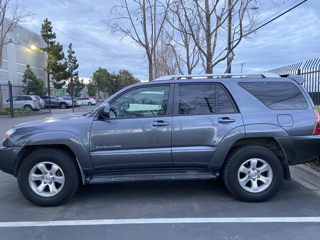

2005 V6 4x4. Original x-reas system was starting to go, rear right shock was leaking(DEC 19'). Had already been digging into this thread like crazy, tons of great info and setups, so thanks all! Had the job done mid March this year.
Bilstein 5100 all around, front @ 1.75
OEM FJ coils front and rear(2012 4x4)
1" Cornfed rear spacer
1.25" Spidertrax
265/70/17 Hankook DynaPros for now....
Measured from ground through center of wheel to fender.
Before
Right Front - 33.75
Left Front - 33.5
Right Rear - 36.12
Left Rear - 36.25
After
Right Front - 36.5
Left Front - 36.25
Rear - 37.75 both sides

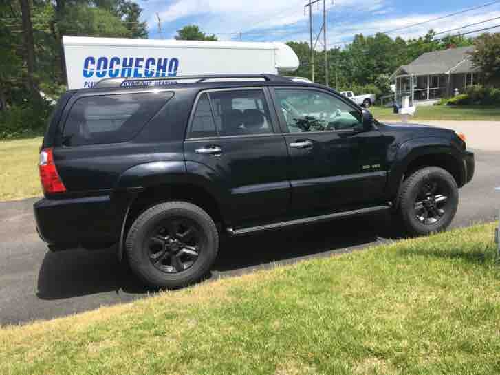

Just completed the swap over the weekend.
I deleted the XREAS system with 5100s all around. I left the rear springs stock and swapped just the fronts with new OEM 4x4 FJ springs. I set the clip on the bottom/stock setting. As noted from other members, I gained, pretty much, exactly an inch of lift with that combination.
