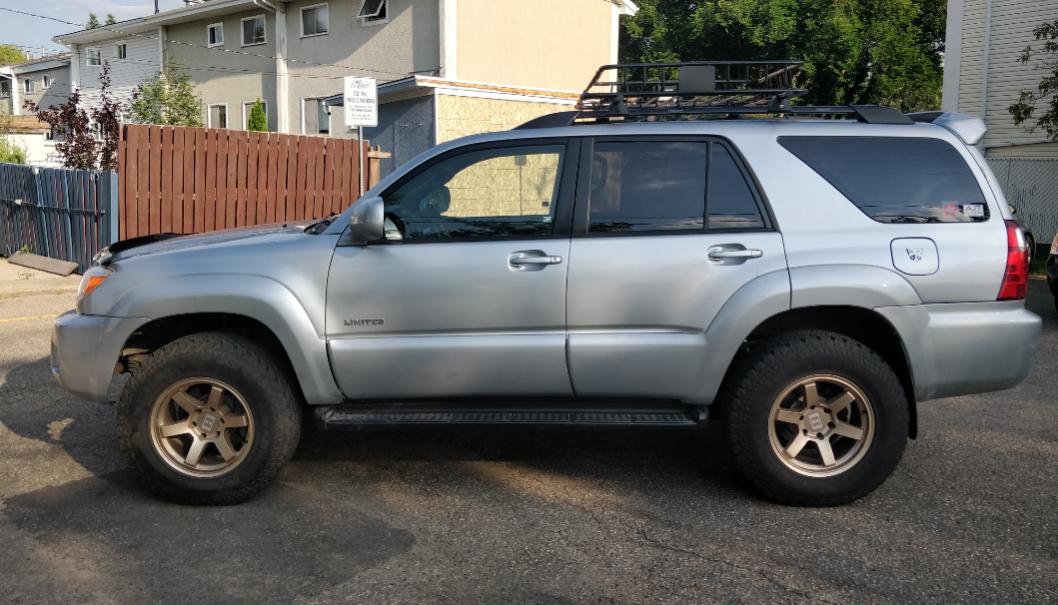

You netted about 3”. Do you need aftermarket UCAs when setting at 1.75 with 4x4 FJ coils?
I thought I settled at .85 but the 1.75 setting looks so good.
If you haven't pulled the trigger yet, I'm glad I went with the 1.75 setting over the .85. No issues with UCAs or alignment, just some minor fender lining rub in the front. Easy fix w/ a heat gun. Also removed mud flaps and running boards. Picked up some General Grabber ATX 265/70/17 last week and love the look and results. MPG is down slightly but still averaging about 18-19 MPG per tank. The only thing I would have done differently is a 1.5" rear spacer instead of a 1".

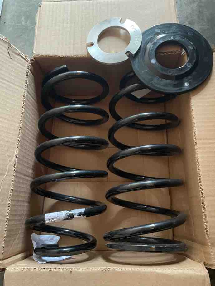

I recently picked up springs from a 2010 FJ. The fronts were still assembled so I rented a spring compressor and took them them apart today. It appears one of the front springs (left) has more coils than the other (right). I count 8 coils versus 7. I assume the longer sprint helps correct the drivers side lean. Does this mean I won’t need a spacer? My trucks a V8. Thanks!
Yup, got that. Wondering if with the heavier V8 if I’ll still need a spacer to correct drivers side lean?
You have to figure that the extra weight will effect both sides equally. IIRC the driver-side spring has a slightly higher rate then the passenger side. I think you'll just see a lower amount of total lift then if you had a v6. I could be wrong though but I wouldn't add a spacer just to the driver side.
