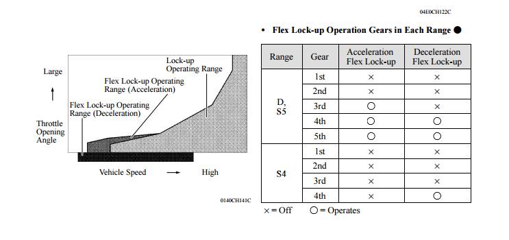

As good as that document is... it is still vague about lockup operations. My guess would be it can happen in any gear.
It seems to indicate that a full lockup will happen at "high" speed with no definition of what that speed is. There is no mention of full lockup as it relates to gears. It does indicate throttle position is a major factor, so high speed + any throttle position = full lockup. low speed + low throttle position = full lockup.
Bottom line, you are only going to get full lockup while towing if you somehow maintain a good speed (nearly impossible with a t4r on steep grades)
The flex lockup is pretty well defined. It says it only works for decel in s4.
In D, or s5 it will work for accel in 3-5, and 4,5 for decel. The flex lockup seems to be an in between state (not what you really want to cool the trans).
Sure would be nice if they gave actual speeds and TP.

I hate to sound negative, but I really don't think there is much you can do on a really steep grade. More gas in D or S5 will only put it in "flex" lockup (which seems like it would not help much). Momentum and speed appear to be key, but hard to do on a sustained climb with such little power on tap.
