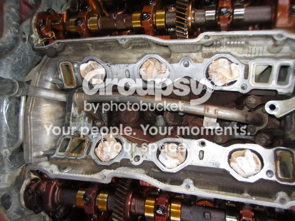

The coolant bypass hose is a somewhat common leak with age, and it's in a real tough place to diagnose. You can look for a leak behind the motor between the firewall where a plate stamped with an X is, under the heater hoses. You will only see coolant coming out from under that plate if it's leaked bad enough to fill the block valley under the intake manifold. I just replaced mine, it leaked and filled the valley and poured out back over the tranny bell housing once it finally went. I had a coolant smell for a while before it just broke loose altogether. The repair was actually quite easy, just slightly time consuming. All my intake plenum and manifold gaskets were toast anyway so it was a plus replacing all of those as well.

How did you repair? Was it just a leak in the hose, or where it connects to the bypass valve?
The pipe itself seems to be made of steel, and was leaking at the flange where it connects to the block. That connection is at the very front of the motor though, under the manifold. Replacing the pipe wasn't necessary, but mine had corrosion and I felt it was the best thing to do in my case.
This is not my image, but it shows the hose very clearly.

I'll give it a look when I do the valve covers next week. I've got a leaky camshaft plug too, so I'm doing gaskets, plugs, and plenum gaskets. I'll get a good look in there when I do.

I forgot to mention the hose is sealed with a small amount of FIPG. There's not really a way to tell if there's a small leak in there without pulling the manifold off, or just wait till it gets worse like in my case.
