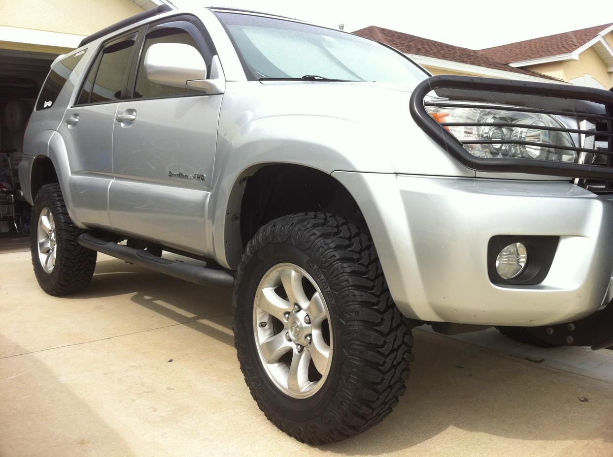

Also here is the picture.
I was doing the math for what the load for a P265/65R17 stock tires at 32 PSI and what the required PSI for the P265/70R17 for the same load which turned out to be 35 PSI. I then did the same thing for my new tires which is turning out to be about 53 PSI which seems really high.
Nice looking tires.
