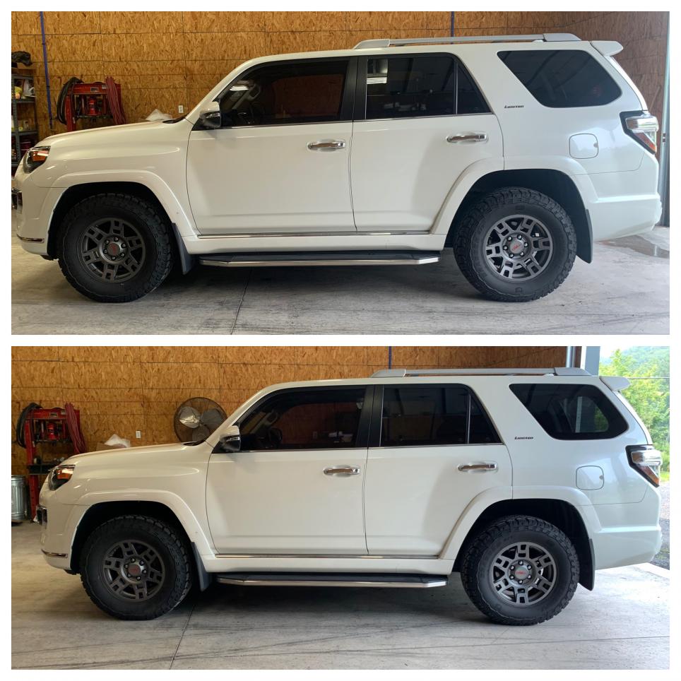

Installed the cornfed 1” front lift spacer I asked about it the previous post. Still have a little bit of rubbing in reverse but it helped. I think I’ll just take the heat gun and remold the plastic in the areas it rubs now. I figured this wouldn’t completely solve the rubbing for me but the 4Runner needs an alignment anyway and for $50 I prefer it to be a little more level.
Here are before and after pics in case anyone is interested. Top is before, bottom is after. Photos are leveled through the wheel centers as best I could get them. Front height measurements at center of wheel before were driver: 34 1/8 passenger: 34 1/2. After the spacers the measurements are driver: 35 3/8 passenger: 35 5/8

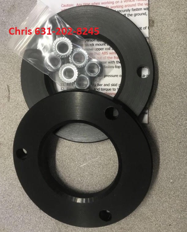

A 1” front leveling kit is 1/2” thick not 3/8” The 3/8” thick spacer would provide .75” lift. There are no 9/16” thick spacers available. Please post a picture after install from the side as well as a picture of the top of the shock showing your work. If you got 1.5” lift there was likely an install error like torquing your lower control arm bolts with the truck in the air rather than off the jack at ride height. To achieve 1.5” lift from a top hat spacer, the spacer would have to be 3/4” thick which is impossible. The studs on the shock are not long enough for that, you’d never be able to bolt it back in.
I have some 1” spacers coming and a shop installing them with 17x8.5” 0 offset wheels and Toyo Open Countries in 265/70. Will be subtle but between the level and kicking the tires out a little bit from the stock +15 offset wheels I think it’ll be a good look.
For anyone interested in a 1" front kit, or any other kit, please give me a call, text, PM 631-202-8245
