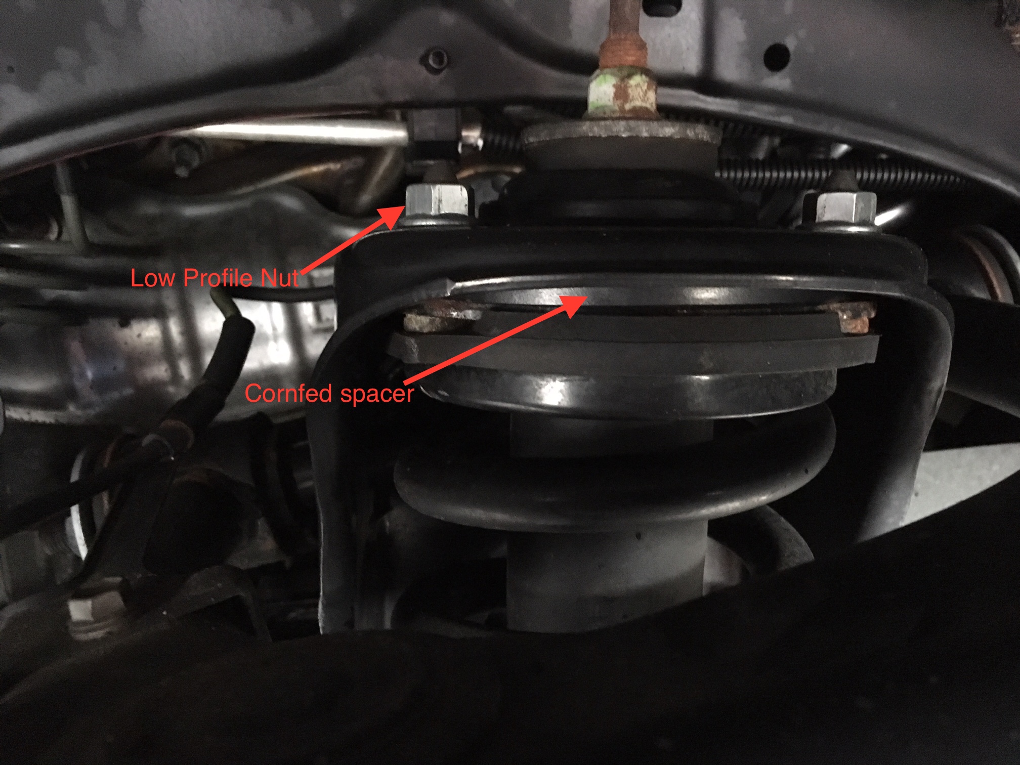

Yep. 6 nuts, 2 spacers, instruction sheet, and a sticker.
Here's a shot of the spacer installed using the low profile nuts. Looks like any thicker and the nuts wouldn't fully thread onto the OEM studs.

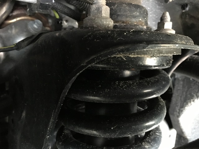

Hello -
New to me 2018 SR5 Premium. At the risk of totally beating a dead horse I would like some thoughts/opinions.
My initial plan is to do suspension lift etc. etc. when my kid finishes school (fingers crossed). For now I want to lift/level front end and add 'better' A/T tires. I am thinking the 1" spacer for now but where I am struggling is that this truck seems to not have as much rake as I have seen on others. But I am assuming it is 100% stock.
Can someone comment on pic and confirm it indeed appears stock.
Thank you.
