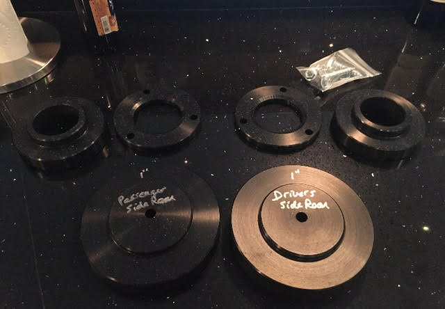

It can be somewhat confusing but a physical 1” sized spacer will lift the front 2”. IE, the spacer I installed measured .5” but it lifted the vehicle 1”.

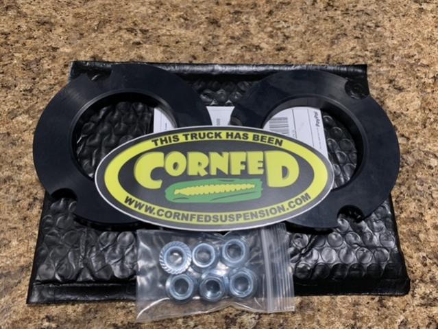

1" Cornfed spacer on 2019 Limited
Installed the 1" Cornfed yesterday on my 2019 Limited. Install about 1.5 hrs, spacers came with shorter nuts to install. Straight forward, and sits level now. A subtle change but now the rake is gone. Now what direction to take with the stock 20" wheel/tire setup...

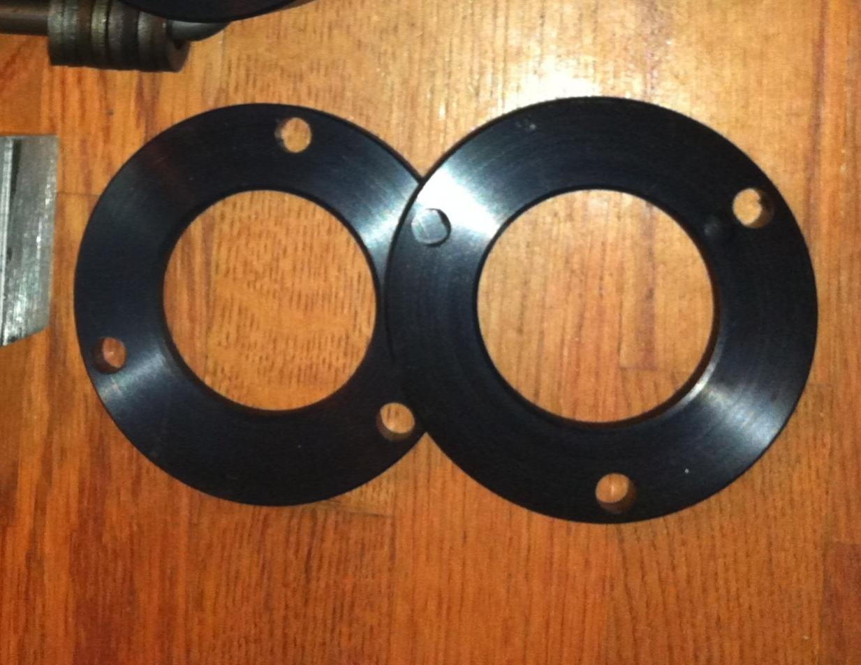

9/16" thick
somebody mentioned that these are only 3/8" thick but mine are 9/16" and I haven't installed them yet. I am a little worried that mine are thicker than they are supposed to be and I won't be able to get the nuts on or that Ill be nose high. Anybody else measured theirs before install?
