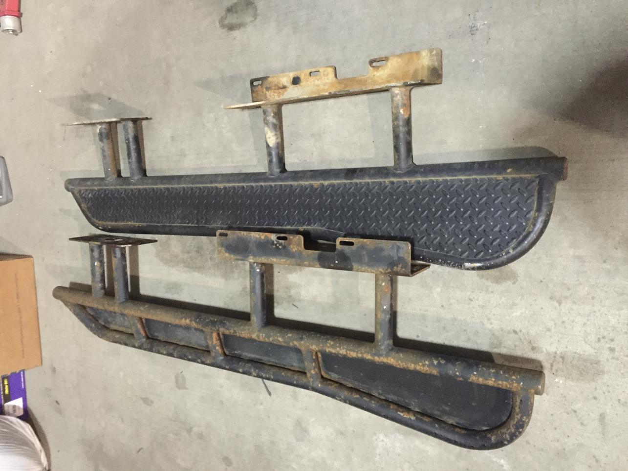

For both Sliders to be sandblasted and LineXed they want $550-$650 depending on how easy the rattle can bed liner comes off.
Looking for opinions, it seems high to me. I have 1 more quote request out and if it comes back around the same I will evaluate my options
Sliders are Budbuilts w/ bump out and full tread plating
The goal is to coat the sliders with something that will hold up to normal use as a step and the road conditions of the upper Midwest better then my original rattle can job and be as reasonably priced as possible. I do not expect any coating to actually hold up to use as sliders but that should be few and far between.

I got my 2004 Tacoma bed Rhino lined for high $400's. Not sure if that's apples to apples, but a reference non the less.

They are mild steel with no special metallurgy or coating to make them rust resistant. No matter what you do a nice pointy rock is going to get kicked up off the road and start the whole process again.

I would't Line-X them. I'd sand it down primer coat x2, frame paint coat x2, reinstall. Touch-up any chips later on.
If I had extra $, I'd Powder Coat.

That's a horrible cost to LineX those. You can get cheaper quotes, probably in the $300-$350 range.
Or you can drop $80 on an Als Liner kit on Amazon and roll it on yourself. Rattlecan bedliner sucks, but the rolled stuff is pretty durable. You'll have plenty to lay it on thick and have some leftover, and it'll hold up to road gravel and careless door dings. Just be sure to prep really well and use a rust eating primer before you apply the adhesion promoter, because any rust left under there will spread.

These photos point out the problem with the diamond plate treads. The thread plate is going to make it much harder to sand off the rust.
I'd sand the rust off and paint with anything. My first choice would be brush on primer and paint from Rustoleum. I prefer to paint with a brush over spraying for small shapes like this, partly due to environmental concerns like the waste of overspray and propellant and spray cans that can't easily be recycled.

Yeah the problem is cleaning those looks like it's gonna suck. That's probably more than half your cost. I was told they could line-x my entire 4runner including aftermarket bumper and sliders for 2500 but mine are still in very good shape. I would see if you could get a cheap quote from a machine shop on cleaning up the rust and coatings and then take them already prepped to the line-x place.

I would use POR15, if done properly it's practically bulletproof. Those that had chipping or flaking did not prep correctly so it didn't adhere as it's supposed to. Or you could have them powder coated which should be cheaper then Line-X
