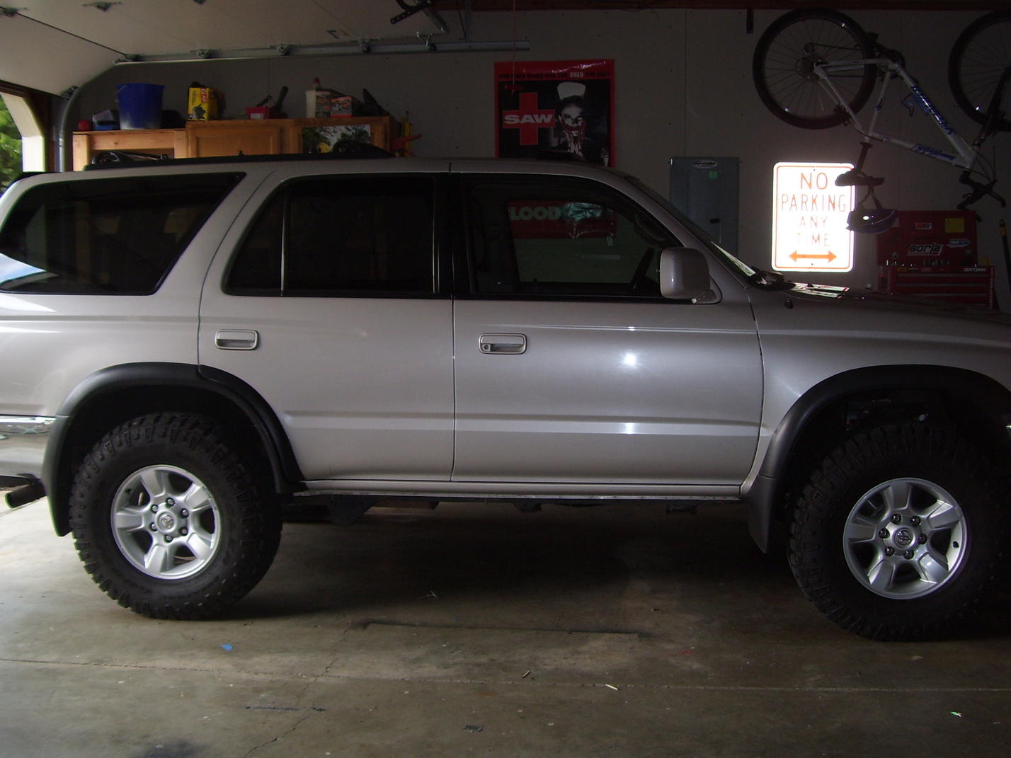

'<-----------99 with tall coils
Can you tell by looking at my truck if it has the taller coils? It is sitting on the 265/75's that I mentioned earlier.
Also, I was thinking to eek out a little more lift without much trouble would be to add the trim packers at the time of install. This way it would keep the softer riding springs. Anyone else do this?

I checked the color code of the springs today and they are the tall ones.

I love the stance you currently have with the 99 tall springs. For sure will be my next modification...
