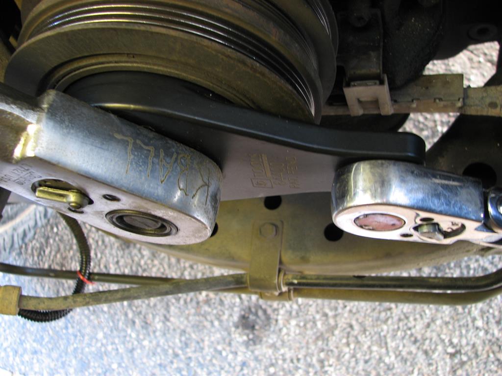

Pretty sure they all work except the next to last which is for the camshaft and the last which looks funky. Stick to the first four.....

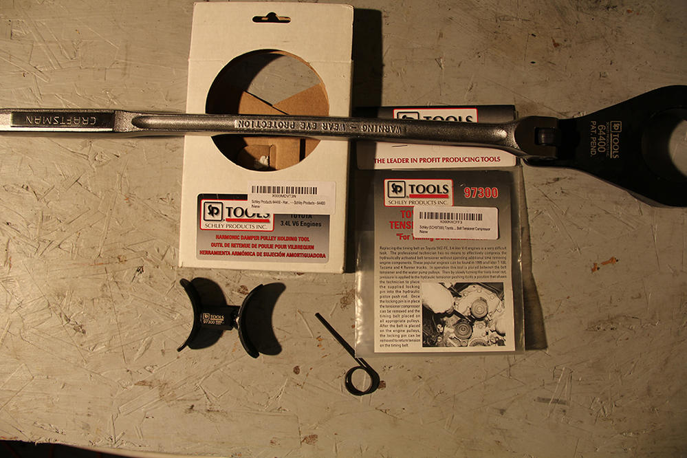

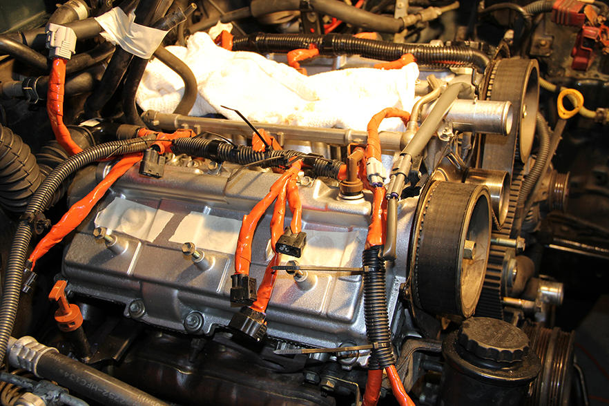

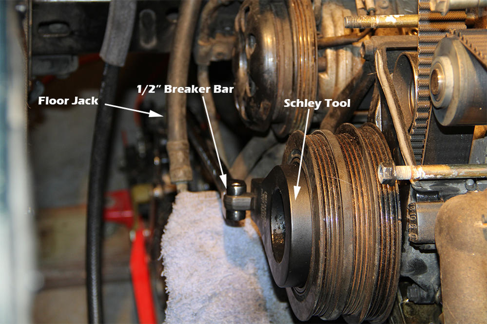

There's a lot of homemade ones that work great. I purchased a Schley from Amazon - Schley Products 64400 - Harmonic Damper Pulley Holding Tool. I also purchased the Schley (SCH97300) Toyota Timing Belt Tensioner Compressor. It's cheaper to make one. Soak the bolt overnight and the balancer will "slide " off the crank without a puller. If you plan on changing your cam seals you need to loosen the bolts while the tool and the belt are still attached. Pick up an inexpensive seal puller. Tape and cover with rags all holes...etc. There's a fella on here right now who is trying to fish out a washer that fell into his head and is lodged in a valve opening.
EDIT: It also helps to take a ton of photos to; 1 - put the dang thing back together correctly and, 2 - share with the community when someone asks for help. hehe
EDIT: I forgot the Amazon link: http://www.amazon.com/Schley-Produc...im_auto_2?ie=UTF8&refRID=1JPQRJ69FJYJ7Z3J6BV2

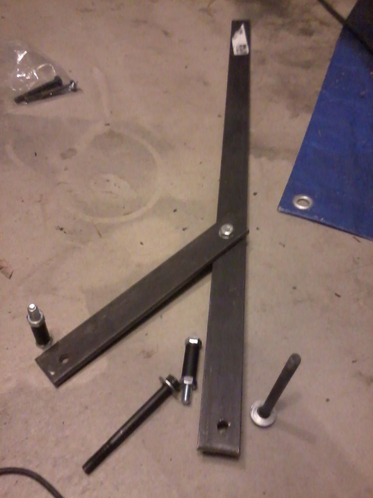

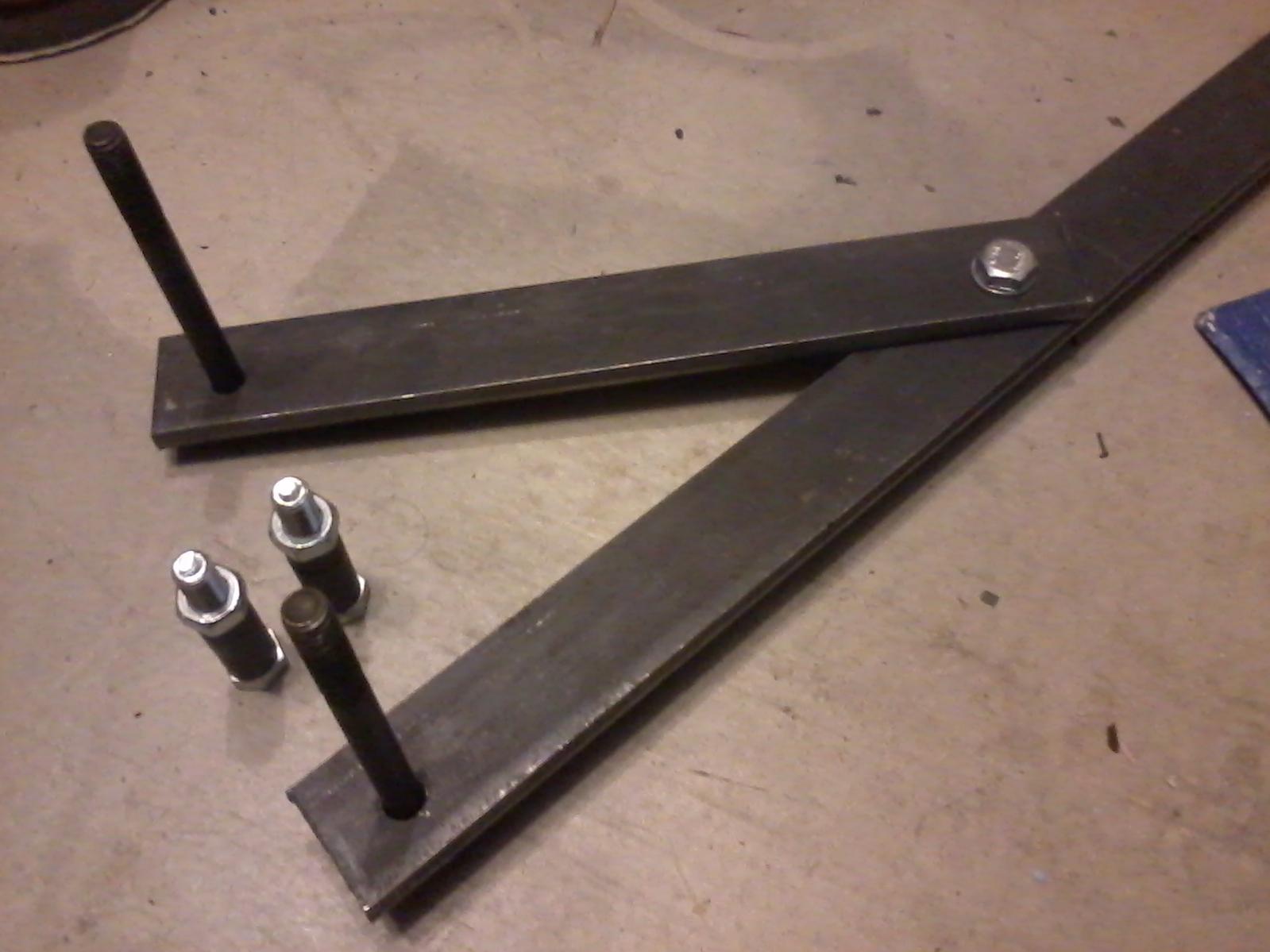

Here is the one I made for less than $15 from home depot. Used a 36" long bar of steel and chopped it into 9" and 27" pieces, then drilled some holes. Have the long bolts for the crank pulley and the shorter ones with nylon sleeves for the cam pulleys. Worked very easily and am using it again this weekend to help a buddy with his TB. Would highly recommend making your own, I have the Schley tool for the 1uz and it was not cheap and works no better... actually my custom tool works better. Not the best pics but you get the idea.
