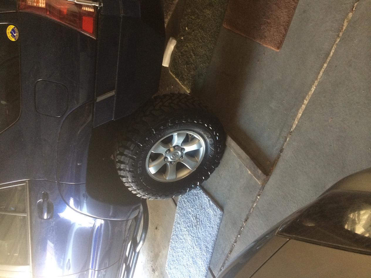

Finally got my new tires
It should handle great off road see how it sticks to the ground at 90 degrees :thumb3:
Lol
Don't know what happened to the picture
