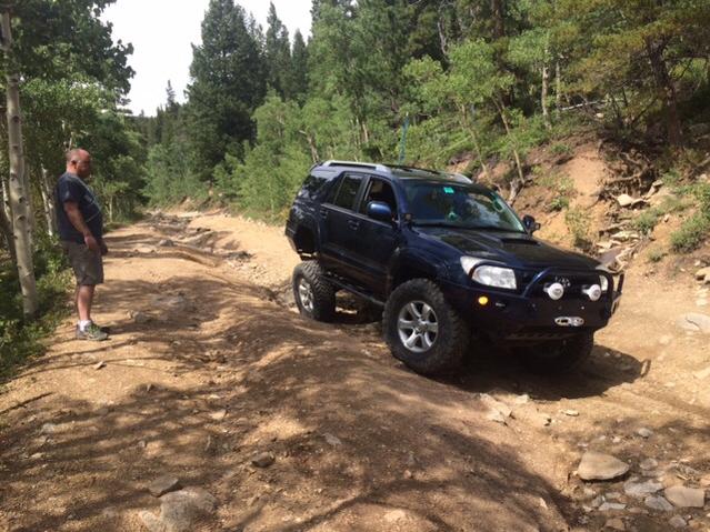

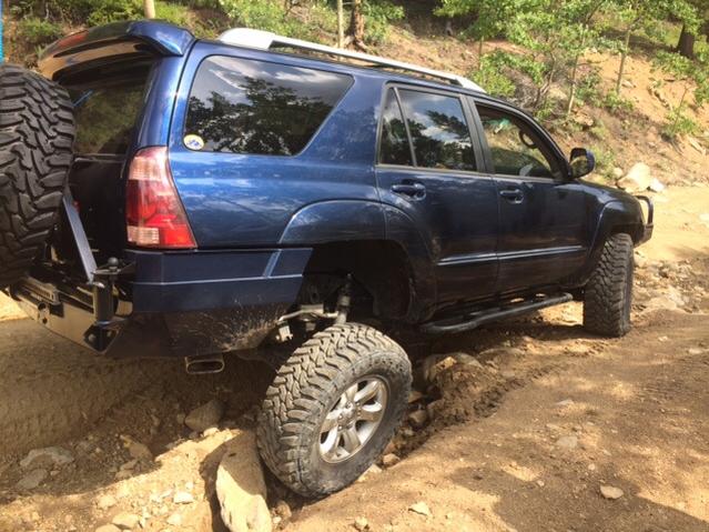

I was checking for clearance and trying to measure for limiting straps but I still need to go up another 4-5"

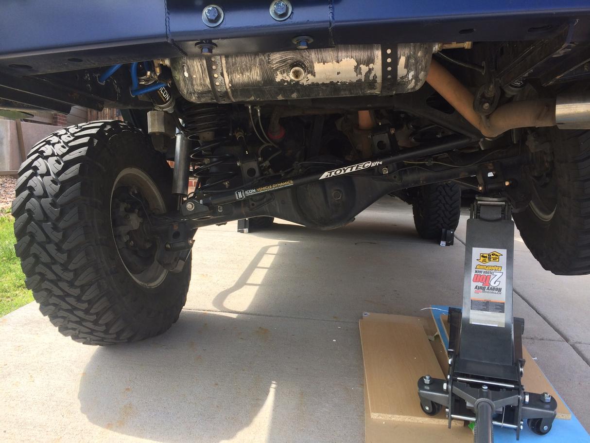

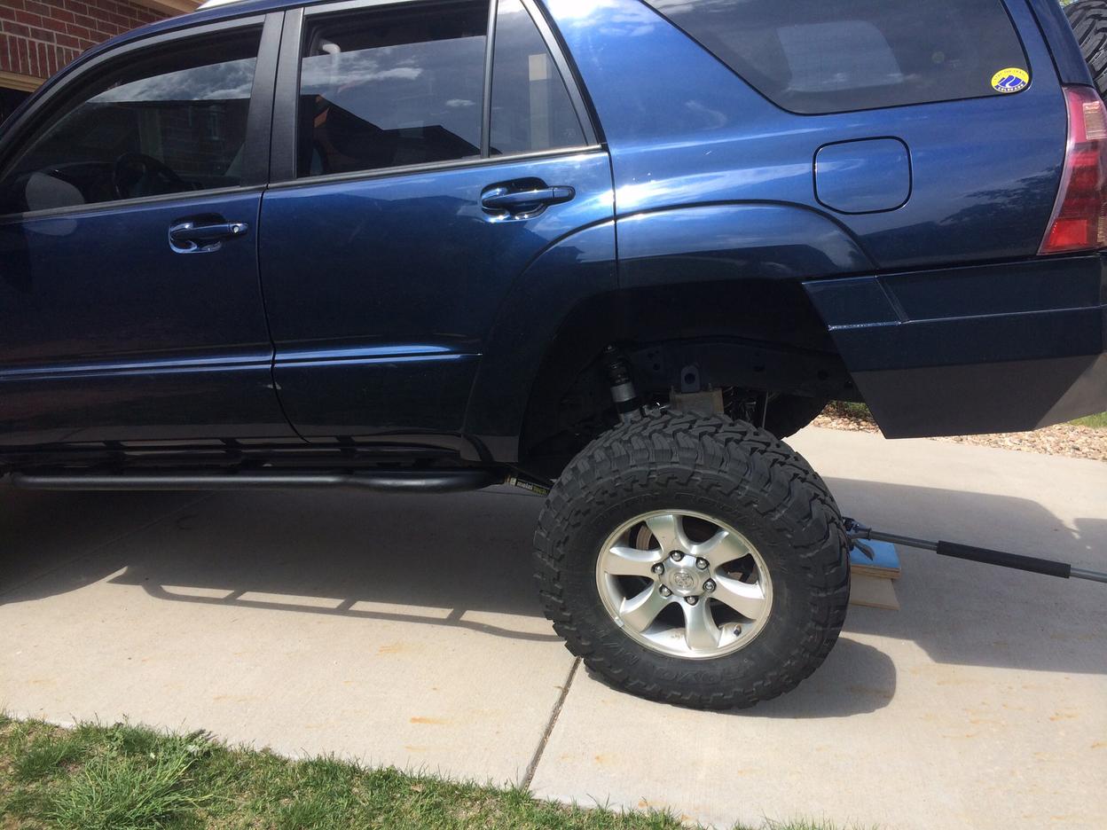

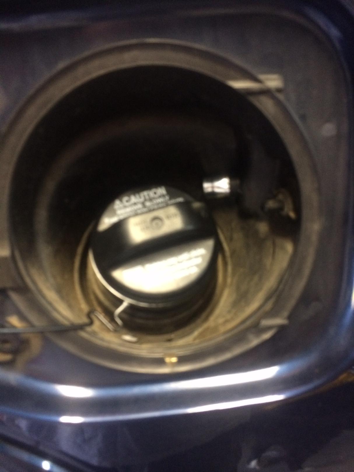

Ok so I finally got around to the rear vent mod I didn't like the way the vent looked next to the filler so I did it different

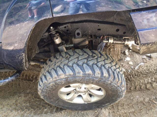

A special thanks to Scott at addicted off-road for relocating my rear upper shock mounts

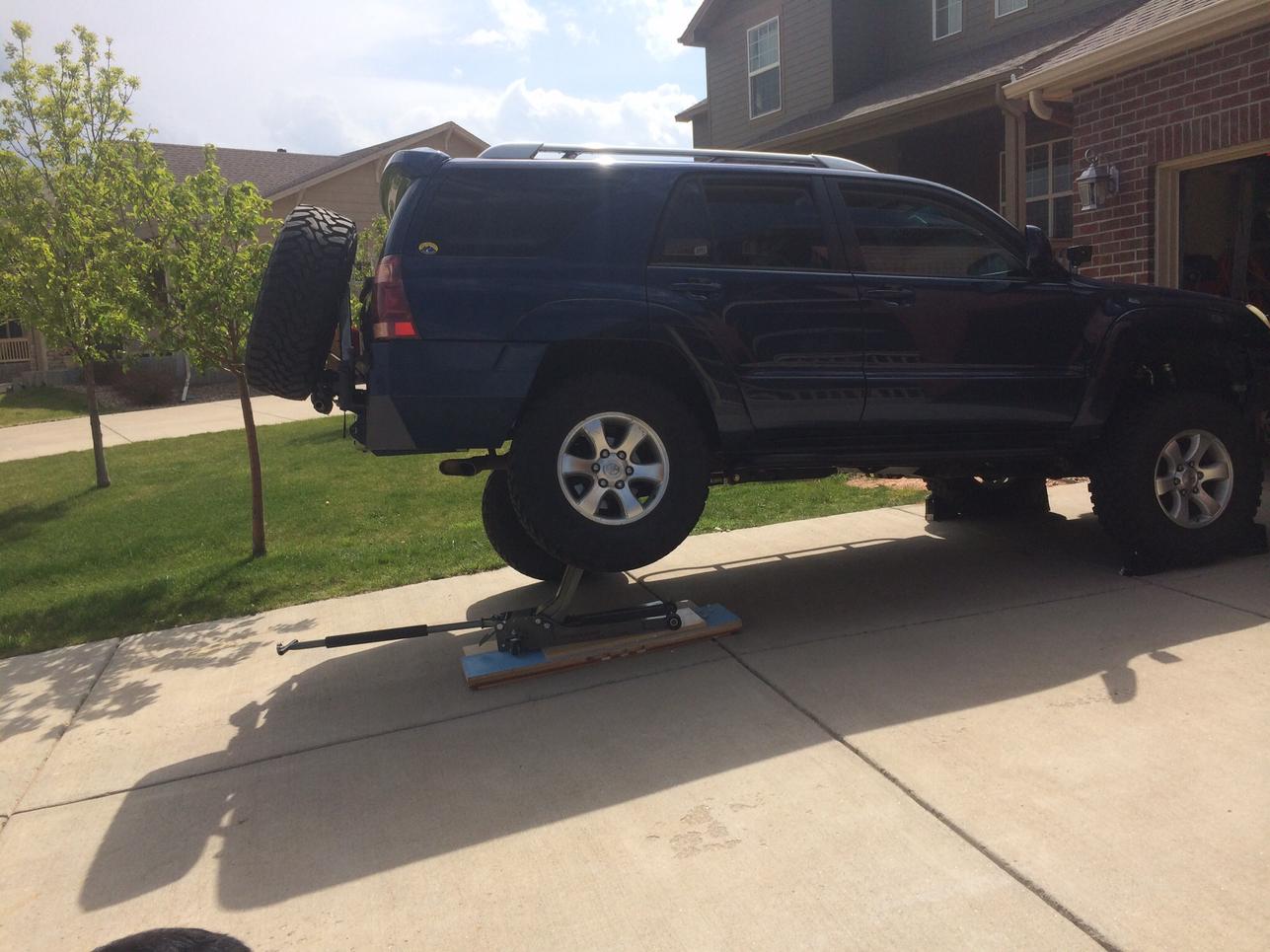

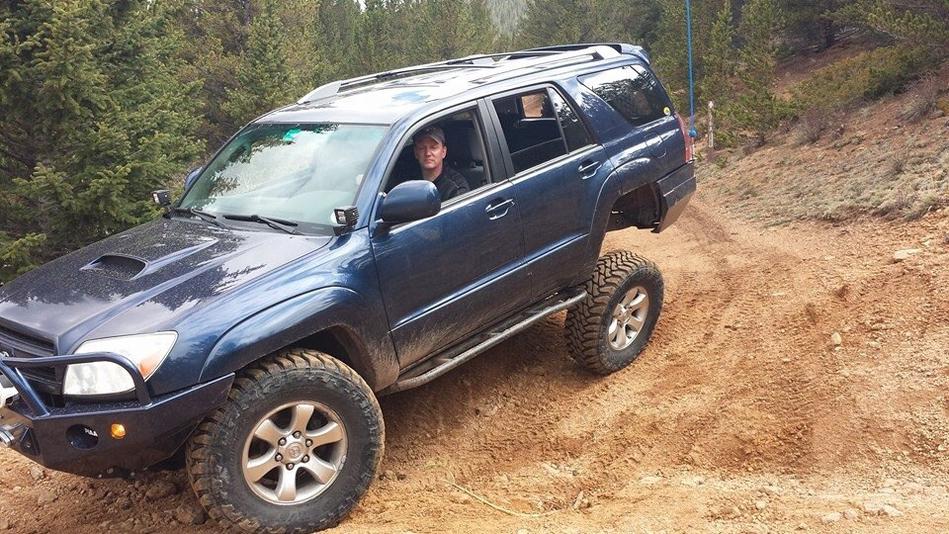

I got the truck to balance on 2 tires and if you watch the front starts to go backwards as the rear rolls forward
<iframe width="480" height="360" src="http://s1291.photobucket.com/user/crashman105/embed/slideshow/"></iframe>

you have a 05 like I do so to get the remote shocks to work without breaking you have to get the rear shock mounts moved it took me 3 sets of broken shocks to figure this out

Oh, I seen the broken shock, didn't realize why. What did you do to move the mount?
I had to bring it up to addicted off-road and Scott cut out the old shock mount then boxed the opening an welded a new mount to move it 1" out from the frame
I needed the 2.5" for the weight of the bumper and gear when I'm fully loaded I tried the 2" shocks but the rear bounced all around to the point I heard the bumper slapping the water when I did the water crossing and when I came down off a ledge or rock I would hit the 2.5" handled it much better!
I did upgrade to the compression dampening control shocks (CDC) so I can play around with them but now I have something new to learn about lol
