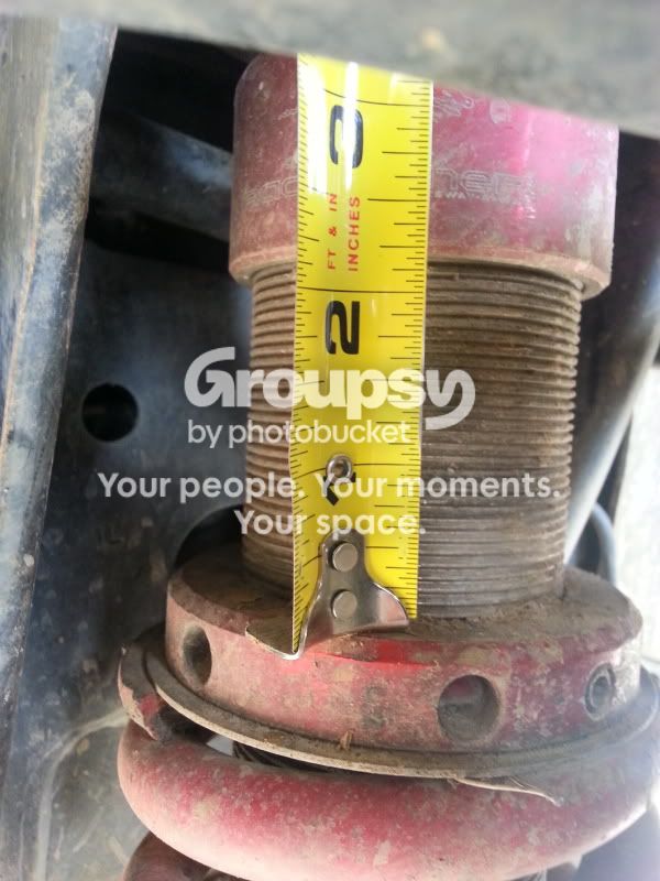

Here's the measurements. Just keep in mind I have a bit more weight up front than you do.
Driver
20130215_115633_zps1a028741.jpg~original
Passenger
20130215_115725_zps25d8e8a8.jpg~original
Damn that's a lot of preload. I thought mine was more, but it looks like I have a good amount less than you guys. This seems about right since I have a stock bumper and no winch. Hopefully my Elite won't drop me down too much.

I just measured again and it looks like I have 1.75" on each side.
ARKRWLR -
It looks like you only have about 1/2" more preload on your setup. Your current setup sits at about a 3" lift over stock? how much shaft is showing on the coilover? That should give a better idea of how much it is lifted over mine. You have the extended travel 2.5" as well correct?
As far as weight, you have me on the bumper by 40+ lbs. Think the addicted offroad is about 65lbs. Do you have a winch? If not then our fronts are probably pretty similar with my 9000lb and synthetic line.
I should have Skids on soon so that will add some more weight to that front end to settle it down.
Your current Preload is where mine is at now. You may be running a longer spring than SAW uses so that may change things.
I may dial mine to 2.25 and see where that settles me. I don't want it to be too stiff so I only want to throw in enough to make it work.
No, the Donahoe's use a 13" coil as well. I'm almost at 3" and less weight than you so it makes sense. I'd go at lease 2.25".
I think I will go with 2.25 to start. Only take about 10-15 minutes per side to put back together and pull apart if I need to adjust a little more in. I may just need to get more weight in the back of the runner to keep the rake down.
My main focus is to keep the CV boots alive and not preload so much that it won't stuff easily when wheelin.
It looks like you only have about 1/2" more preload on your setup. Your current setup sits at about a 3" lift over stock? Pretty close, it's within a .25"
How much shaft is showing on the coilover? Will measure later. That should give a better idea of how much it is lifted over mine. You have the extended travel 2.5" as well correct? Yes.
As far as weight, you have me on the bumper by 40+ lbs. Think the addicted offroad is about 65lbs. Do you have a winch? No. If not then our fronts are probably pretty similar with my 9000lb and synthetic line.
They probably are. The bumpers are probably close to the same weight as well. I think the ARB might be a little more cus of tubing, but not much. I also have the Skid-Row skid which is awkwardly heavy. The BAMF front LCA skids are going on this weekend. So it all adds up. When I get a winch I'll have to adjust some more.
ok cool. Looks like 2.25" threads showing will be a good place to start and should yeild another 1.5-2" with my current setup.

Well this weekend was productive. I finally got the front suspension spun down.
I took it to 2.5" of threads. That puts it at .25" more than ARKRWLR.
Measurements are about 1.5" difference front to back now and I think it sits perfect. There is no more tire rubbing on full lock, or on the firewall. Can't wait to get it in the rocks and see whether there is rubbing under full compression.
