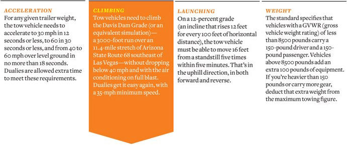

Sae j2807
Toyota owners manual shows the 2013 as meeting the standard. Found this online after a Google search for sae J2807.
Ford, General Motors, Ram, and Toyota have agreed to adopt SAE J2807 for the 2013 model year, and Nissan will soon follow.
