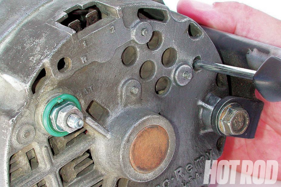

On these old GM alternators you can short out the regulator and full field it with a paperclip through the back...chances are the water is doing that for you,,it's an old way to test output on a bench...I think you can put a touch of sealant on the back hole that does that...I just can't remember exactly where that spot is to seal up...I can look at one in the garage and see if I can find it.
Snagged this photo from online, can you point out which hole should be sealed?
This is where it is on this GM that I remember from long ago..I really can't recall where it is on the 1344.
