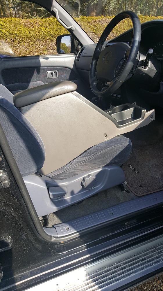

Was there a version of the later centre console that had switches mounted in it?
I've seen one on a build, but wasn't sure if it was a REALLY neat custom retrofit, or factory switches.
The one I bought has a weird and uselessly shaped hole there.
I also found out that they greys appeared to come in different shades (that might be a JDM thing) :frusty: mine is has a blueish tone to it.
Not that I am aware of, But I just did the console swap on mine, and if you cut back the harness to the console switches there is plenty of wire to move the ect, rear window and security switches to the blank just to the side of the steering column on the dash. No wiring necessary, just cut the loom and rewrap it if you want it clean, pop out the blanks and put your switches in.
