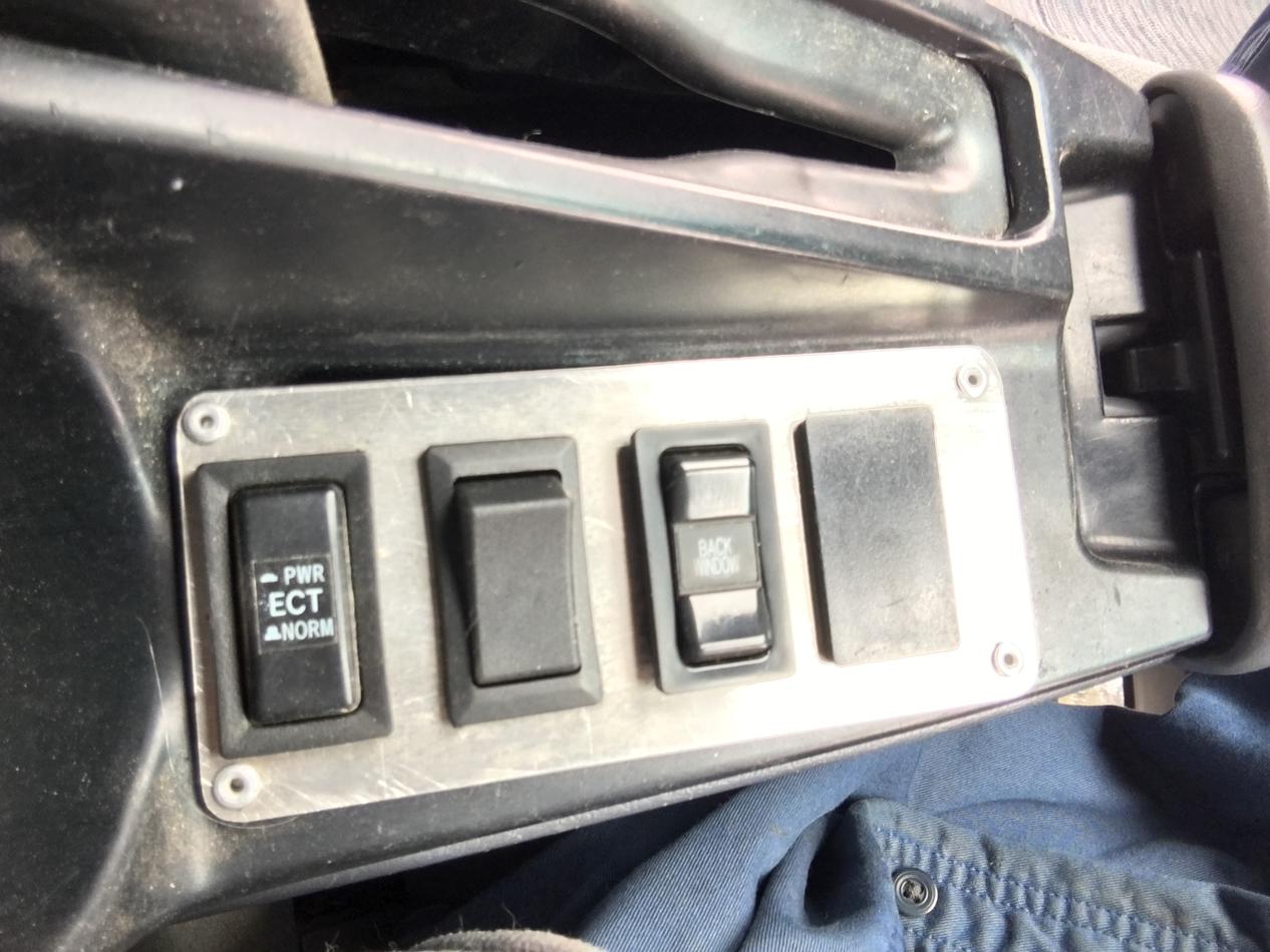

I didn't really want to move my switches when changing to the newer center console, so I didn't.
I made a little panel from a piece of aluminum. I cut out the switch holes with my scroll saw (was a pain!), cut out the little hole/space/dirt collector spot on the newer console, and then used pop rivets to hold it there.
There is one empty space, and the middle one is for my antenna... since I rarely listen to the radio I mostly leave it down, and I can use the switch to put it up when I want.
Far from perfect, and at least my switches are still right there at my fingertips.
Steve
