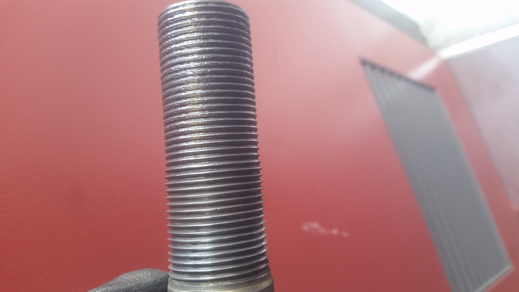

I have had this rig for over a year. (2011 TE) The L rear Johnny joint has been a problem, the jam nut has come loose fairly frequently. It would cause a knocking noise as I accelerated from a stop.

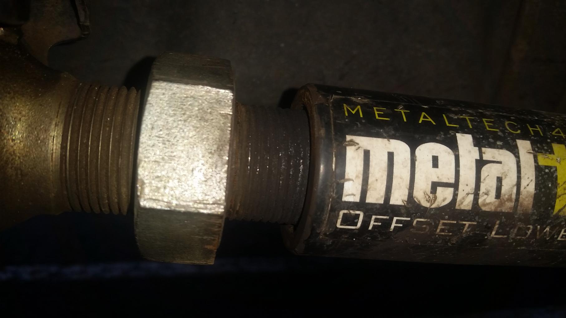

3 days ago I felt a loud pop and the truck swerved and felt it get real squirley I found this 20150910_191742.jpg. Resulting in it basically sliding out of the lower control arm. The threads have worn down in the LCA.
One thought I had was to have it welded on since the LCA doesn't need to be adjusted.
The other was to replace the Johnny Joint if the threads in the LCA weren't too damaged
Thoughts?

Going to talk to Mark on Monday and see what he says. If the threads in the LT lower arm aren't damaged then I'll probably just get a new Johnny Joint. If it is then see if welding might be the cheaper option.

If you buy a new joint, it's going to keep coming loose again, especially with those hammered threads. If you go this route, red loctite will be your friend.
A tack weld or two will keep it in place and would still be easy to grind off if you needed to adjust it down the road.

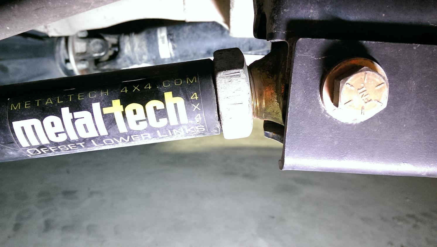

Very confused by this entire thing. What would ever cause it to come loose. The LCA cant spin... due to the rear bushing design. The jam nut is just there to keep it from clocking slightly, not to stop backing out.
Also. I adjusted mine to stock length and there is no way another nut would fit. Mine have a few thread showing, but not many. I did use thread locker.
Is there a reason that people try to push the axle further back. I think the threads are just there as an installation method and maybe to adjust rear thrust angle if it is off. I just figured matching stock length was the best way to go. There are so many threads in there I can't imagine how this wouldd happen.

Right, I just meant very few threads should be showing if at stock length. See pic of mine at stock length.
The nut is just there to stop it from clocking and force the torsional load into the Johnny joint. It does nothing to stop it from lengthening... The threads inside the tube do that.

Reset the Johnny joint (JJ) to the right length with a ratchet strap yesterday, set the jam nut and when I released the strap the nut/JJ popped a few threads outwards. So I reset the jam nut to the that length.
This morning I had to slam the brakes to stop for a light and I heard a loud bang and a lady crossing the street was looking under my rig and said I had a "pipe" hanging underneath. The JJ had completely pulled out of the LCA. Luckily I had the tools to put it back together and drove carefully the rest of the day.
