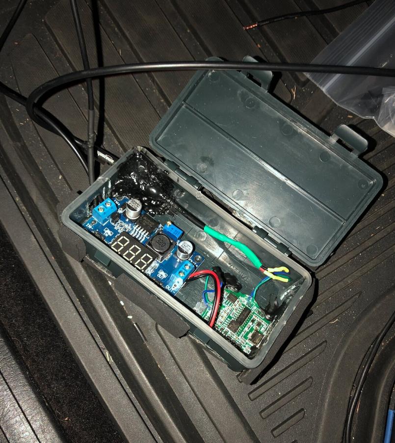

For a while now I've wanted to make the startup chime customizable instead of the annoying toyota ding noise. I did a lot of research and found a way to accomplish this. For now when the key turns on it plays the startup chime once. It will not play again until the key is cycled. In the process I also removed the toyota dinger from the instrument cluster.
Here is a picture of the module I built. It runs off of 12 volts which is reduced to 5 for the logic board. This logic board connects to my computer via usb and I can load any mp3 file thats below 4 mb onto it. I specifically wired mine into my speaker amp so that the sound would play through the speakers.
The module itself tucks up under the dash until I want to connect to it to change the sound file. The logic board has a potentiometer to where I can adjust its gain for the output. this was needed as otherwise the output would be way too much for the signal going to the amp.

haha yeah I have seen that before and it did give me some inspiration. I initially wanted to do something with the oem dinger but it only gets a pulsing voltage so it wouldnt work for this application. I still have a little work to do but I love how mine works as I can delete the old file and load a new one in about 30 sec with my computer. I even had it play toto africa for fun haha

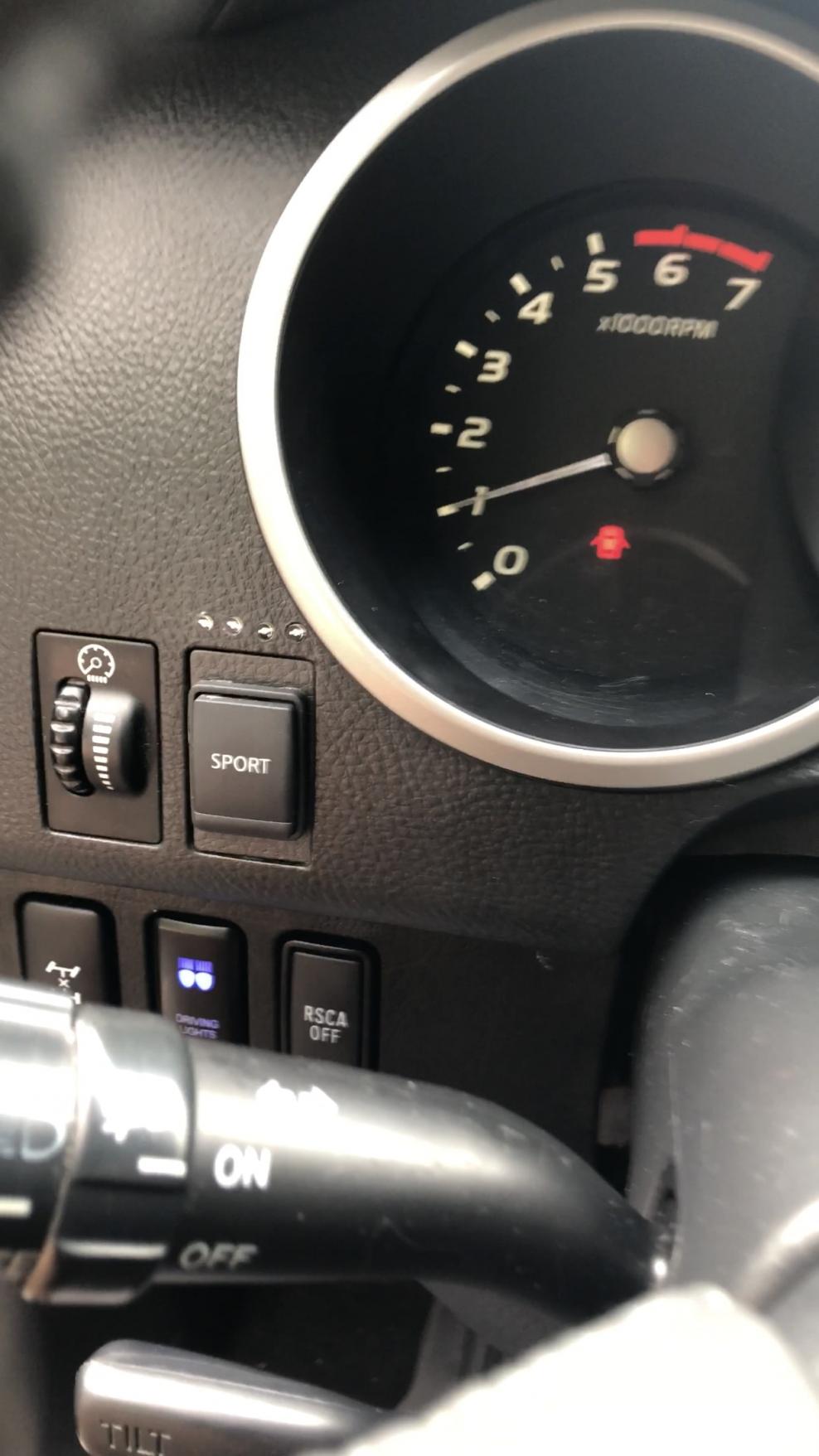

whats the leds next to the rpm gauge, looks like the dei scanner led. i did mines on my pillars, you can see the vids on my channel.

Whats your channel name? and its the sport mode I built cycling on. Heres a pic. Each of the leds represent the driving mode.

its the same name as my username, but i see the leds , it was reminding me of my scanning leds i have wired to my alarm.
