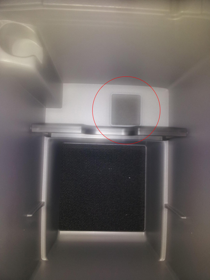

Hello,
I just purchased a new 2013 SR5... love it! I noticed in the front armrest that there is what appears to be an empty port covered by a plastic tab. I'd like to place a USB port (or a pair of them) in that spot so that I can leave my Seagate Satellite WiFi Entertainment hard drive in the car and have it keep its charge via that (new) USB port.
Can anyone here tell me whether there exists a "plug and play" USB solution that can be easily added to that area of the vehicle? Or would this be something that would need to be custom-made? If it would need to be custom-made, I'd love to know where to start.

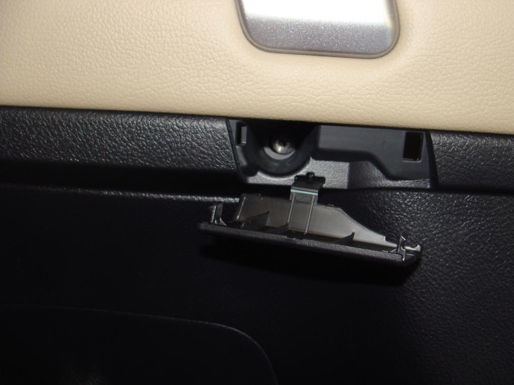

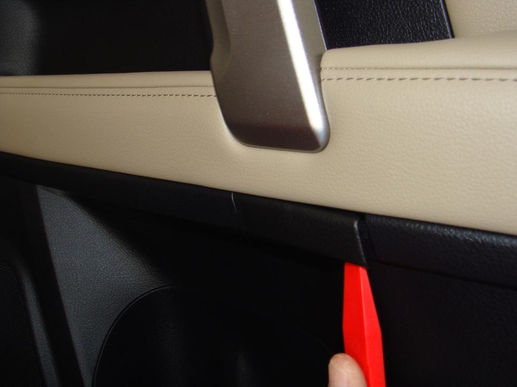

I am assuming (at risk :D) that he means this spot.
So- short answer would be: "No, you can't do that (easily) because there is an attachment screw under there.".
