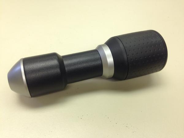

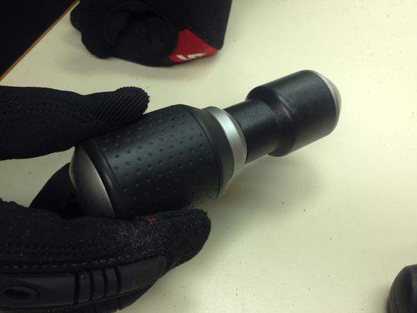

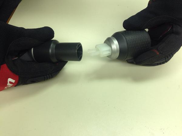

Stock Shift knob
Clips are not very strong, just pull firmly and it will come apart

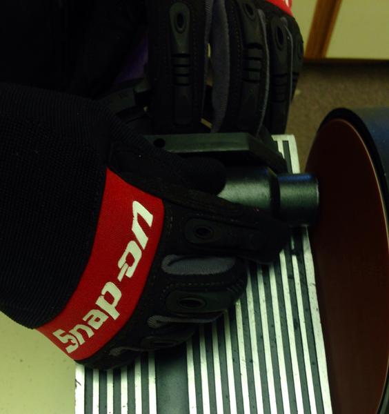

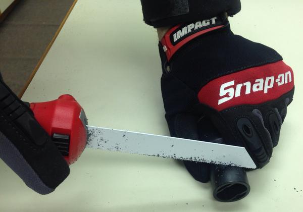

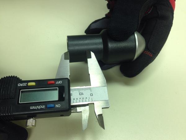

You want to mark 19mm or 3/4 to remove from the center shaft.
Cut on the waste side of your mark to allow for grinding.
You need the cut end to be flush, so I use a sanding wheel, you can also use a piece of sandpaper on a block or flat surface.

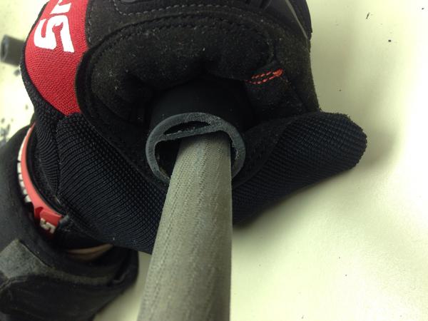

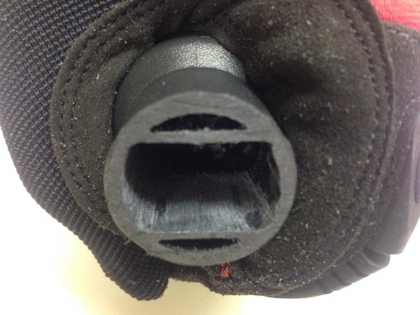

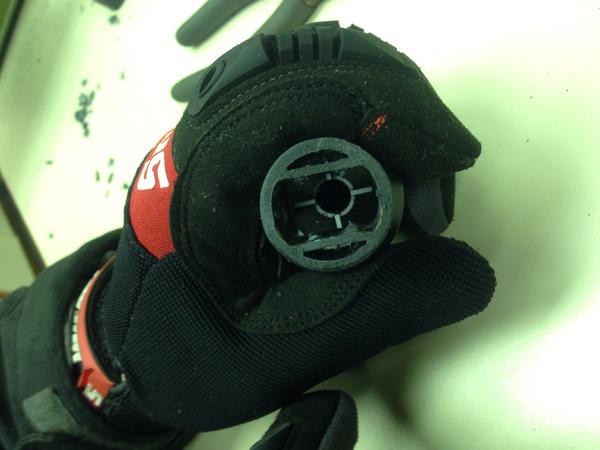

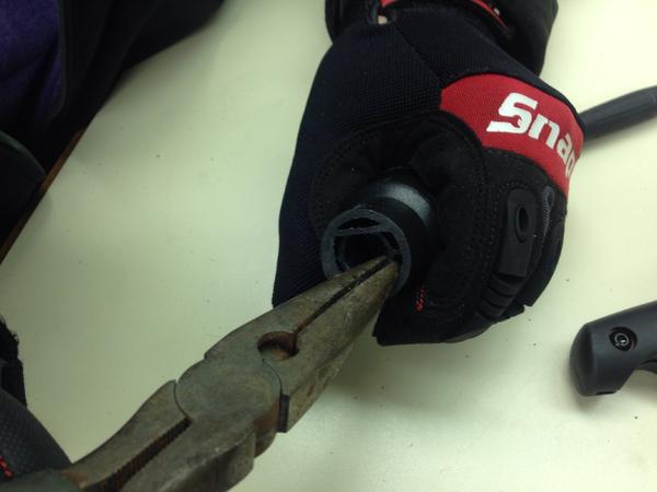

Use a pair of needle-nose pliers to remove the round supports inside.
Here is a picture with supports removed.
Now file the inside to smooth it out so the knob shaft will fit back inside.

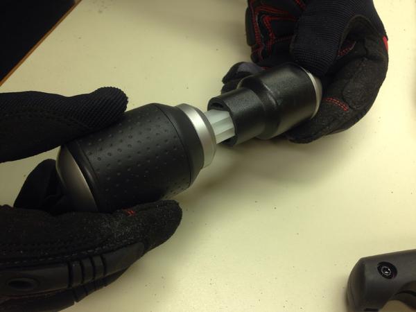

Now slide back together (should be a snug fit) you do not have to use superglue but you can if you feel the need.
Finished product should look no different for the factory FJ Knob.

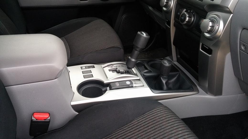

Installed on my SR5
NOTE: these come in silver or black, and they can be made to fit the shorter 4th gen with a little more work. If you have a shift lever these match perfectly, but in any event they look better IMO than the school bus shifter.

For those guys at home that don't have a sanding wheel handy, one other way I can think of to cut this perfectly straight is on a powered miter saw; since the stem is perfectly round all you need to do is hold it straight against the fence and it should come out perfect. The wood blade will slice right through ABS plastics and leave a pretty clean edge if you go slow. I've cut much plastics with my miter saw and great results. Just watch the fingers :)
