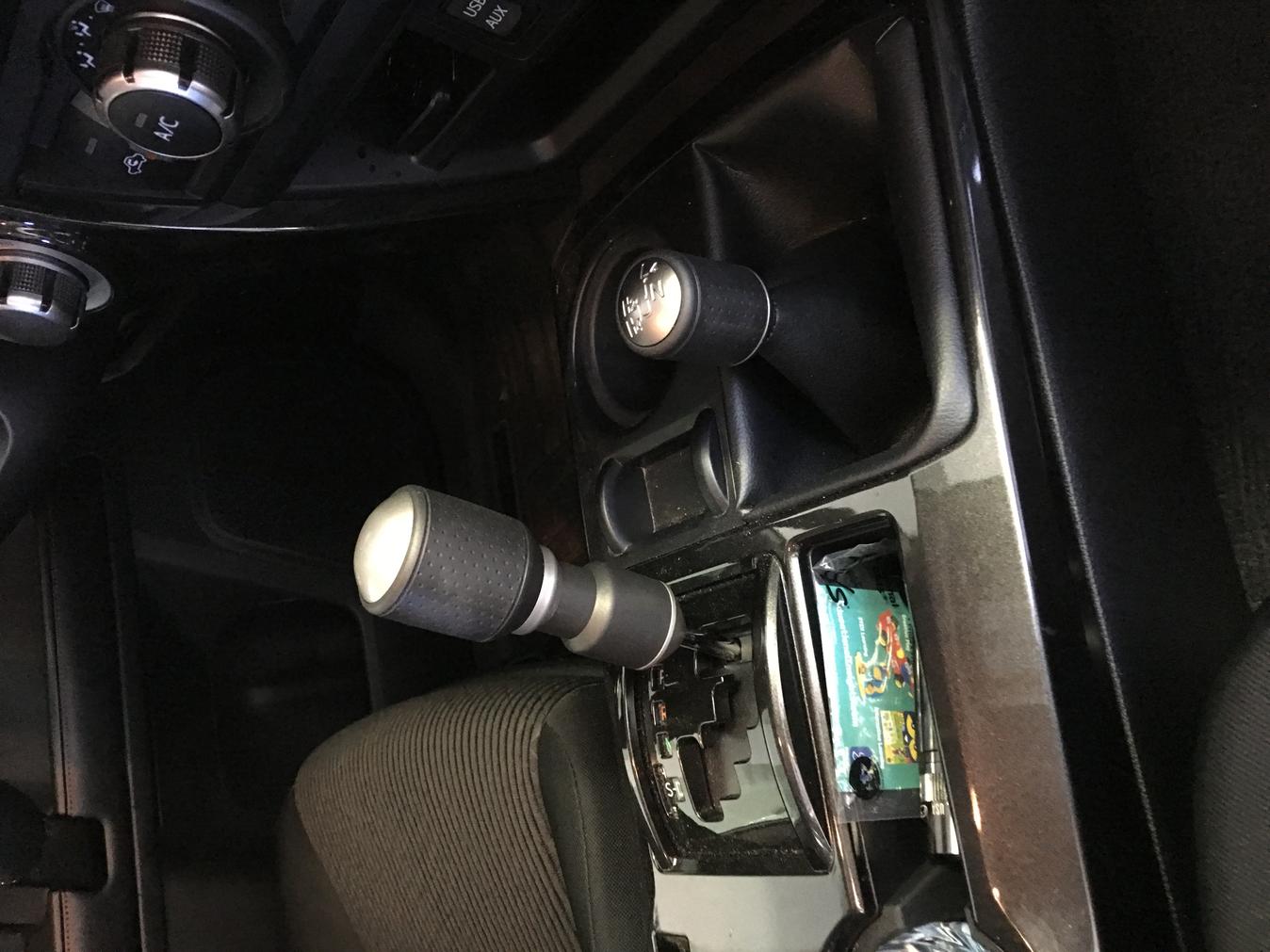

Was debating between just popping off the silver bottom piece and cutting it to fit. Deciding to bite the bullet and go with cutting and sanding. Even with a miter box the cut wasn't quite straight, but I was able to sand it 99.9% flat. Turned out pretty good overall. Just gotta decide if I like this or the TRD shift knob better now.
