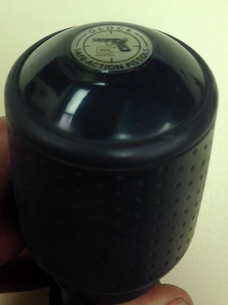

So I got an inch today to do something, so I followed [MENTION=91521]GD2013[/MENTION] idea and put a Glock insert into my shifter knob.
It was a pain, required drilling a 3/4 hole with a paddle bit, then black epoxy followed by a ton of sanding and finally some buffing.
After hitting it with some 3000 grit, I used some compound on my buffing wheel to smooth it all up..... It's a little shiny, but it's one if a kind.
