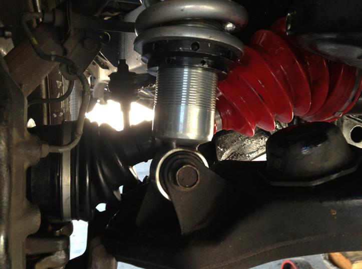

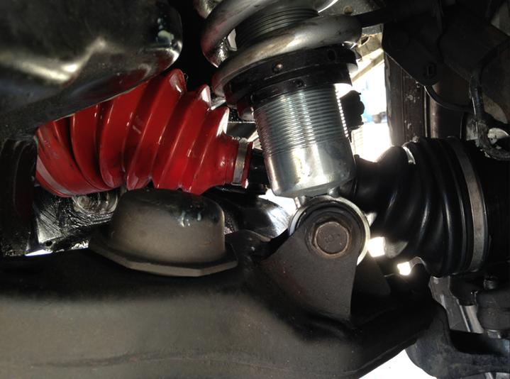

Hey all-
I installed the axles with the extended boots. Coils are lowered to about 9/10" of thread showing below the locking nut. Diff drop is in as well. The boot ribs are rubbing and Im kinda concerned about that. Should I lower the coils even more?!

Sorry to have to say it but it looks like factory boots would have been better.
I don't really get the need for extended boots. I've had a lift over 5 years and one CV boot made it 210k miles and the other is still going strong at 225k miles.
For anyone else who has this problem Id suggest getting factory remans as posted above.
For OP, sorry to read about your issue. What did the vendor say?
I was thinking the same thing, that the factory sized boots would be best. Cvj suggested lowering the coils. I contacted toytec, just waiting for a reply.
I had an issue as well with the bellows on the outer boots rubbing after install. The fella at CVJ (I think his name was Steve), sent me some new clamps for free. I just stretched em and re-clamped. Good to go.

Nope, you don't need to remove the axles. Just cut the clamp, slide the boot out further and turn the wheels to check if the bellows are not touching anymore, re-clamp. Super easy. Doesn't hurt to have someone else to help pull the clamp tight whilst you lock it.

Lowered the coils down to have a 2" lift in the front. Inner boots don't have any issues. Outer boots seem fine when pointed straight. 2 of the ribs touch when the wheels are turned. Should be fine.
