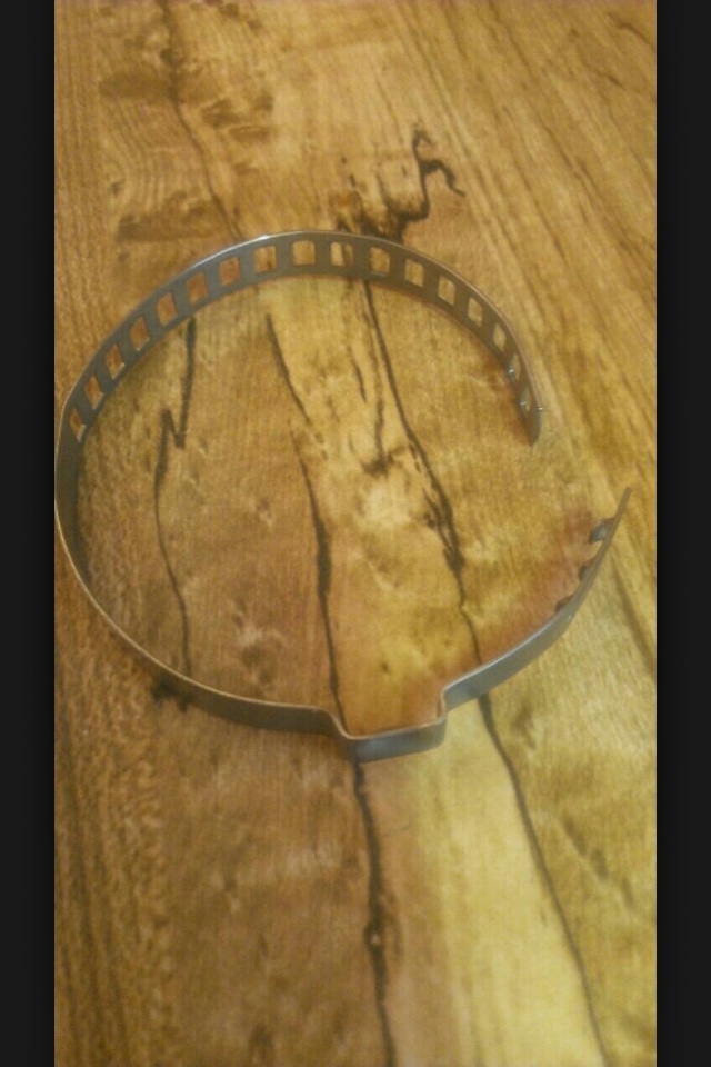

Any body used these clamps from napa?
I did for awhile when I rebooted one of my OEM axles, worked okay but was kinda annoying. As I recall I screw up the second clamp and just used a hose clamp then which is what I replace the clamps with now.
