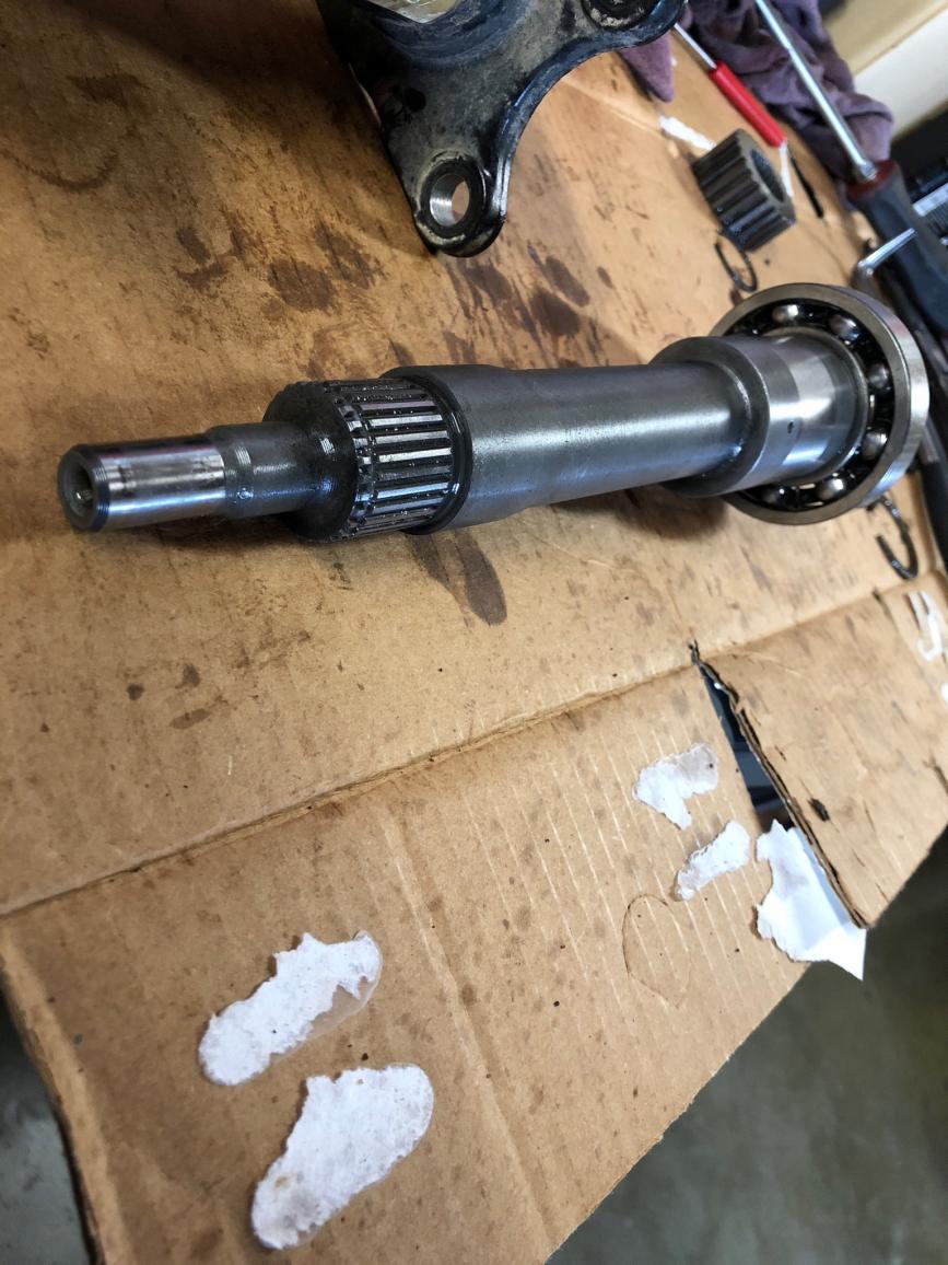

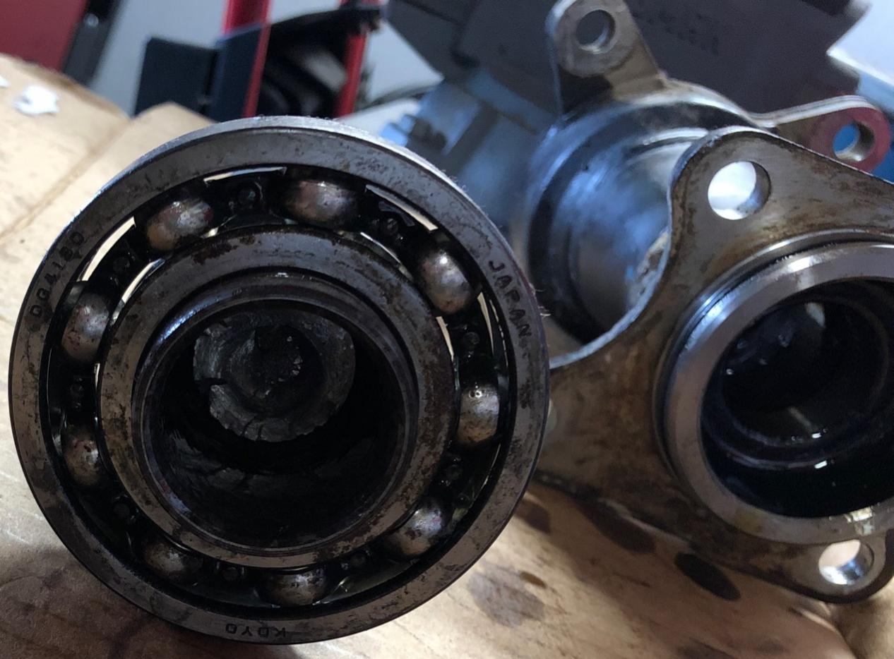

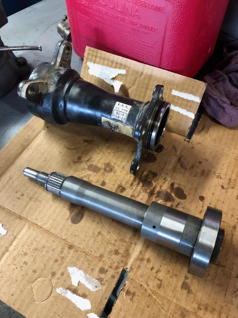

If I have to pay extra to not have to do this again then it's worth it. Nothing will get this broken shaft out. OEM axles and a new shaft with seal and bearings are going in so hopefully, this won't happen.
