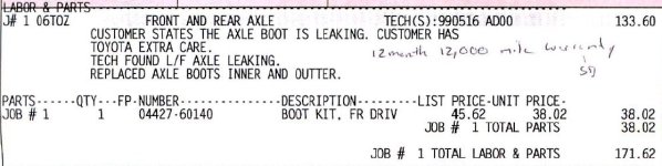

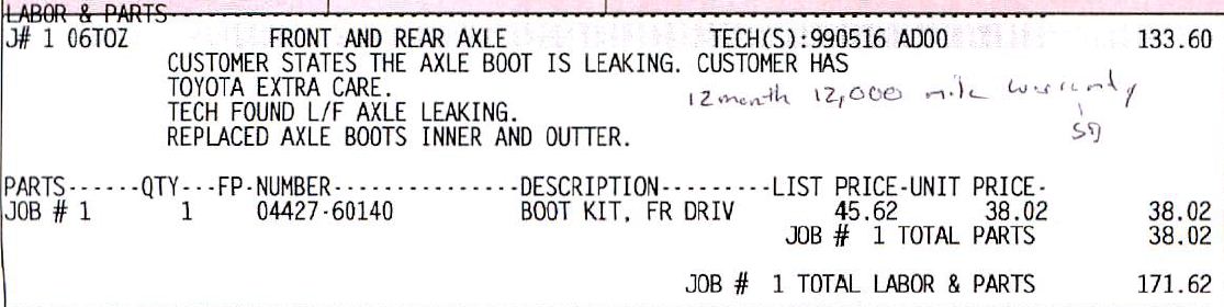

I just had the front left inner and outer boots replaced on my '04: total was $171.62, so as mentioned, about $400 if you do both half-shafts. My CV joints weren't damaged, so the boot replacement was the easy fix. At the risk of sounding like a whacko, I duct taped the boots and refilled them with grease until I could get the boots fixed. You can also buy two piece boots that don't require removal of the half-shaft, but I don't believe they are very durable. Also, the dealer included a 12mo./12k mile warranty on the boots, perhaps you could inquire about that too.
