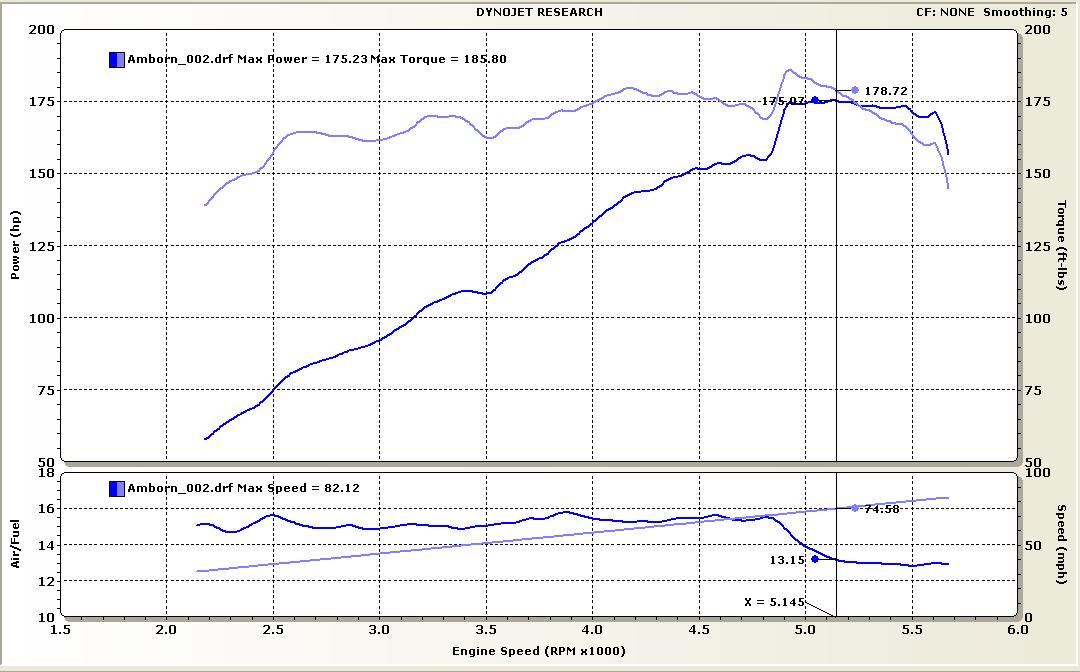

This turbo wouldn't be the best, the compressor housing is too big so it's actually gonna have quite a bit of lag. Realistically you're good for about 5PSI on a fully stock untuned 3RZ, which can be achieved with a smaller T25, T3/T4 or TD04 turbo that would have virtually no lag. It's been shown to push right around 175WHP at 5PSI, which isn't bad probably a 35-40Hp gain, but I'm shooting for something around 8-9PSI and looking to crest 200WHP with 35's, and eventually I'll build up a turbo motor and push 15-20PSI to it, and see what it can really do.
Here's a chart from the local company KORacing, this is a stock ECU 2RZ powered taco with their bolt on 5 psi turbo kit.
